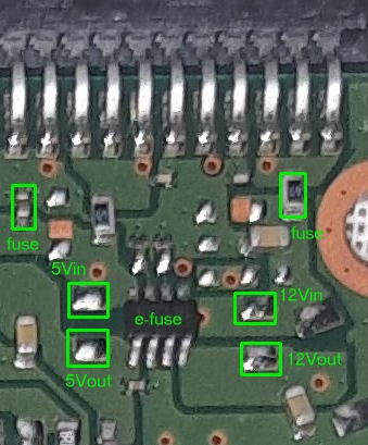

 Post subject: Re: Wd40edaz-11u78b0 Not Spinning
PostPosted: February 7th, 2024, 12:31
Posts: 17342

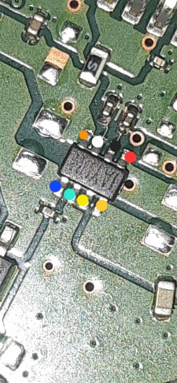

Check the fuses (marked with "s"). Also measure the voltages at the inputs and outputs of the "AYUN" e-fuse.
MP5094, Monolithic Power, dual channel 5V/12V current limit switch, marking AYUy, TSOT23-8:
https://www.monolithicpower.com/en/documentview/productdocument/index/version/2/document_type/Datasheet/lang/en/sku/MP5094/document_id/4894/

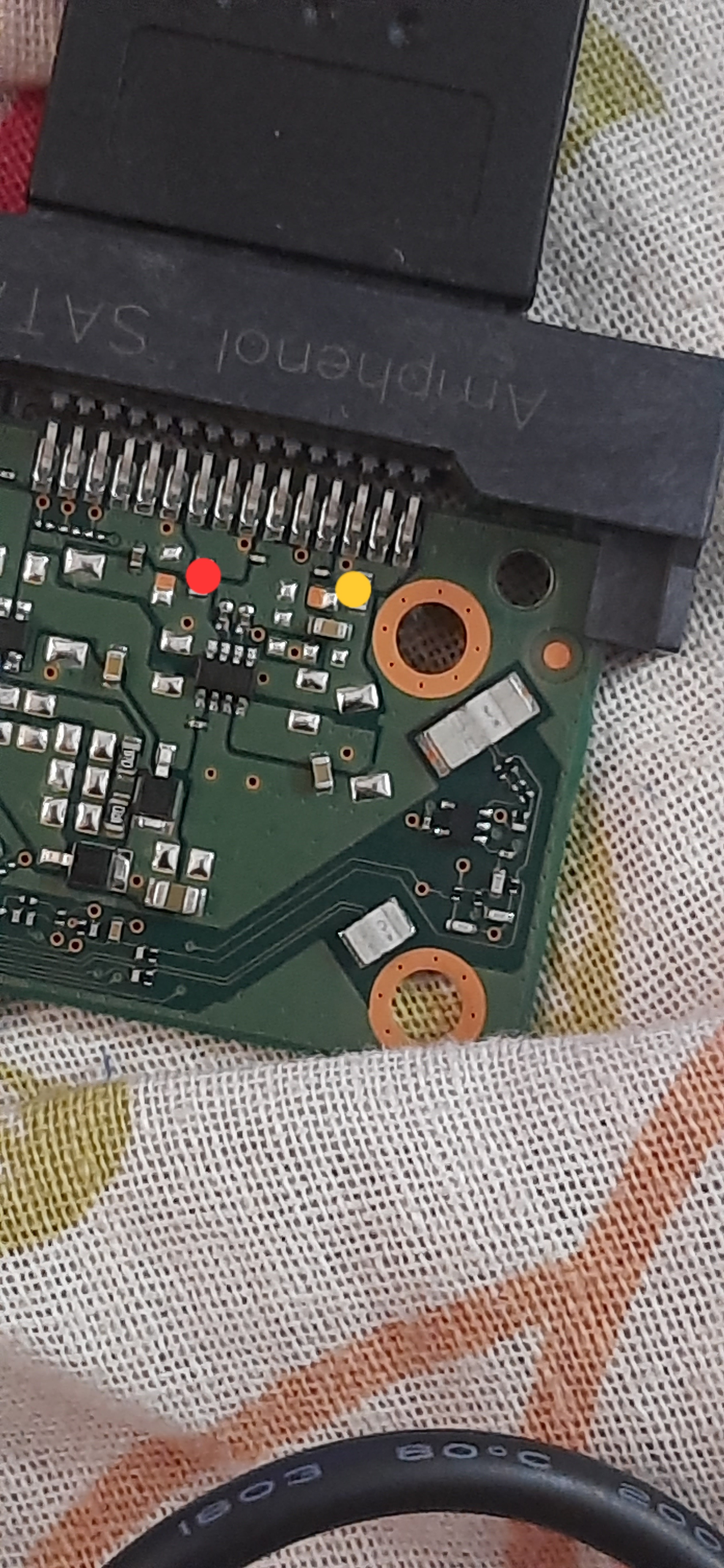

Posts: 165
Location: Chennai
Colors in the picture are legend
Dark Blue .84v
Light Blue -0.00
Yellow .70v
Dark Yellow .73v
Orange 5.20v
White .62v
Black .95v
Red 12.04v

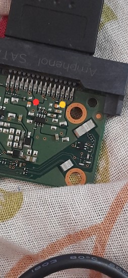

PostPosted: February 8th, 2024, 2:59
Joined: January 16th, 2024, 6:53
Posts: 165
Location: Chennai

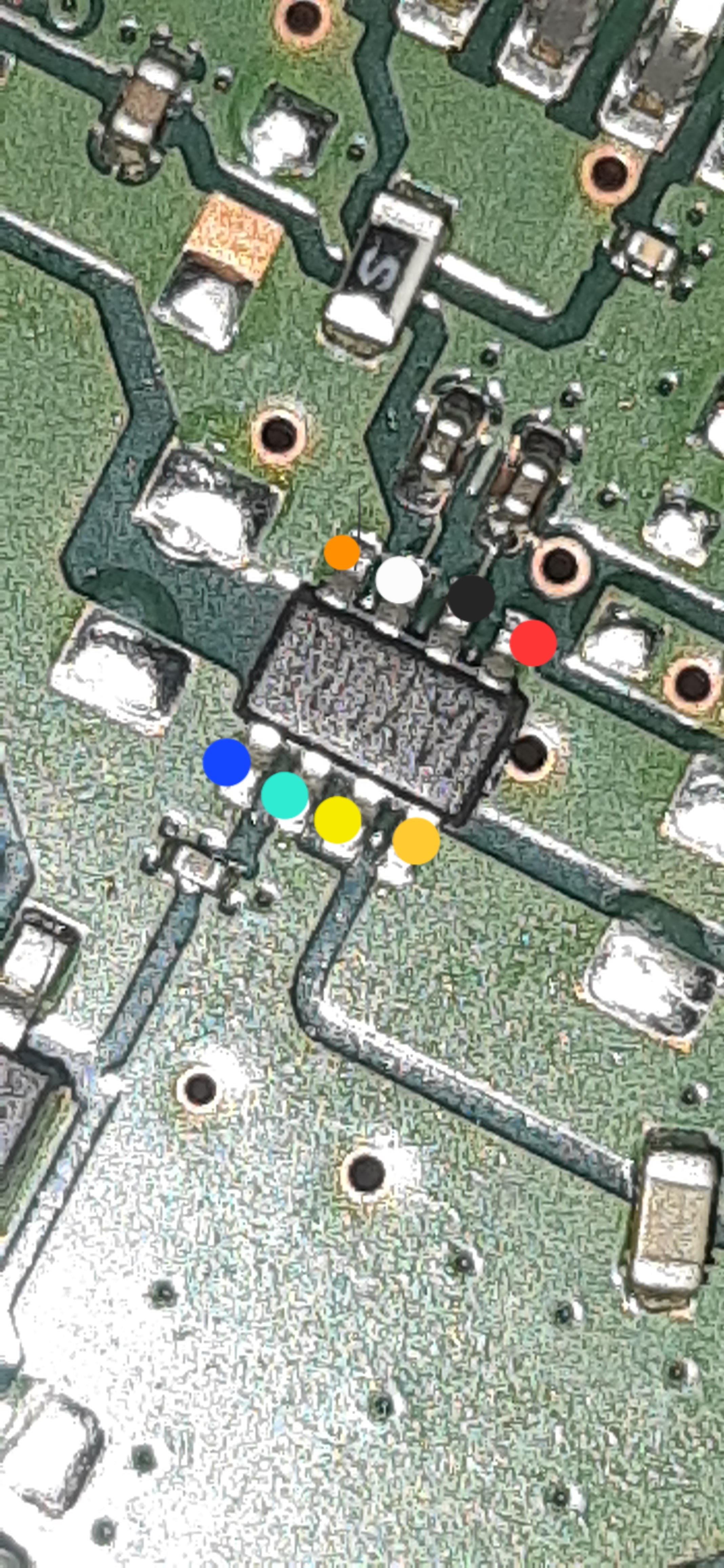

With Power
Red 5.20v
Yellow 12.04v
Without Power
Buzzer buzzes on both fuses marked with 's'

PostPosted: February 8th, 2024, 4:24
Posts: 17342
It appears that both sides of the e-fuse are open-circuit. That's unusual.
Can you measure the resistance between ground and each of the dark blue and dark yellow pins (with power off)? I'm just trying to confirm that the outputs are not being overloaded by problems downstream.

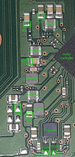

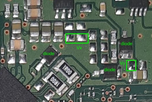

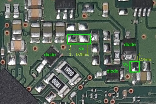

PostPosted: February 9th, 2024, 13:01
Posts: 17342

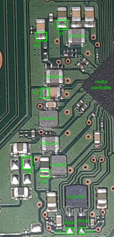

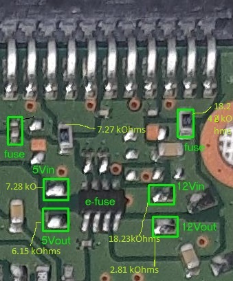

M041633n wrote:
Yes Customer told it was fallen
I don't understand why that would have caused an electronic fault. In any case, the HDD would most likely have an additional internal fault.
Measure the resistances between ground and each of the marked test points.
If the resistances are OK, then you should be able to safely bridge 5Vin to 5Vout, and 12Vin to 12Vout. However, I would be very wary of doing this in your case because your story doesn't make sense.

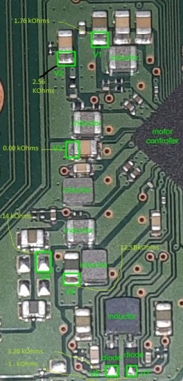

PostPosted: February 15th, 2024, 10:33
Posts: 165
Location: Chennai

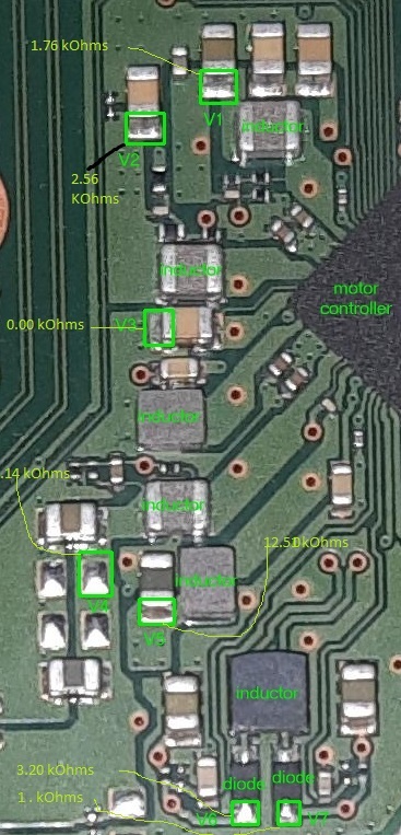

Sorry for the delay! Here you go
PostPosted: February 15th, 2024, 14:34
Posts: 17342
I suspect that V3 might be grounded. If so, then this area is probably the negative supply for the preamp.
Otherwise everything looks OK. I would bridge 5Vin to 5Vout and 12Vin to 12Vout. This will bypass both sides of the e-fuse.
