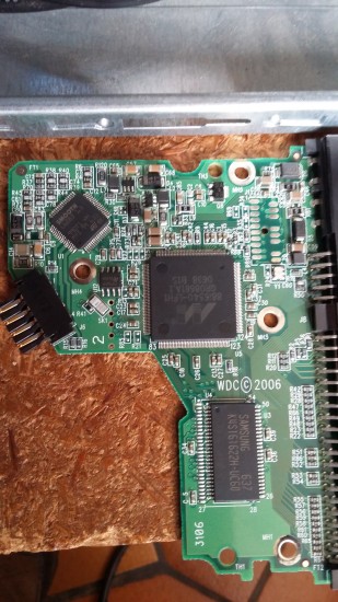

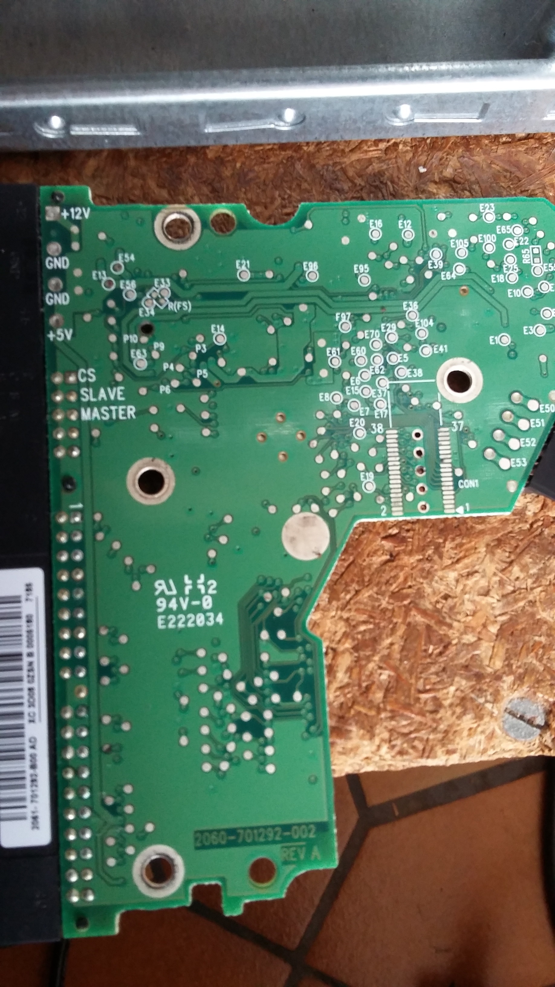

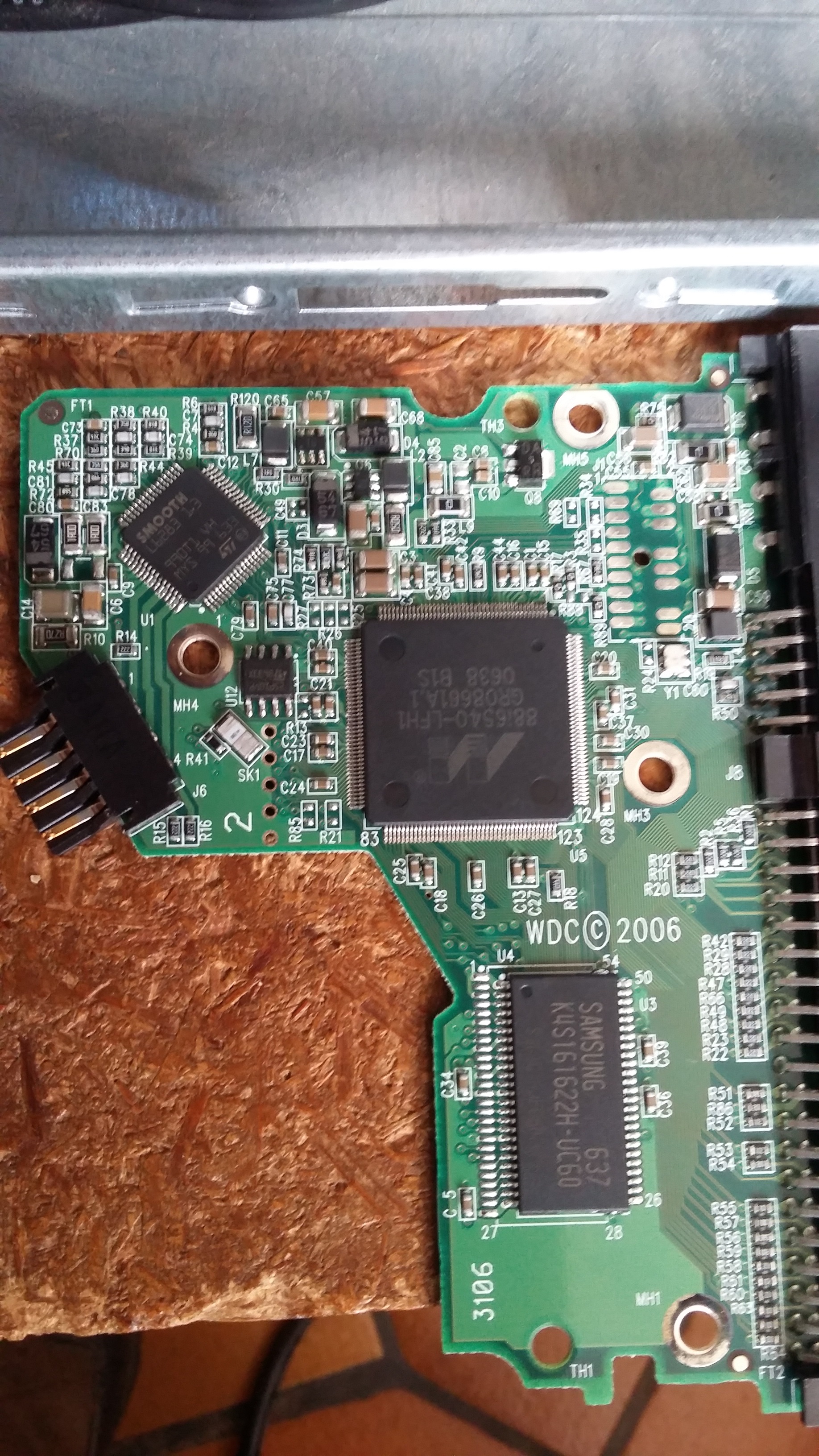

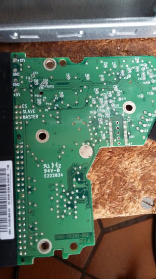

Show us a detailed photo of the PCB.

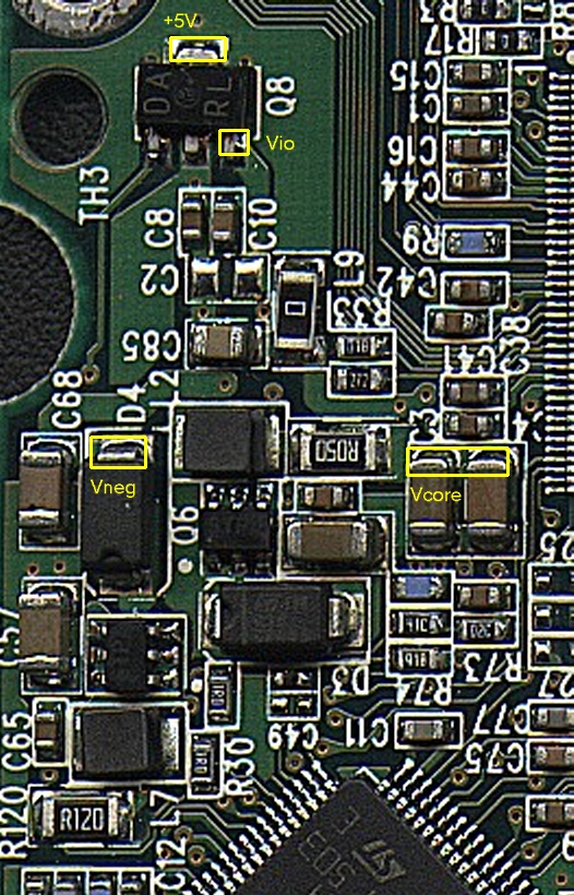

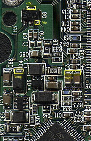

 Post subject: Re: wd2500bb-55rda0 caviar ide interface removable disk no d
PostPosted: May 22nd, 2024, 14:53
Posts: 17342
Measure the Vio, Vcore and Vneg voltages. Use any screw hole as your ground reference.
Vneg may only be present for a short time after power-on.
PostPosted: May 22nd, 2024, 15:01
Joined: March 9th, 2024, 12:00
Posts: 20
Location: France
here are the photos

With only the supply connections (12, 5v) and without any load (the ide-usb adapter not connected) i made the measures that you recommend me and here are the results:
vio: 3,23v
vneg:-5,23v
vcore:1,37v
if you want i can connect the adapter and switch on it.
i have just made the measures in this last case with the same results.
(therefore it seems i noticed one thing on my adapter : the two lights (red, blue) were lighted , i didn't notice that before).
Hoping that you could give me useful recommendations, thank you for all.
jeanluc.ferré
PostPosted: May 23rd, 2024, 11:01
Posts: 17342
I think those voltages are OK. I don't know what the Vcore was for that era, but 1.37V should be in the right range. I think your drive has an internal fault.
