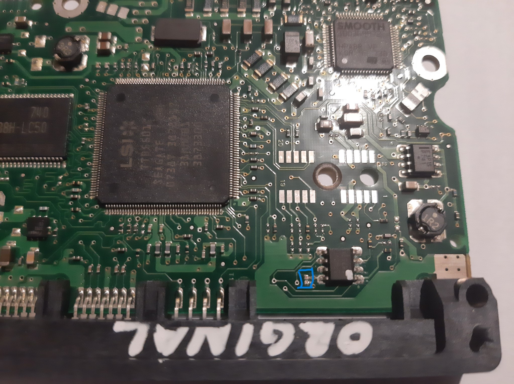

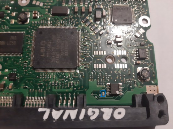

I have a kind of similar situation.
It is about Seagate ST3500320AS disk with firmware SD04 not seen by the bios or windows all the time until it was not recognized at all.
The disk was spinning fine, no funny clicks or something. I presumed the PCB is dead. I got new PCB. I tried it without changing the bios and disk is recognized again only parameters are not correct.
Then with use of the ch341 programmator I swapped bios from original PCB to donor, everything went well. Now I have two PCBs that don't even spin up the disk. Then I've read somewhere that this ch342 programmator does not use correct voltage for signal, so I thought I've burned PCBs.
Then I got a new (second donor) PCB, check it with the disk without changing the bios and the disk spins fine. This time I've swapped the bios with soldering and again afterward the disk does not spin.
Now I am about to get another PCB.
Could somebody point me in the right direction, what I am doing wrong here?
I did save the data from this disk at the beginning of failing of the disk, but the problem is that the disk where data was saved to is dead - making scratching noise and I think it would be very hard to get anything from it. I have more chance to get data from original disk.

On original PCB all I did was dumping rom with flash tool CH341 and now is dead.
On donor1 I flashed rom with original rom and now is dead.
I solder rom from donor1 to donor2 and donor2 is dead.
I solder back original rom from donor2 to donor2 and the donor2 is still dead.
Is it possible that something is wrong with my PSU? Other drives are working fine.

I wanted to revert donor2 PCB with soldering back on the original donor2 rom, but the PCB is still not working.
Looks that I am burning these PCBs somehow.
Re: SEAGATE ST3500320AS
January 9th, 2025, 14:46
@Piper, your patient ROM had a strange checksum error, but your donor ROMs are OK. Can you upload photos of your no-spin PCBs?
January 9th, 2025, 15:21
I did notice that on patient PCB a small resistor is missing left from the bios chip.
All I can think of is that maybe I did break away this resistor with clamp for flashing bios.

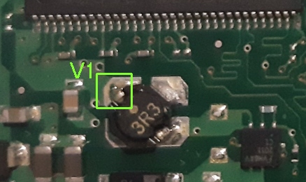

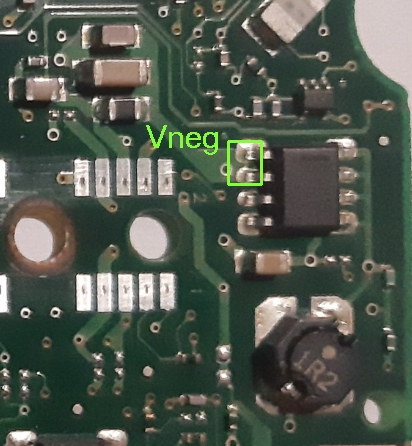

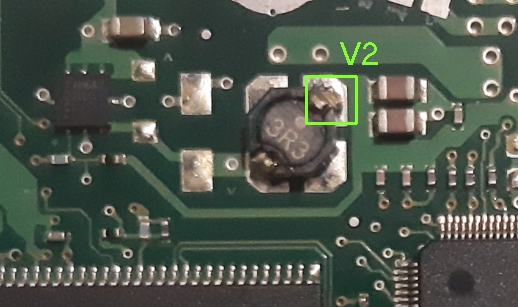

January 9th, 2025, 15:47
Measure the resistance between ground (any screw hole) and each of V1, V2, V3. If there are no shorts, measure the voltages at those same points. However, before powering up the PCB, measure the SATA +5V and +12V outputs from your PSU.
As for the missing resistor, it appears to be the pullup resistor for one of the other pins, possibly /HOLD, /WP or /CS. If the /HOLD pin is floating at a low level, then this would prevent the ROM from being read. I think something like 4K7 should suffice.

PSU 5,13V and 12,08V
PATIENT
V1 2.59V 0.863kOhm
V2 1.126V 71.8 Ohm
V3 or Vneg 0V 11.43 kOhm
DONOR
V1 2.61V 0.856kOhm
V2 1.14V 49.8 Ohm
V3 or Vneg 0V 9.28 kOhm
January 9th, 2025, 16:35
Vneg should be -5V when the drive is spinning, so that result is inconclusive. The other voltages (Vcore and Vio) are OK. I don't know what else you could do with a multimeter.
You could measure the Vcc pin of the ROM ...
January 9th, 2025, 17:20
it wasn't a CS error, byte at offset 1 was read bad, but the rest of the dump appeared to be fine. The above correction did the job.
the missing part is a bypass capacitor, likely not causing any issue if missing.

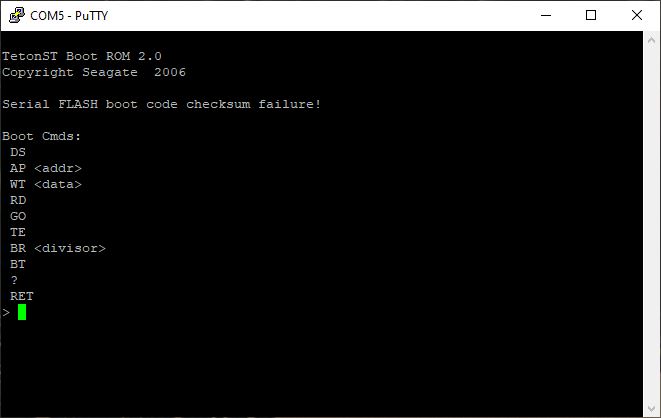

January 15th, 2025, 14:15
Little update

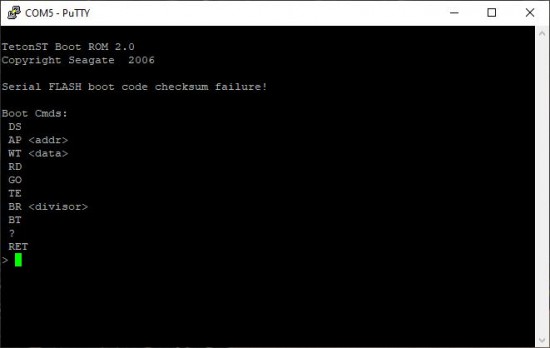

I've managed to communicate with the drive with my cable.
1. Original PCB; as you figured it out the rom is corrupt, so drive does not spin

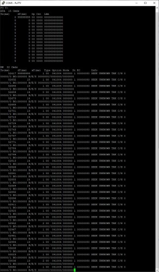

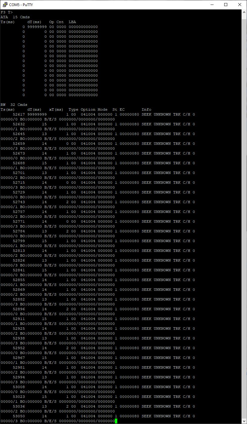

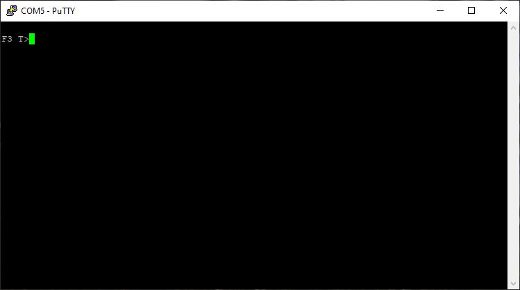

2. Donor PCB; I have managed to flash rom with corrected version, drive spins. If I connect it to sata, drive is not visible in BIOS nor windows. Windows works very slow.
On terminal when drive starts, there is no information (no copyright, no nothing like on working drive). After a while with ctrl Z I get F3 T> prompt

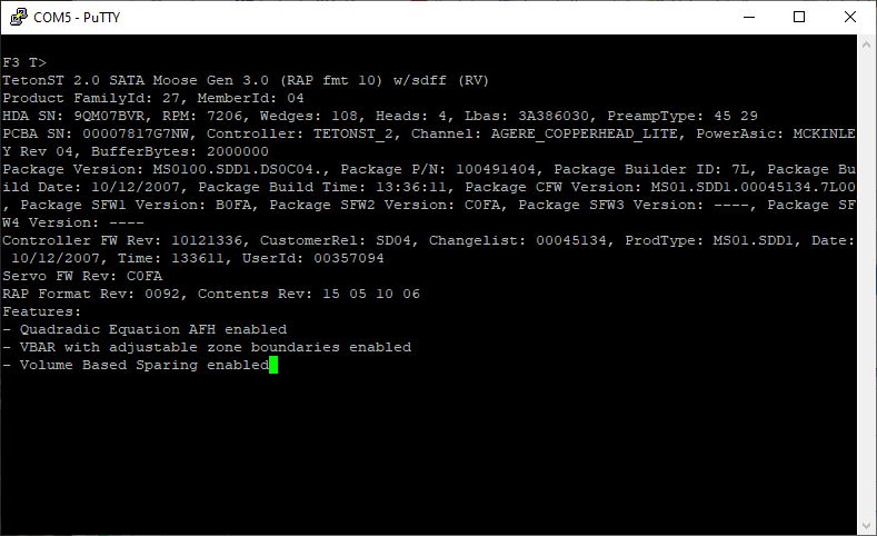

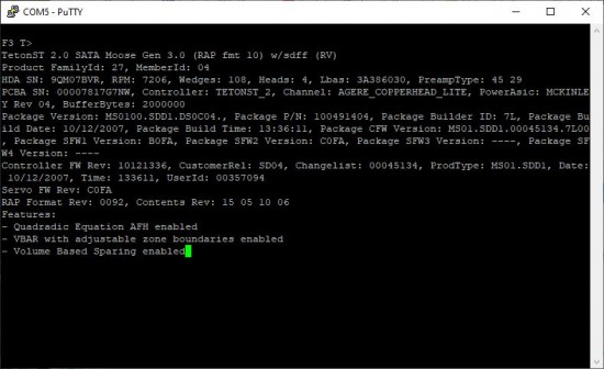

With ctrl l I get following info
With this donor pcb and corrected rom I think that the drive is behaving like before my magic interventions.
Can we make a conclusion now that the heads are guilty of this strange drive behavior?
January 15th, 2025, 16:01
it would be a lot easier to get my hands on the drive and recover it than continuing this thread and scratching my head after each post...
After powering up the ctrl-Z and ctrl-X.
Connecting the SATA of a faulty drive to Windows is a bad idea.
January 15th, 2025, 16:14
Try the "F" commands in the following ZOC script (select level T):
https://www.hddoracle.com/viewtopic.php?p=10886#p10886
Hopefully they will stabilise the drive enough so that you can clone it.
WARNING: The commands are Case Sensitive.
See this thread:
https://forum.hddguru.com/viewtopic.php?f=1&t=38411
F"READ_SPARING_ENABLED",0,22
F"WRITE_SPARING_ENABLED",0,22
F"OFFLINE_SPARING_ENABLED",0,22
F"DAR_ENABLED",0,22
F"DISABLE_IDLE_ACTIVITY",1,22
F"BGMS_DISABLE_DATA_REFRESH",1,22
F"ABORT_PREFETCH",1,22
F"READ_LOOKAHEAD_DISABLED_ON_POWER_UP",1,22
F"READ_CACHING_DISABLED_ON_POWER_UP",1,22
