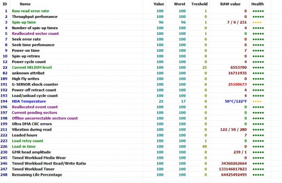

Just bought a NiB Easystore drive. Victoria shows its g-sensor shock counter is 12,189,886... This doesn't seem possible. It keeps going up du ring my burnin, perhaps victoria is misinterpreting the attribute?
CrystalDiskInfo and HDDScan don't show this attribute in SMART info and do not r4eturn any attributes with a value even close to this. Is there something else I can check, is this a red herring, keep it, exchange it?
At 13,631,698 now.

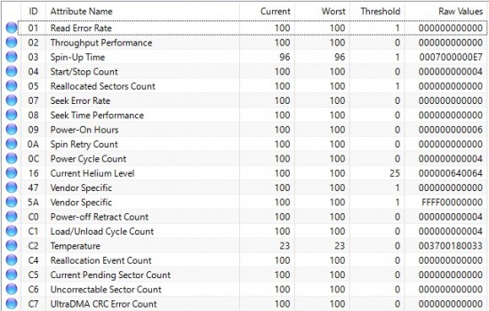

Show us CrystalDiskInfo's SMART report.
13,631,698 = 0x00D000D2 -> 0x00D0 / 0x00D2 = 208 / 210 (decimal)
The attribute is best viewed in hexadecimal. You can now see that it consists of two 16-bit values.
Crystal disk screenshot attached. Victoria shock count now at 21,627,215
 Post subject: Re: NiB Easystore drive with very high g-sensor counter valu
PostPosted: August 2nd, 2025, 19:41
Posts: 17228
21 627 215 = 0x014A014F -> 0x014A / 0x014F
I don't see this attribute in your CDI screenshot. It must be off-screen, at the bottom.
Show us your Victoria screenshot.

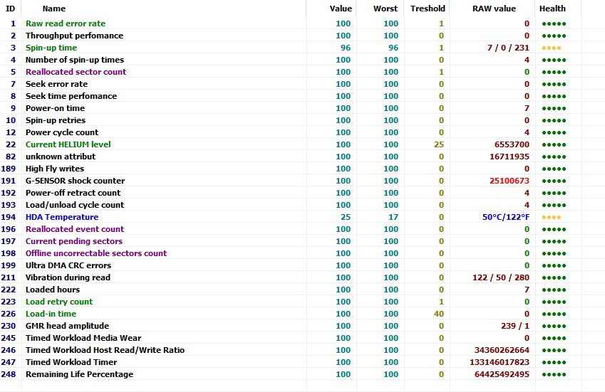

Nope, UltraDMA CRC Error Count is the last attribute listed in CrystalDiskInfo.
PostPosted: August 2nd, 2025, 23:22
Posts: 17228
It seems that CrystalDiskInfo and HDDScan may have a bug.
Victoria shows attributes 82, 189, 191. In hexadecimal these are 0x52, 0xBD, 0xBF. CrystalDiskInfo shows 0x47 and 0x5A. That's 71 and 90.
It may be that 191 is something other than a G-sensor Shock Counter. That's because there is no standard that governs the naming of SMART attributes.
These are those other attributes with large decimal values. The numbers are are a lot less scary in decimal. I doubt very much that attribute 248 is Remaining Life Percentage (0xF = 15).
    82 -- 16711935 = 0xFF00FF -> 0x00FF / 0x00FF
    246 -- 34360262664 = 0x800080008 -> 0x0008 / 0x0008 / 0x0008
    247 -- 133146017823 = 0x1F001F001F -> 0x001F / 0x001F / 0x001F
    248 -- 64425492495 = 0xF000F000F -> 0x000F / 0x000F / 0x000F
You can capture the raw SMART data with CrystalDiskInfo.
    Select Edit -> Copy Option and tick all the boxes.
    Select Edit -> Copy to copy the data to the clipboard, and then paste them into your next post (Ctrl-V). Use the "Code" bbcode to preserve formatting.
    Select Function -> Hide Serial Number if this is a problem for you.

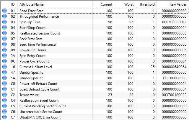

(03) WDC WD200EDGZ-11B9PA0
       Enclosure : WD easystore 264D USB Device (V=1058, P=264D, sa1)
           Model : WDC WD200EDGZ-11B9PA0
        Firmware : 85.00A85
   Serial Number : ********
       Disk Size : 20000.5 GB (8.4/137.4/20000.5/20000.5)
     Buffer Size : Unknown
     Queue Depth : 32
    # of Sectors : 39063650304
   Rotation Rate : 7200 RPM
       Interface : USB (Serial ATA)
   Major Version : ACS-5
   Minor Version : ----
   Transfer Mode : SATA/600 | SATA/600
  Power On Hours : 18 hours
  Power On Count : 4 count
     Temperature : 49 C (120 F)
   Health Status : Good
        Features : S.M.A.R.T., APM, NCQ, Streaming, GPL
       APM Level : 00FEh [OFF]
       AAM Level : ----
    Drive Letter :
-- S.M.A.R.T. --------------------------------------------------------------
ID Cur Wor Thr RawValues(6) Attribute Name
01 100 100 __1 000000000000 Read Error Rate
02 100 100 __0 000000000000 Throughput Performance
03 _96 _96 __1 0007000000E7 Spin-Up Time
04 100 100 __0 000000000004 Start/Stop Count
05 100 100 __1 000000000000 Reallocated Sectors Count
07 100 100 __0 000000000000 Seek Error Rate
08 100 100 __0 000000000000 Seek Time Performance
09 100 100 __0 000000000012 Power-On Hours
0A 100 100 __0 000000000000 Spin Retry Count
0C 100 100 __0 000000000004 Power Cycle Count
16 100 100 _25 000000640064 Current Helium Level
47 100 100 __1 000000000000 Vendor Specific
5A 100 100 __1 FFFF00000000 Vendor Specific
C0 100 100 __0 000000000005 Power-off Retract Count
C1 100 100 __0 000000000005 Load/Unload Cycle Count
C2 _26 _26 __0 003700180031 Temperature
C4 100 100 __0 000000000000 Reallocation Event Count
C5 100 100 __0 000000000000 Current Pending Sector Count
C6 100 100 __0 000000000000 Uncorrectable Sector Count
C7 100 100 __0 000000000000 UltraDMA CRC Error Count
PostPosted: August 3rd, 2025, 21:44
Posts: 17228
There is no inconsistency in the raw data. It's as if there are two different drives. :-?
PostPosted: August 3rd, 2025, 22:51
Joined: August 2nd, 2025, 17:19
Posts: 11
Location: Texas
Definitely only one HDD. The other two drives are NVME's.
Perhaps the issue is with Victoria and it is a red herring? Even if I pause the burn-in, I can wait a few seconds, re-poll SMART and see the value increase.
But it is odd that the two don't at least see the same attribute ID's?
PostPosted: August 4th, 2025, 5:19
Posts: 17228
I don't understand it. It's very strange. Do all tools report the same serial number?
PostPosted: August 4th, 2025, 6:35
Joined: May 13th, 2019, 7:50
Posts: 1199
Location: Nederland
It would help if you didn't crop the freakin screenshots.
PostPosted: August 4th, 2025, 11:53
Posts: 11
Location: Texas
Yeah, CrystalDiskInfo, Victoria and HDDScan all show the same s/n. Neither HDDScan or Crystal show this attribute, only Victoria does.
However, now that the burn-in completed. I noticed that the Victoria g-sensor shock value resets after being powered off/on, starts at 65535. Seems that Victoria is incorrectly correlating the attribute which is in-line with one of your initial thoughts. I'd expect a value like shock to persist.
PostPosted: August 4th, 2025, 12:14
Posts: 17228
65535 = 0xFFFF
That's -1, if it's a signed 16-bit number.
These are the SMART data:
Offset(h) 00 01 02 03 04 05 06 07 08 09 0A 0B
00000000  01 0B 00 64 64 00 00 00 00 00 00 00
0000000C  02 04 00 64 64 00 00 00 00 00 00 00
00000018  03 07 00 60 60 E7 00 00 00 07 00 00
00000024  04 12 00 64 64 04 00 00 00 00 00 00
00000030  05 33 00 64 64 00 00 00 00 00 00 00
0000003C  07 0A 00 64 64 00 00 00 00 00 00 00
00000048  08 04 00 64 64 00 00 00 00 00 00 00
00000054  09 12 00 64 64 12 00 00 00 00 00 00
00000060  0A 12 00 64 64 00 00 00 00 00 00 00
0000006C  0C 32 00 64 64 04 00 00 00 00 00 00
00000078  16 23 00 64 64 64 00 64 00 00 00 00
00000084  47 01 00 64 64 00 00 00 00 00 00 00
00000090  5A 31 00 64 64 00 00 00 00 FF FF 00
0000009C  C0 32 00 64 64 05 00 00 00 00 00 00
000000A8  C1 12 00 64 64 05 00 00 00 00 00 00
000000B4  C2 02 00 1A 1A 31 00 18 00 37 00 00
000000C0  C4 32 00 64 64 00 00 00 00 00 00 00
000000CC  C5 22 00 64 64 00 00 00 00 00 00 00

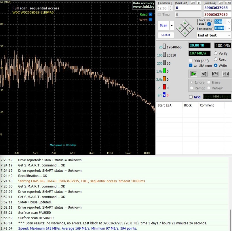

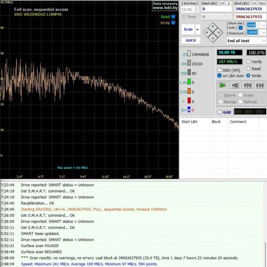

Besides this red herring sending us down a rabbit hole... I think the drive is good.
All the results I found for SMART attributes with a default value of 65535 seem to be incorrect as well (Reallocation event count, offline uncorrectable sector count, multi-zone error rate). If these were correct, I'd assume there would be error or warnings which I had 0?
PostPosted: August 4th, 2025, 12:25
Posts: 17228
"SMART status = Unknown"
I suppose that's because the drive is in a USB enclosure.
