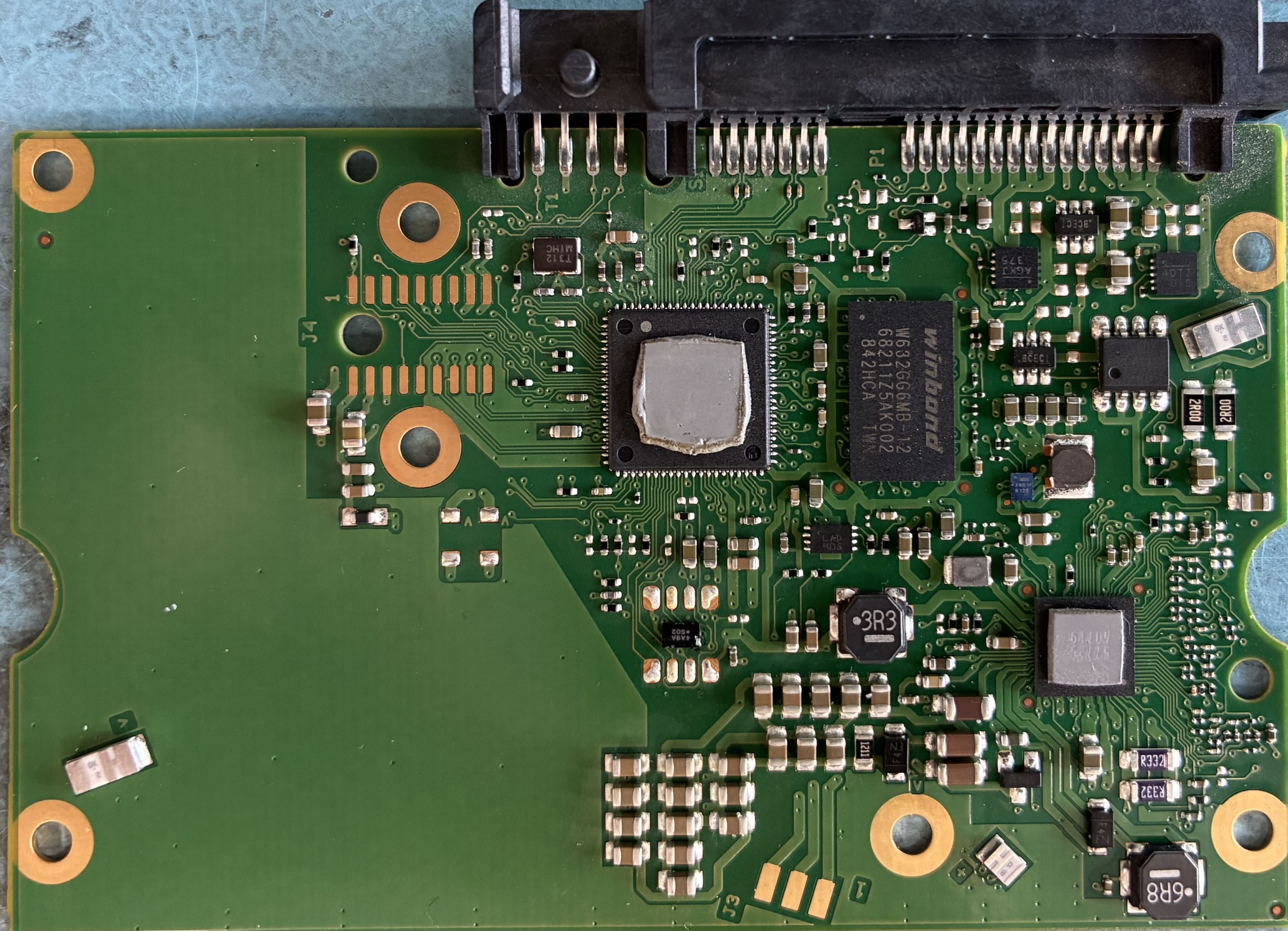

I got a ST4000NM0165 HP branded (Makara Plus) with a defective board.
I found same PCB code 100760706 on ST4000NM0035 ( Seagate branded ). I tried to swap the ROM chip, but the drive shows LED:0x000000BB and no spin on.
I tried to load original board firmware and import adaptives from customer ROM, drives spins but shows Disc FW failed to load error.
I have no error in the log of PC3K when I load the rom file, so I assume that the ROM file is not corrupted. I also tried to open the ROM with F3RomExplorer and seems to be good
Do you have some suggestions?

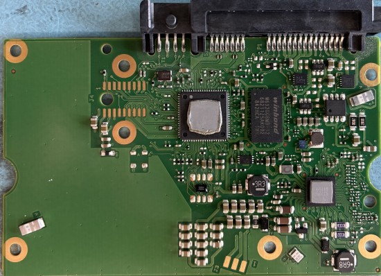

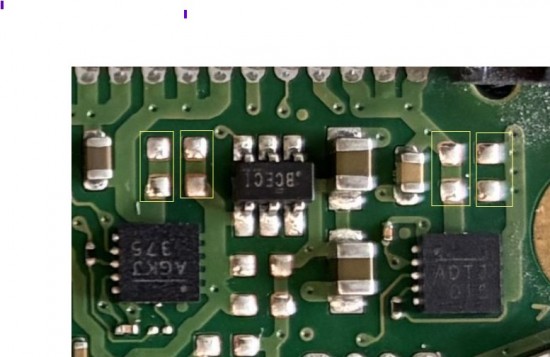

Your PCB has two e-fuses. Can you upload a photo? If the fault is confined to these fuses, the repair should cost you nothing.
https://www.hddzone.com/images/100760706.jpg
 Post subject: Re: ST4000NM0165 ROM problem
PostPosted: August 14th, 2025, 5:14
Joined: September 9th, 2020, 8:51
Posts: 44

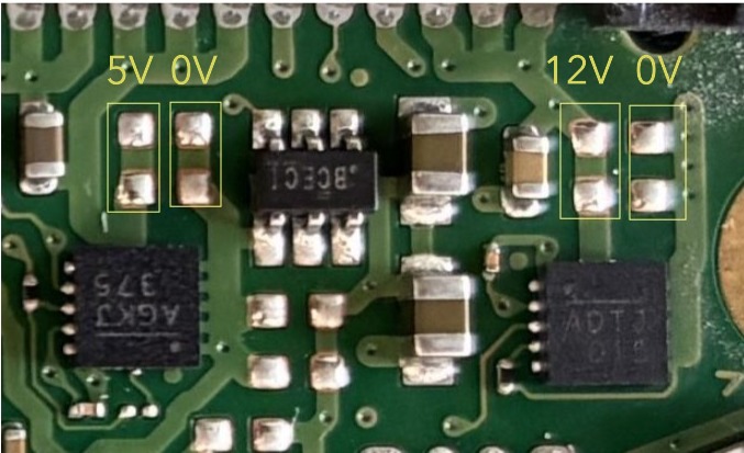

This is my PCB:
PostPosted: August 14th, 2025, 6:24
Posts: 17228

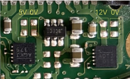

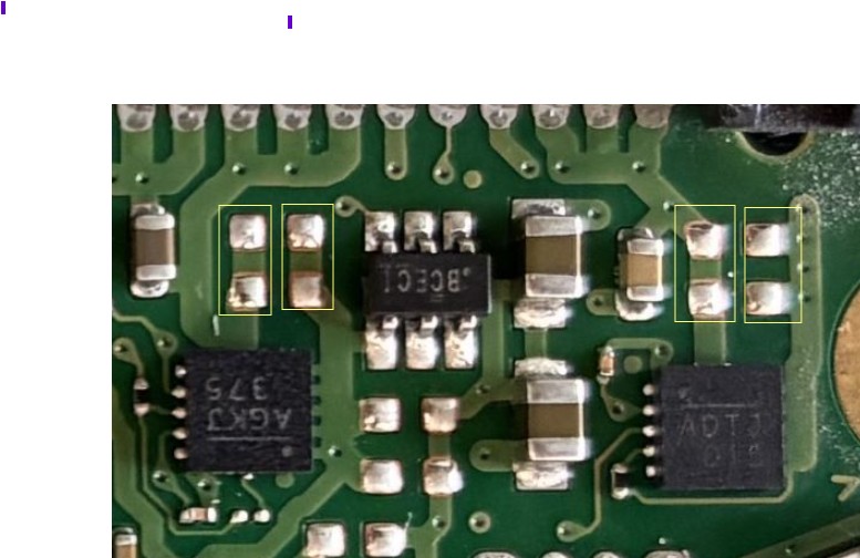

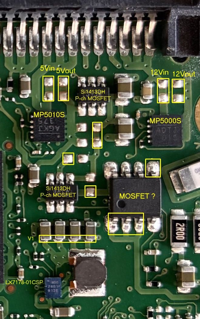

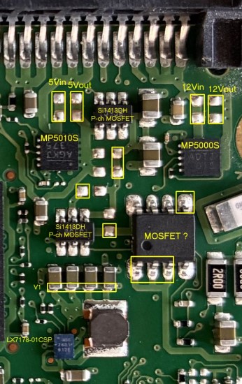

MP5000S, Monolithic Power, 12V, 1A - 5A Programmable Current Limit Switch, marking ADT, QFN10:
https://www.monolithicpower.com/en/documentview/productdocument/index/version/2/document_type/Datasheet/lang/en/sku/MP5000S/document_id/1651/
MP5010S, Monolithic Power, 5V, 1A - 5A Programmable Current Limit Switch, marking AGK, QFN10:
https://www.monolithicpower.com/en/documentview/productdocument/index/version/2/document_type/Datasheet/lang/en/sku/MP5010S/document_id/1673/
Measure the input and output voltages of each device.
PostPosted: August 14th, 2025, 7:16
Posts: 44

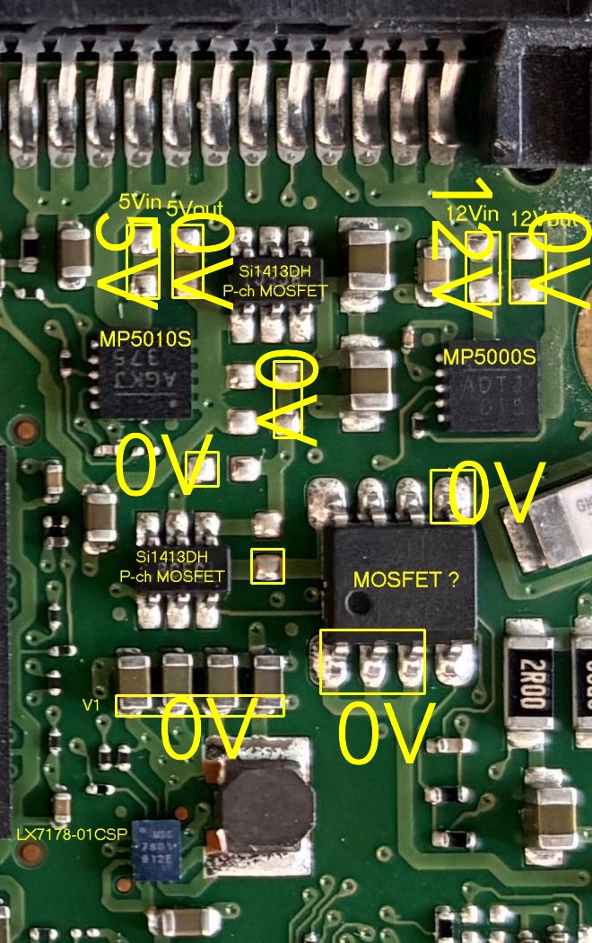

Here the results..
PostPosted: August 14th, 2025, 13:37
Posts: 17228
Are the outputs shorted to ground?
Are the 3.3V SATA power pins all at 0V?
Are the Enable pins of each fuse at a high logic level?
PostPosted: August 18th, 2025, 7:07
Posts: 44
here the results:
Are the outputs shorted to ground? NO
Are the 3.3V SATA power pins all at 0V? Yes, all 3.3V sata power pins are to 0V
Are the Enable pins of each fuse at a high logic level? Not at all. I have 1,3V on EN pins of both devices

The EN of the fuses is from 2.5 to 5V. I would try to supply from 5V through a 100-200 Ohm resistor to 3.3V. Or put 0 Ohm resistors in the designated places. But here fzabkar will figure it out better.
Perhaps, when you solve the power problem, the patient's board will work. :)
PostPosted: August 18th, 2025, 11:39
Posts: 17228
https://www.mouser.com/datasheet/2/949/w631gg6kb_a10-2525588.pdf (W631GG6KB, 8M x 8 BANKS x 16 BIT DDR3 SDRAM, 1Gbit)
https://pf.unikeyic.com/datasheet/4c/99/79a3/35/76fa3bb40b98e7c58dc0bccc21ac3995.pdf (W632GG6MB, 16M x 8 BANKS x 16 BIT DDR3 SDRAM, 2Gbit)
The Enable/Fault pin appears to be in a fault state.
Intermediate Level Input Voltage VI (INT) -- Thermal Fault, Output Disabled -- 0.82V (min)   1.4V (typ)  1.95V (max)
The Enable/Fault pin is a tri-state, bi-directional interface. It can be used to enable the output of the device by floating the pin, or disable the chip by pulling it to ground (using an open drain or open collector device). If a thermal fault occurs, the voltage on this pin will go to an intermediate state to signal a monitoring circuit that the device is in thermal shutdown.
Thermal protection
When thermal protection is triggered, the output is disabled and the fault line is driven to the middle level. The thermal fault condition is latched, and the part will remain latch off state until restart the power or reset the enable pin.
Enable / Fault Pin
The Enable/Fault Pin is a Bi-Directional three levels I/O with a weak pull up current (28uA typical). The three levels are low, mid and high. It functions to enable/disable the part and to relay Fault information.
Enable/Fault pin as an input:
1. Low and mid disable the part.
2. Low, in addition to disabling the part, clears the fault flag.
3. High enables the part (if the fault flag is clear).
Enable/Fault pin as an output:
1. The pull up current may (if not over ridden) allow a “wired nor” pull up to enable the part.
2. An under voltage will cause a low on the Enable/Fault pin, and will clear the fault flag.
3. A thermal fault will cause a mid level on the Enable/Fault pin, and will set the fault flag.
ISTM that both e-fuses have latched off. The only component that is connected to both the 5V and the 12V supplies is the motor controller.

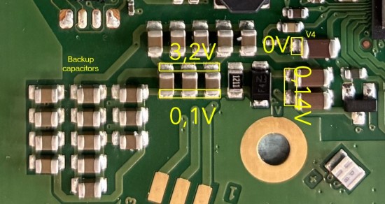

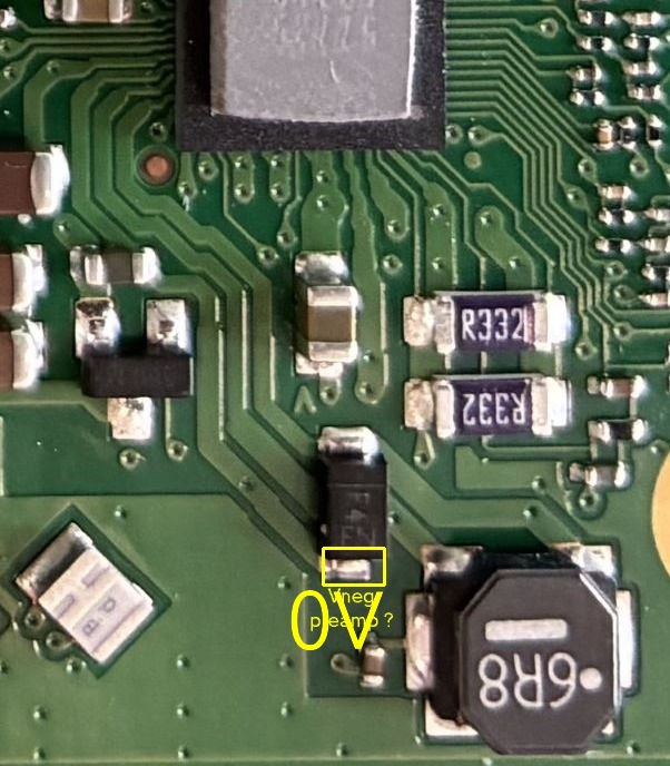

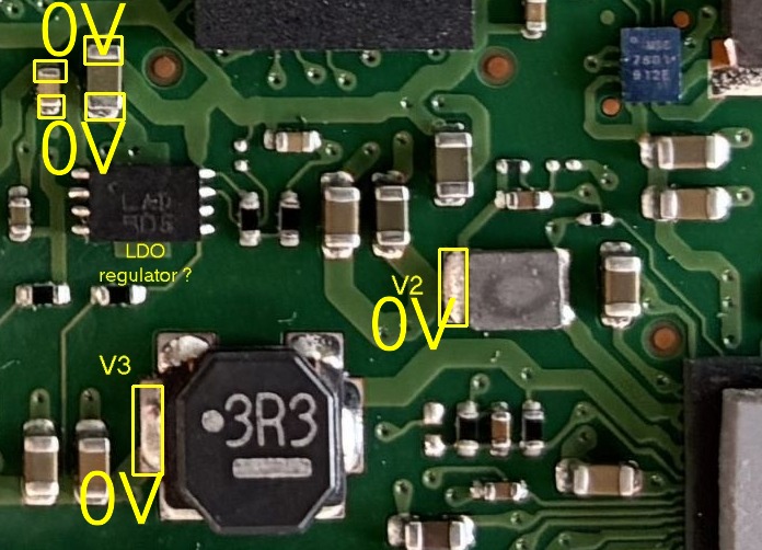

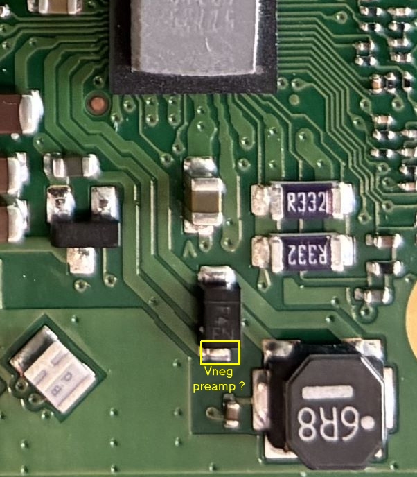

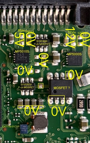

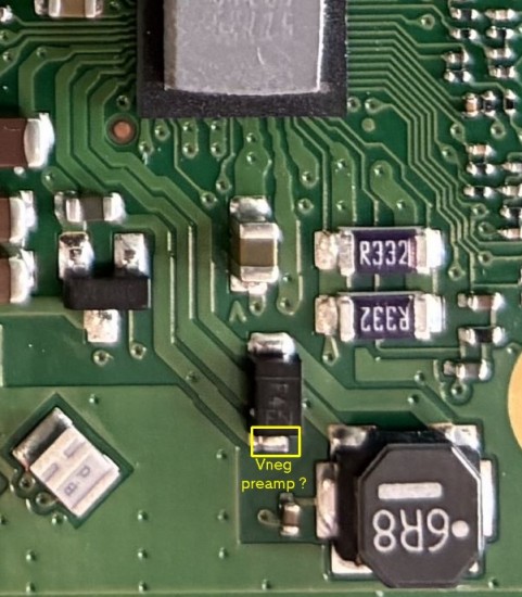

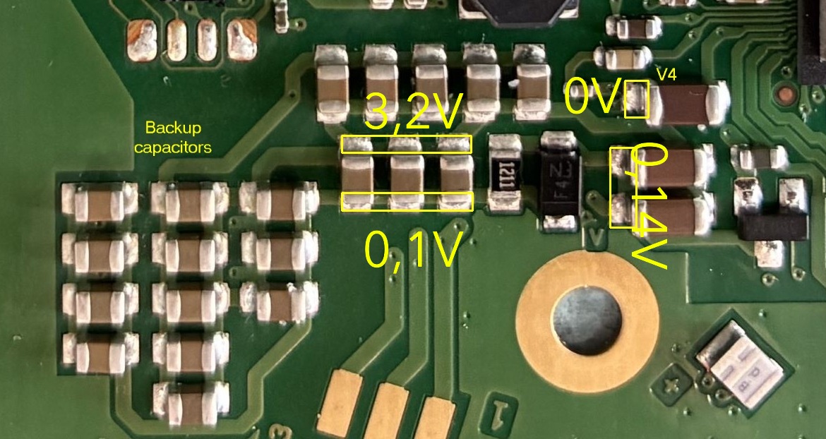

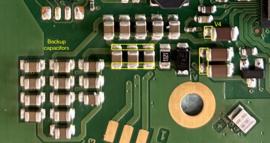

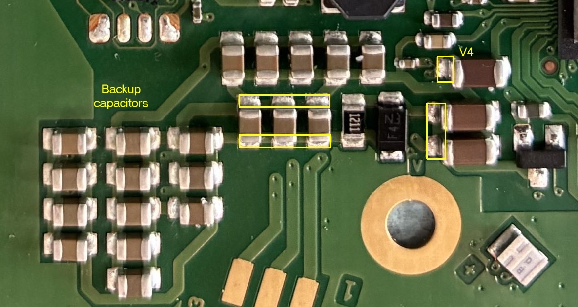

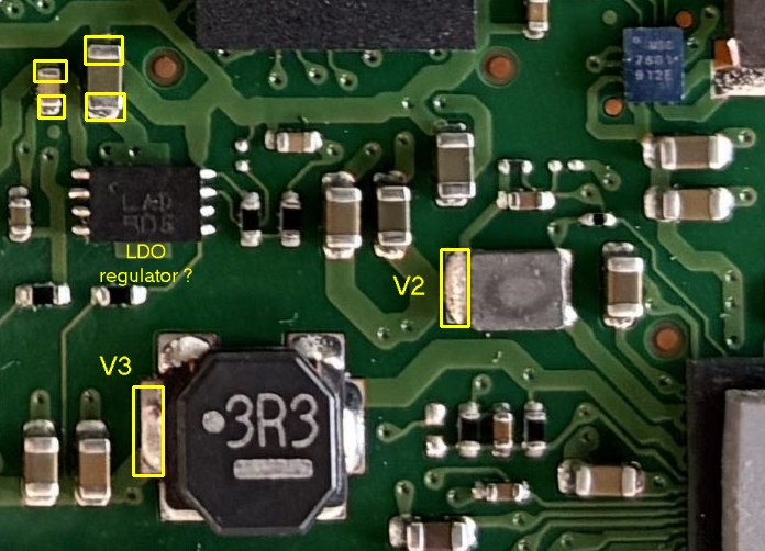

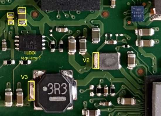

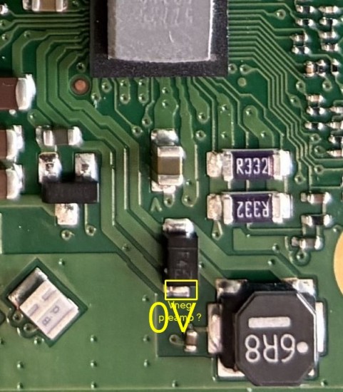

Before bypassing the e-fuses, you might like to test the resistances between ground and each of the voltage test points. I haven't labelled many of them because I don't know their function.
Si1413DH, Vishay, MOSFET, P-ch, -20V, -2.3A, 1.8V rated, marking BCxxy, SOT-363:
https://www.vishay.com/doc?71878
W25Q16JWBYIM, Winbond, 16Mbit serial flash, 1.8V, Quad SPI, marking 4Ayw + JIM, WLCSP-8:
https://www.mouser.com/datasheet/2/949/W25Q16JW_RevD_01152020_Plus-1760324.pdf
LX7178-01CSP, Microsemi, Constant Frequency Hysteretic Synchronous Buck Regulator with I2C, 3V - 5.5Vin, 5A, 1.875 MHz, marking 7801, WLCSP-20:
https://ww1.microchip.com/downloads/en/DeviceDoc/lx7178_rev1.1.pdf

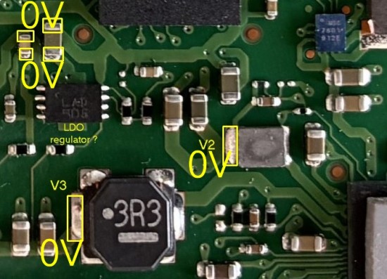

Hi, thanks a lot for your reply.
Below the results.
I noticed the backup caps start at 3,2V then discharge to 0. In the working PCB stay fixed to 12V.
PostPosted: August 19th, 2025, 6:26
Posts: 17228
I didn't expect that you would find any voltages. Instead, I was expecting you to measure resistances.
Both e-fuses have latched into a fault state and switched off their outputs. This suggests that there are shorts downstream. There appear to be two MOSFETs between the e-fuses and the motor controller, so I was wondering if there was a short after the MOSFETs.
