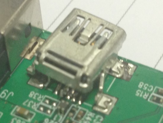

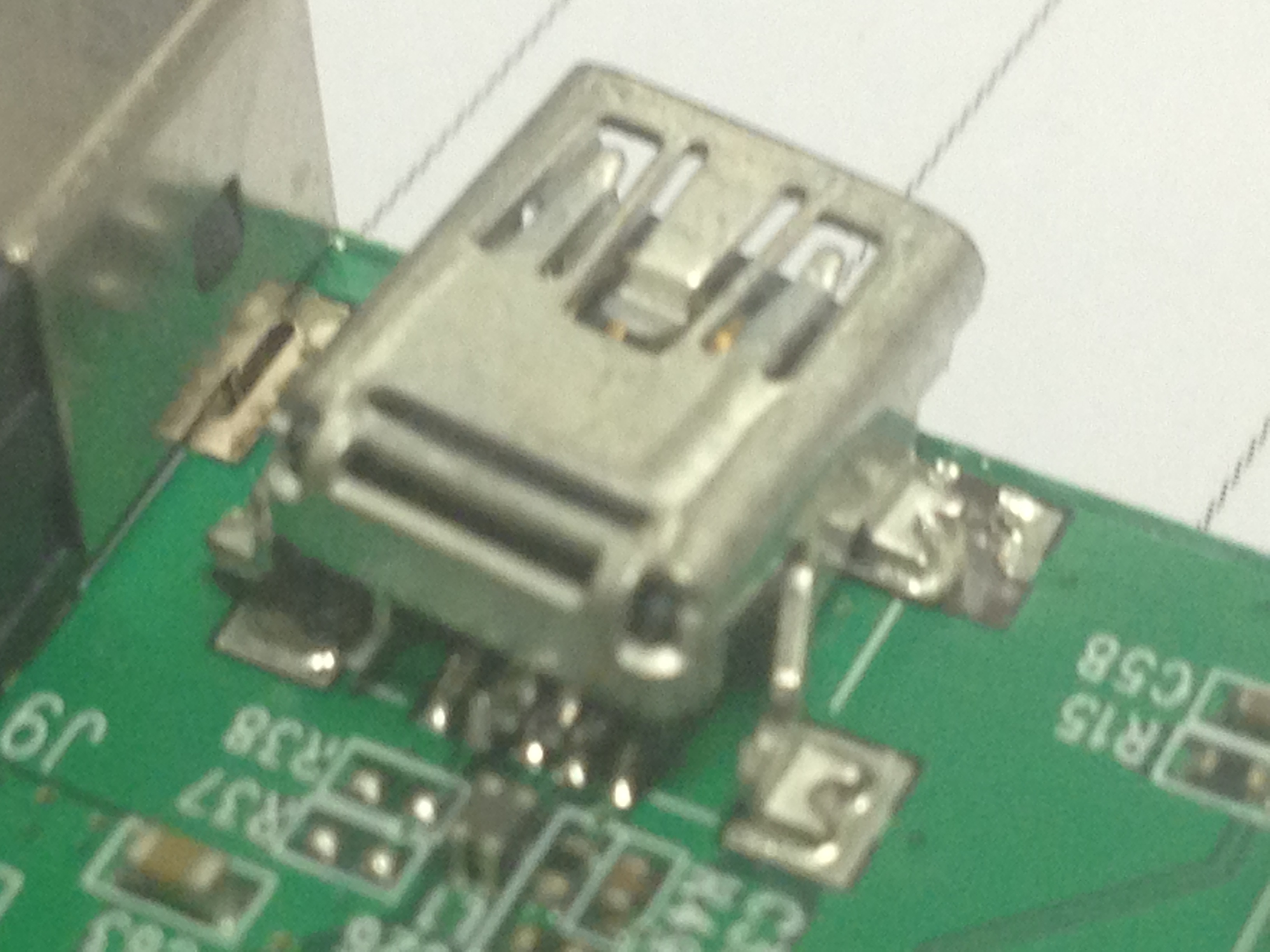

What a nightmare these drives are when the usb breaks hey?! Anyway i've taken a minimal risk and purchased a PCB from ebay today and will wait the 5-15 working days for it to be shipped from Hong Kong. My exact board is listed on the Sellers store: ecpart888 - i spent time going through all the different boards they have listed there as a lot of them appear nearly the same to the naked eye, yet the small revisions in the version numbers may make a difference. So here's hoping. $24 including postage seems a small price to pay (ultra cheap in my opinion) if this brings the drive back to life because of the encryption scenario. My drive is working, it was purely my careless handling of it when i transported it from home to a friends house one day. The USB port is slightly ajar from the board itself and i just havent been able to find a local electronics repair guru to do it for me. Ive left a pic of the issue for the moment and ill report back the findings when the new board arrives and i try to fit it, hopefully with full success. Cheers for now.
File comment: broken usb on WD My Book 1.5tb drive

Aussie Girl wrote:
Hey guys, I had the same problem with my USB connector breaking off and I was unable to access 1TB of data off my WD My Book 1TB. I have got it working so wanted to let you all know, as I have read all of these forums looking for advice.
First I tried putting the hard drive into an external case - the drive was not accessible and did not work.
Then I tried accessing the data through a recovery program, which was able to see the drive and data - however after 10 hours of reading it - it was encrypted.
Finally I went and bought a new mini USB connector for $1.95 from Altronics in Australia and then went to a local electronics repairer who charged me $40 and was able to solder it on. He told me it is extremely common and they break all the time.
I want to upload a photo of the soldered circuit board, because I had looked everywhere for one. But I have no idea how to do that on here? Anyway the guy did a great job and I can access all the data! I learnt a big lesson having 71,000 photos stored solely on my hard drive!
Hope this helps... If anyone wants to see how it was soldered let me know and I'll send you the pic!
Even though this post is 2 years ago I hope I will have some confirmation from someone. I faced the same problem as the quoted post, and I assume the mini USB connector that she bought to solder on her hard disk is this one? http://www.altronics.com.au/index.asp?a ... m&id=P1308 (same price $1.95and from same website)
If it is I'm gonna try my luck and find some electrical repairman to help solder it for me.

hi evo007,
Looks like my problem is exactly the same as yours, and I also just purchased the same PCB from the same seller! Have you got yours yet? Recovered your data? Fingers crossed...
Cheers

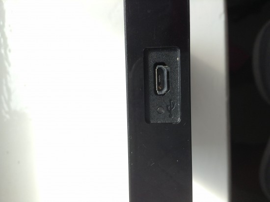

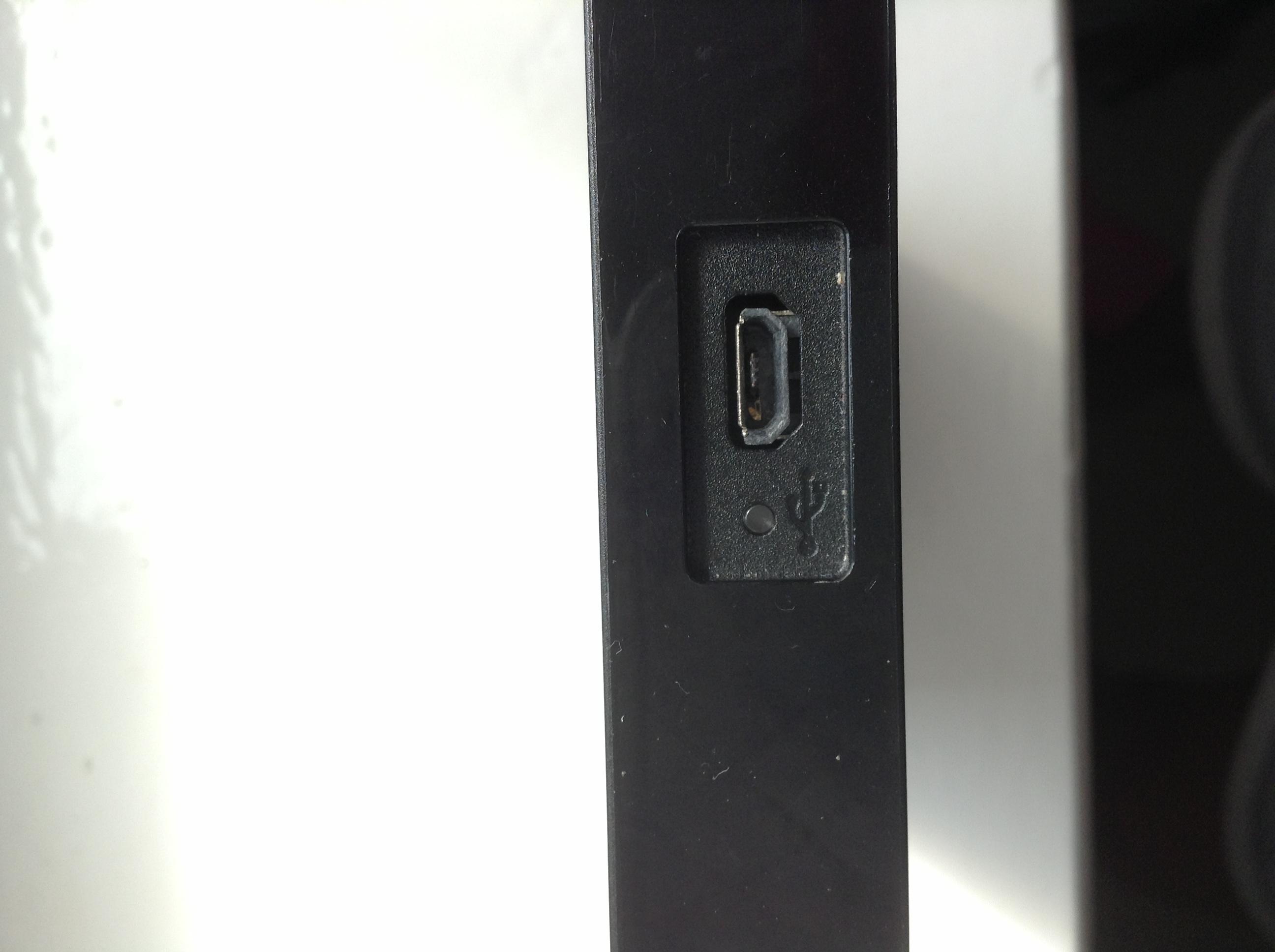

Hello everyone.
I'm new to this site/forum but I just need some help. I have a wd elements portable SE, and my connection port is broken. If ou can see from my picture, one of the pins have disappeared :( I believe this is because it was because the hard drive was knocked off he table and was pulled from the cable. Anyway when connection to my laptop, it is not connectable.
I have seeked a friend who does data recoveries, but he had informed it wasn't fixable due to the connection port being soldered on to the hard drive inside. Apparently with other portable hard drives, the hard drive can be put into a new case, but as the connection port is soldered onto the hard drive, it couldn't be transferred.
I've phoned western digital as I still have one months warranty, but they said that they could recover data for me, but can exchange the drive for a new one. So therefore I would loose all my data.
I phoned their recommended data recovery companies that was listed on their website and they were quoting me £300+!
Therefore I went to my local IT shop; Pc world and they also told me they couldn't do it as it was soldered on.
Therefore I don't know what to do?! They recommend changing the port but how do I do that? I'm not really a "computer geek" (please don't take offence), so I have no idea what pcb are, as I have read on this forum.
So what do you recommend me to do. The information on there are very important to me. They have 4years worth of photos on, including some once in a life time holidays. So I would really like them back. I know the first thing I would do is to put them on a CD.
Anyway any help would be really appreciated! :D
File comment: The connection port.

Without knowledge of PCB, or electrical repairs, etc this is not something you can do yourself. Your local PC repair shop should be able to help, but im not sure.
Due to the HDD being encrypted, your best option is to get it repaired. Assuming there is no other problems, this can maybe be done a little cheaper than the £300 you are quoted, but to be totally honest around £300 sounds normal for standard data recovery, and most DR firms do not offer repairs as a service.
 Post subject: Re: Western Digital MyBook essential data recovery
PostPosted: June 11th, 2013, 12:40
Posts: 2984
I missed this part :(
At this point, its pretty possible (likely) that there are other problems apart from the obvious connection problem. Most companies will offer a free evaluation where they can identify the exact problem and give you a real idea of the problem. Mostly these are no obligation evaluations and you can decide to proceed, have your media returned or wait until you can afford the costs of recovery. At the very least, you get an accurate diagnostic and realistic opinions as to the potential results should you proceed.
I understand this is not what you wanted to hear, but with little skills or knowledge in PCB/DR/ soldering etc and the chance of further complications resulting from being knocked off the table, its the best course of action.
PostPosted: June 11th, 2013, 14:04
Posts: 388
Location: Chicago, USA
Replacing the connector is an easy thing for an experienced electronics technician. It's a shame that so-called techs botch jobs like that regularly.
Electrical repairmen aren't skilled for this delicate work either. They're used to working on big and brawny wires and stuff that needs a 100-watt soldering iron. Not this small stuff that needs and air pencil or 10-watt iron and a warming heat source from the other side.
But, anyhow, since the disk was pulled from the table and hit the floor, who's to say what kind of internal damage has been done. I'm talking about the motors and spinning discs and stuff - parts that are inside the sealed/sterile environment of the disc housing itself. Not the black casing, but the silver "box" inside the black casing.
A broken connector shouldn't be a show stopper to a data recovery operation. How else would they work on damaged drives? A full service data recovery lab would be able to replace the connector in an instant. I could replace it over lunch and still have time for a sub. So this friend of yours isn't up to snuff. I feel that he is just running off-the-shelf utilities. Just a guess.
Why do so many people go to IT shops? These are the worst kinds of places to get disk repairs and data recoveries done! The burn boards when replacing parts. They throw away parts they don't think they need. The run a disk to death with software. They don't image a disk in a logical-recovery situation. They treat the disk as a black box and beat it into submission. They have a gung-ho attitude of we can fix anything!
But to their credit, Pc World recognized their own limitations and turned the job down.

I took another close look at the damaged connector. And with tweezers it is possible to bend the bent pin back into place thus allowing the disk to be powered up for testing purposes.
Of course it's a temporary fix and breaks as soon as you touch the cable the wrong way..

Hello
Thank you for the reply everyone. Now saying that, I don't know what's wrong with the drive. I just thought it was the connection port as it looked liked there was a pin missing. When I went into PC World he doubled checked by connecting it to his computer and it wasn't detectable.
Also you said about bending the pin back, I can't seem to find a pin to bend back.
Anyway thank you for the replies. I think my only hope is to find some computer shops or something to try and get it fixed.
