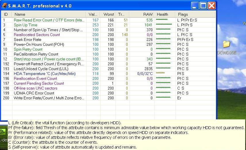

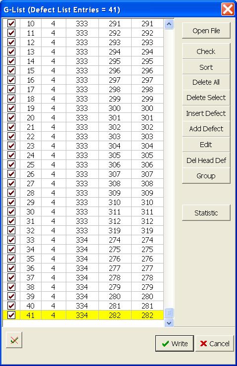

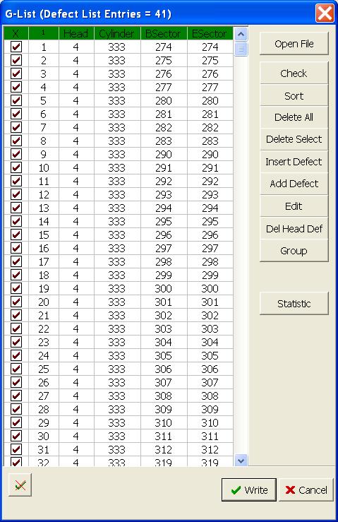

Hello i've WDC WD20EARS-00MVWB0_25.12E hard drive which burned the 12V TVS diode after power surge.
I replaced it and now the drive turns on again but bios detects it after a lot of seconds waiting, windows does not detect it.
MHDD sector scan stops every few seconds (and the busy light turns on), after few seconds the busy light turns off and sector scan runs again, then stops again after few seconds, and so on...
I tried to clone it but is very slow, stop and go every second.
I used Sediv and WDR 4.0 to do some test and P-list translators regen with WDR 4.0, but i get error 3C1D=FMT_ERR_FIELD-LIST_WRT_FAIL
The situation is still the same.
I tried also to reset G-list (which had 41 reallocated sectors) and smart, but nothing has changed.
I did some backups of loader and pcb firmware, and some modules but i don't know how to do internal firmware backup with WDR, does someone know how to backup the internal firmware?

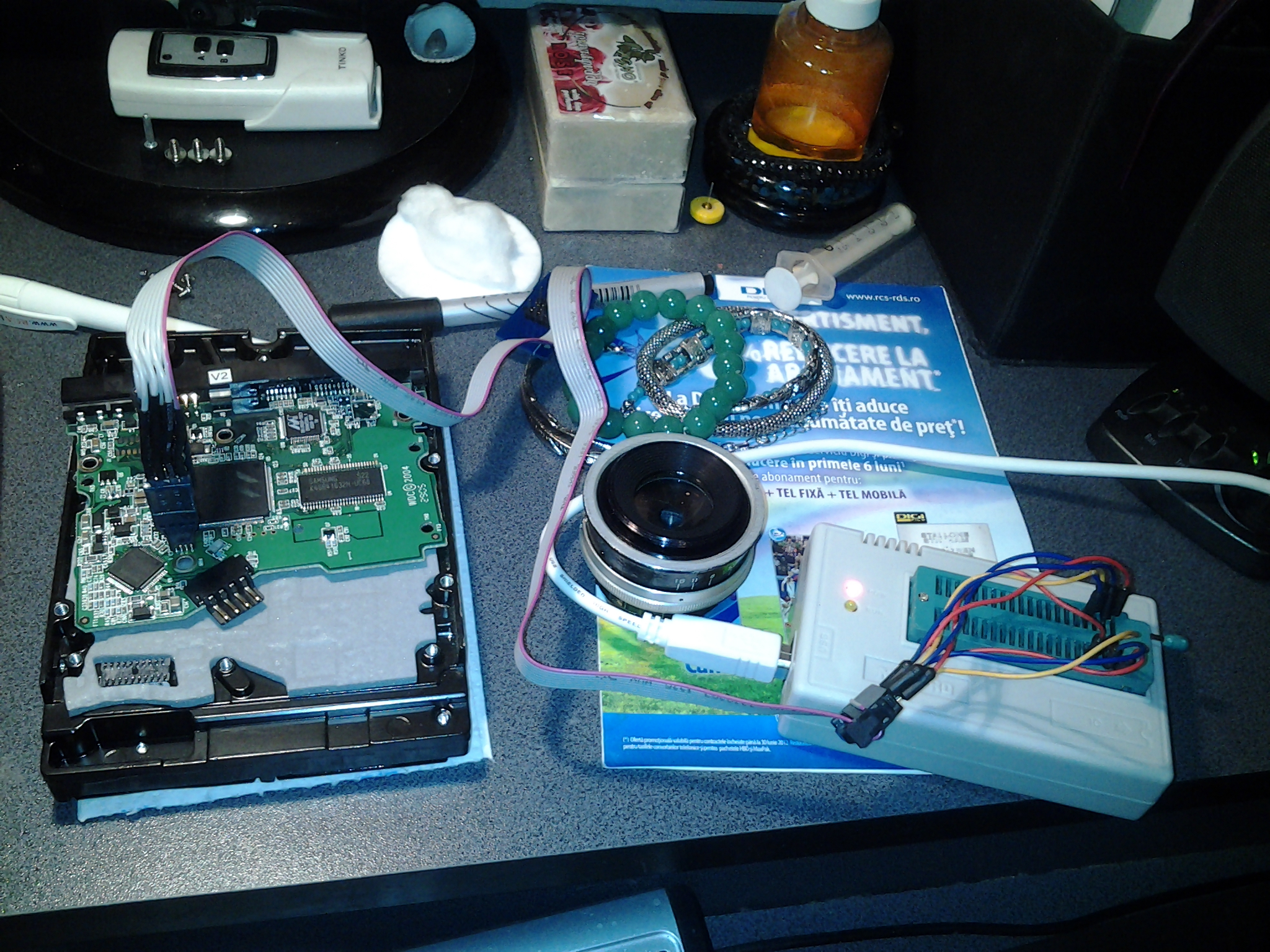

got the programmer today. just for fun..the item arrived in town on 31 march..so I waited 5 days for 5km.
now..
found the problem. see the bricked rom and the original attached. there's a missing block of 512bytes 0x200. 3.0 missed one sector during flash! :shock:
don't know if there's a bug in the 3.0 or perhaps the windows trying to detect the device exactly during the device flashing. that's why it is better to "hide" the drive behind a box. windows won't know about the drive because this is handled by the box.
to remember..the problem was on the donor's pcb, which was bricked during playing with 3.0 while depoping one head.
after flashing a good rom and I was surprised that the donor drive acted like the dead one...changed the PCB from the old drive to the donor and nothing changed (last time I did that..the drive started..so i knew that should work). still dead..I mean..clicking 5 times..not finding SA!. then I said..that's it..the preamp has gone on this drive too. but after putting back its own pcb..I observed that I didn't tighten enough the screws. so I paid a little more attention when screwing and the drive started nicely. this is another possibility for a drive to appear as dead and clicking like not finding the SA.
with the programmer along, I did first test with my flash_write function. It was written some time ago but never tested :) I can say that after the write, the pcb doesn't reboot. so I can read again the flash and compare with the one I flashed..to check if match.
see the log:

and finally I attach an image with the programmer. the soic8 clip it's a little difficult to be placed on rom chip, and has the wires soldered in a way not compatible with my ST 25P10 so I had to use some wires to reorder where the pins go.
