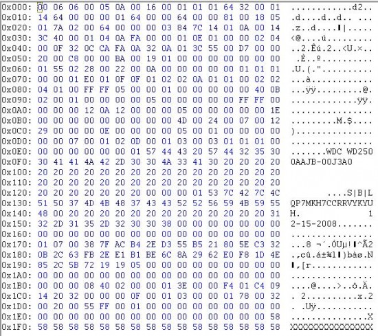

It appears to me that the user and master passwords each occupy a block of 32 bytes.
The password string appears to be terminated in a NUL byte (00).
The header consists of three bytes, 01 07 00.
The master password is 31 bytes long and consists of "WDC" repeated ad infinitum.
The user password appears to be ...
3E A8 00 42 DC 3E 24 F5 C5 6A 45 69 01 E6 0D 78 08 C9 86 F2 00 00 ...
If the NUL byte is indeed the delimiter, then the password is Alt-062 Alt-168.
OTOH, if NULs are part of the string, then there is no way to enter them via the keyboard, at least not in DOS. Furthermore, there is a 0D character which corresponds to a carriage return. This character will itself terminate keyboard input. Therefore such characters would need to be piped via file input rather than ordinary keyboard input.

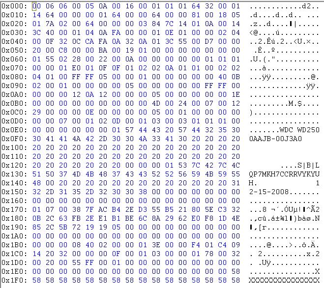

my name is Markus and i´m from Germany. First, I apologize for my bad english. I found this forum and this post when i was looking for an solution about a locked Acer Aspire Hard Drive. I read the whole post and with the post from M0RBI0US and MHDD and the 22.bin i could unlock it because the user Password was plain text.
But now i have anather problem. I have an Humax Satelite Reciever with HDD built in. I know that the Reciever set the HDD to high security and set a user and a master Password. I try to built in an WD2500AAJB. Before i built it in i had set an Master password with ATAPWD that i can erase the HDD when im gona use it again in the PC. I read id out whit MHDD and the master PW was there as plain text. So i built it in and the receiver had to Format the HDD. And now there is nothing as plain text anymore. I had attached the 22.bin as an .jpg that i read out.
When i understand the post from fzabkar right, the Password starts after the 01 07 00. but there are more than 32 Signs included and i dont know where it starts and where it´s ending.
Could somebody help me whit that problem?
