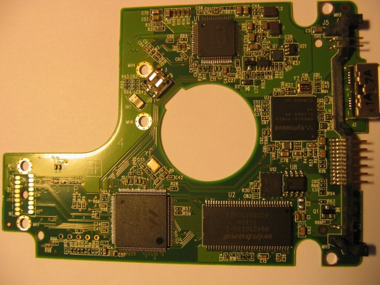

boris888 wrote:
Have the same problem with my HDD, but the model is WD10TMVW, need to get my data.
I hear that it spinned OK, I suppose that the problem with controller. The instruction posted above dosnt have the same pins to connect to SATA.
You need to show us the other side of the PCB.
That said, many people at WD's forums are reporting physical connection problems with the micro-USB connector. It could be as simple as that.

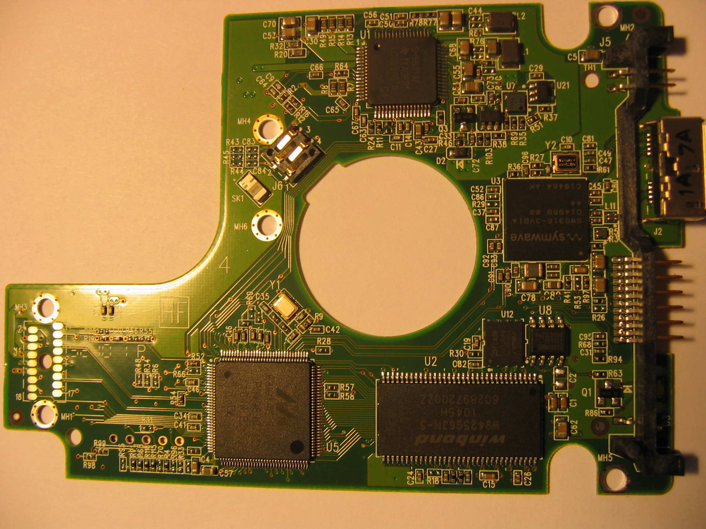

 Post subject: Re: WD10TMVV
PostPosted: November 2nd, 2011, 9:36
Joined: November 1st, 2011, 21:55
Posts: 7
Location: Russia
That is first side of my the contoller
Einstein.
If I bought another the same drive and change the controllers, can I det my data?
What's the encription method do they use? And why?
Regards,
Boris Glebov
PostPosted: November 2nd, 2011, 16:02
Posts: 17215
Here are the SATA Tx/Rx connection points:
http://www.users.on.net/~fzabkar/HDD/WD ... _Tx_Rx.jpg
You need to remove capacitors C90-93.
I don't know which pair is Tx or Rx, but the 4 signals will probably be in the same order as a SATA data connector:
http://pinouts.ru/HD/serialATA_pinout.shtml
PostPosted: November 3rd, 2011, 3:39
Posts: 17215
You need to remove the capacitors in order to disconnect the symwave SW6316 bridge IC.
The Tx/Rx signals are the 4 plated through-holes inside the squares.
I suspect that they are arranged either as ...
Transmit+, Transmit-, Receive-, Receive+
... or ...
Receive+, Receive-, Transmit-, Transmit+
MCU                capacitors            symwave bridge
Transmit+    ----x-----||-----------
Transmit-    ----x-----||-----------
Receive-     -----x----||-----------
Receive+     -----x----||-----------
Make your SATA connections at the points marked "x".
PostPosted: November 29th, 2011, 17:03
Posts: 7
Location: Russia
Many, great thanks for fzabkar!
And Russian specialsts, who helped me
All data recovered.
