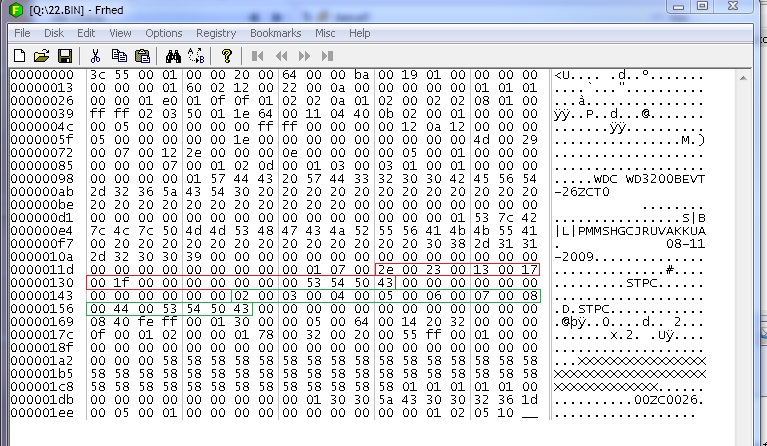

Can someone Help me to find out my Password from the locked HDD:
Log from MHDD V.4.5 (22.bin)
I think its # , but it's always the wrong Password.
HDD: Western Digital WD3200BEVT

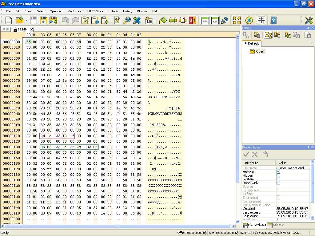

PostPosted: May 25th, 2010, 9:57
Joined: May 25th, 2010, 8:58
Having spent far too many hours trying to work out where the password is hiding in my WD1600BEVT-75ZCT2 , could someone please look at my 22.bin and tell me what it is ? I have tried all groups of numbers (but obviously not in the right combination) but cannot suss it. How do i know exactly which are the right ones ?
I guess your user password is marked by red box and your master password is marked by green box. I unlocked my hard drive (Western Digital WD3200BEVE) by this way.
I think that your user password is the part marked by red box and your master password is the part marked by green box.Try to unlock.

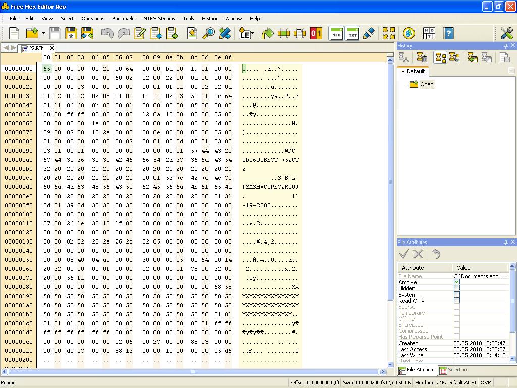

PostPosted: June 11th, 2010, 7:45
allen_lii wrote:
You was right about the user password. I had the password right a long time ago but was trying to disable the password before i'd unlocked it lol
All done now :-)

allen_lii wrote:
Ok, and now what is the Master PW in Decimal? I don' understand this Hex Code. Thx

PostPosted: June 15th, 2010, 0:59
Posts: 2288
Location: In ur HDD !
Convert it use a scientific calculator .
PostPosted: June 15th, 2010, 13:32
Joined: May 21st, 2010, 13:09
Location: German
Thanks Guys for help. Thats was the right PW ^^
