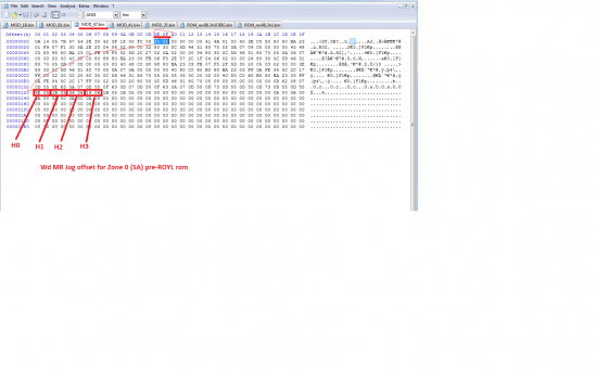

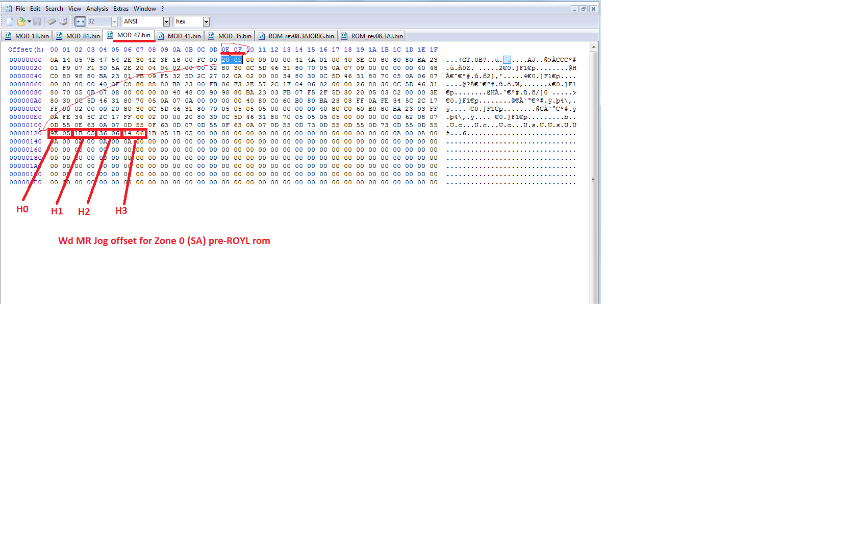

 Post subject: Re: WD2000JD problem
PostPosted: April 11th, 2013, 13:41
Joined: August 22nd, 2011, 15:43
Posts: 209
Location: Romania
here's a picture with mod 47 (ROM adaptives for a 4 headed drive) pre ROYL.
you can play with those MR Jog values to see when the head can't read. those values are also present in SA mod 41..so you'd better try the operation in safe mode.
from what you see..all balance around +- 0x600 value.
it will be nice to find..how those values are generated. since it's head-dependent..there must be a factory module to "tune" and gen those values.

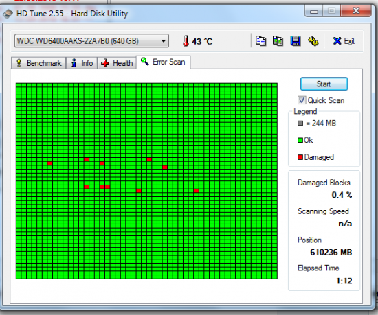

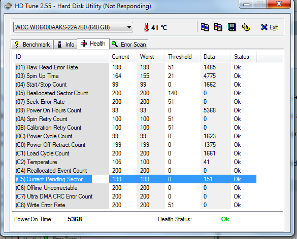

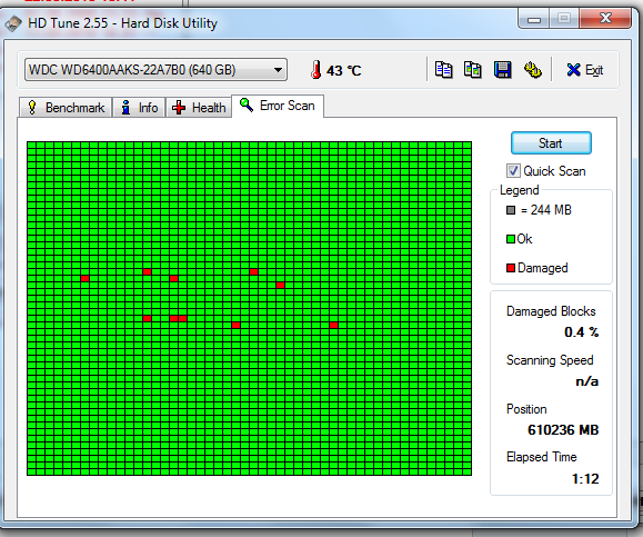

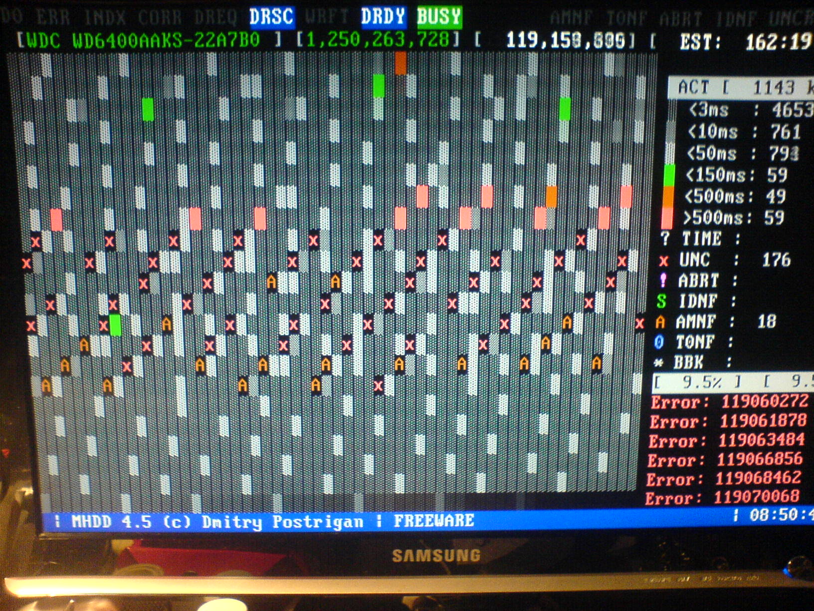

PostPosted: May 1st, 2013, 3:20
Posts: 209
Location: Romania

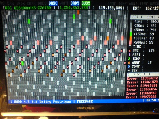

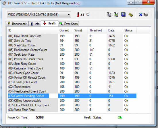

did a wd diagnostic tool on it and the SMART error went red. now the drive is BAD. the relocated sector count gets incremented while under windows.
at this moment I'm asking if I could have a bad head...or a head with wrong adaptives? or just surface bads due to the mr DR spec..when opening the drive? notice the bad pattern..on this 4 Head drive.
I know that the LBA it's a linear function, it will be interesting how it varies along the platters. it will be something like from [0-x] head 0...[x-y]..H1 on entire platter surface...or it jumps from head to head inside each Zone? I'm trying to find if those bads are from a specific head...but the MHDD shows LBAs.
I've read an entire partition (150gb) without a single error. the errors are on the other 2.
PostPosted: May 1st, 2013, 5:03
Joined: April 21st, 2013, 6:12
Posts: 17
Location: Italy
Hi louis, I'm reading you thread from the beginning, but didn't had nothing interesting to say (but had many interesting things to read :))!
Regarding your new task with WD6400AAKS, why don't you try making a raw copy from that disk to another good using ddrescue? So you could copy as much data as you can in a safe place, and than you could try to see inside with other tools like R-studio o Ontrack Easy Recovery, without having I/O errors!!
I'm afraid that going on with tests on a faulty disk you could damage head if the patter surface is damaged!
I Think that ddrescue (not dd_rescue that is another app) is the better option because first copy all good blocks, and than try to read errors by splitting block size. ddrescue it's a GNU Linux app, but you should also find some cygwin port for win32.
Best Regards
Paolo
