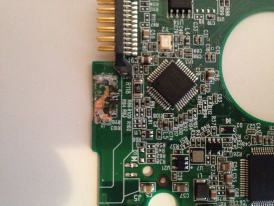

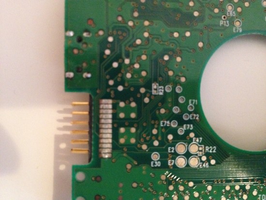

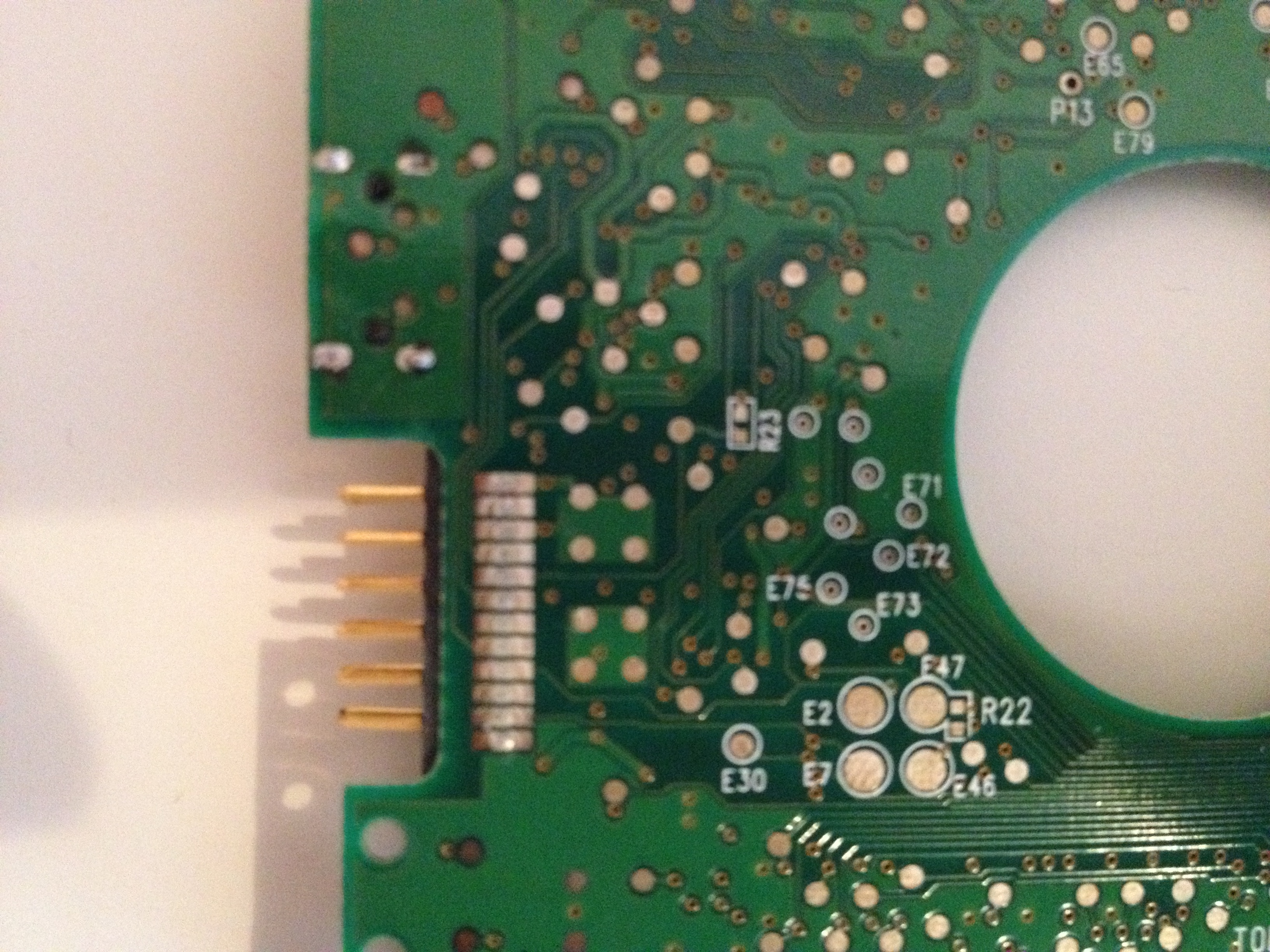

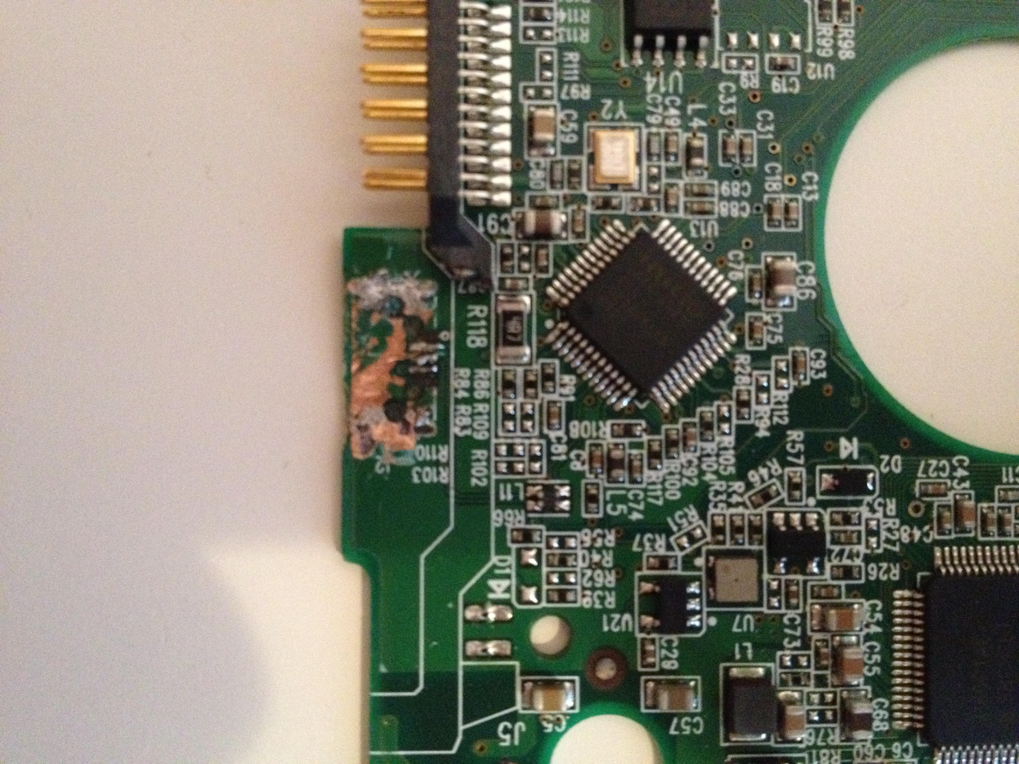

The USB bridge is completely removed from the PCB and the connectors are a bit damaged. See the pictures attached.
Is there anywhere else on the PCB that i can connect the 4 USB wires? There has to be somewhere else. If i look close i can see traces going to L11, that should be the Tx/Rx i believe. What about the VCC and GND? Anyone got a clue. I'm desperate here, i've got 10 years of photos that i need to get off that i didn't backup in time!!!! :(
Thanks,
L11 looks good for the Data+ and Data- pins. You could easily confirm ciccillover's work by measuring the resistance between the test points on the rear of the PCB against the corresponding pins of L11.

Location: Atlanta
Thanks for the help and responses fzabkar and ciccillover!. The GND and VCC were definitely the same on the PCB as i'm able to power the drive, however the D+ and D- are different, my PCB is a bit different from yours. I believe i found the proper pins but my computer does not recognize or mount the USB device. Maybe i don't have the correct pins, but i'm afraid the culprit is the logic board itself :( At this point i'm out of ideas.
A couple of questions for you guys.
1 . If i opt for a logic board replacement, what exactly would i need to remove from my old board to put on the new one to get it to work? This one does have the INIC-1607E chip, so i do realize the data is encrypted.
2. I suppose its not possible to bypass USB and go to ESATA? Due to the problem with the encrypted stream of data?
Thanks so much! i'm not giving up...i have to recover this data.
Also just to note i've got it to the point where Windows recognizes the device but as an unknown USB device. Any ideas what could be the problem?

This might be because of inverted D+ and D-. A long time ago I was building a desktop PC, and I accidentally exchanged the two lines on the motherboard pin header for the front USB ports of an ATX chassis. No matter what I plugged in those ports, it would be detected as unknown device. So make sure that your wiring is correct.
