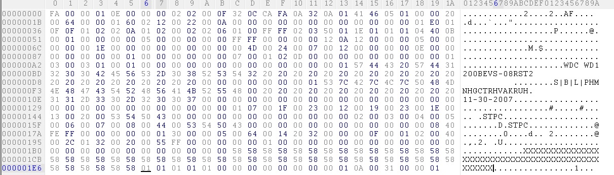

PostPosted: July 26th, 2010, 4:30
Joined: July 26th, 2010, 4:25
Location: annaba
hi there
i get 22.bin using mhdd and .dump
what 's the next step
please explain with details
thanks for all
PostPosted: July 26th, 2010, 15:42
Location: annaba
this is content of 22.bin
fa 00 00 01 0e 00 00 00 02 02 00 0f 32 0c ca fa
0a 32 0a 01 41 46 05 01 00 00 20 00 64 00 00 01
60 02 12 00 22 00 0a 00 00 00 00 00 00 00 00 00
00 00 00 01 e0 01 0f 0f 01 02 02 0a 01 02 00 02
02 06 01 00 ff ff 02 03 50 01 1e 64 01 01 04 40
0b 00 01 00 00 00 00 05 00 00 00 00 00 ff ff 00
00 00 00 12 0a 12 00 00 00 05 00 00 00 00 00 1e
00 00 00 00 00 00 00 00 00 4d 00 24 00 07 00 12
00 00 00 00 0e 00 00 00 00 00 00 00 01 00 00 00
00 00 00 07 00 01 02 0d 00 00 00 00 00 00 00 00
00 01 03 00 03 01 00 01 00 00 00 00 00 00 00 00
00 00 00 00 00 01 57 44 43 20 57 44 38 30 30 42
45 56 53 2d 30 37 52 53 54 30 20 20 20 20 20 20
20 20 20 20 20 20 20 20 20 20 20 20 20 20 20 20
20 20 00 00 00 00 00 00 00 01 53 7c 42 7c 4c 7c
50 48 4d 46 48 47 43 54 52 37 56 41 4b 52 55 48
00 20 20 20 20 20 20 20 20 20 20 20 20 20 30 35
2d 31 38 2d 32 30 30 38 00 00 00 00 00 00 00 00
00 00 00 00 00 00 00 00 00 00 00 00 00 00 00 00
00 00 00 00 00 01 07 00 92 9b b8 8d be 95 c0 b8
25 37 71 1b 7d 2b 81 71 4a 6e e2 36 fa 56 02 e3
94 dc c4 6d f4 ad 05 c6 8a b9 96 95 8c 8b df 8a
15 73 2d 2b 19 17 bf 15 2a e6 5a 56 32 2e 7e 2b
55 cc b4 ac 64 5c fc 56 08 40 00 80 00 00 00 00
00 01 30 00 00 05 00 64 00 14 20 32 00 00 00 0f
00 01 02 00 40 00 2c 01 32 00 20 00 55 ff 00 00
00 00 00 01 00 00 00 00 00 00 00 00 00 00 00 00
00 00 00 00 00 00 00 00 00 00 00 00 58 58 58 58
58 58 58 58 58 58 58 58 58 58 58 58 58 58 58 58
58 58 58 58 58 58 58 58 58 58 58 58 01 01 01 01
01 00 00 00 00 00 00 00 00 01 0a 00 31 00 00 01

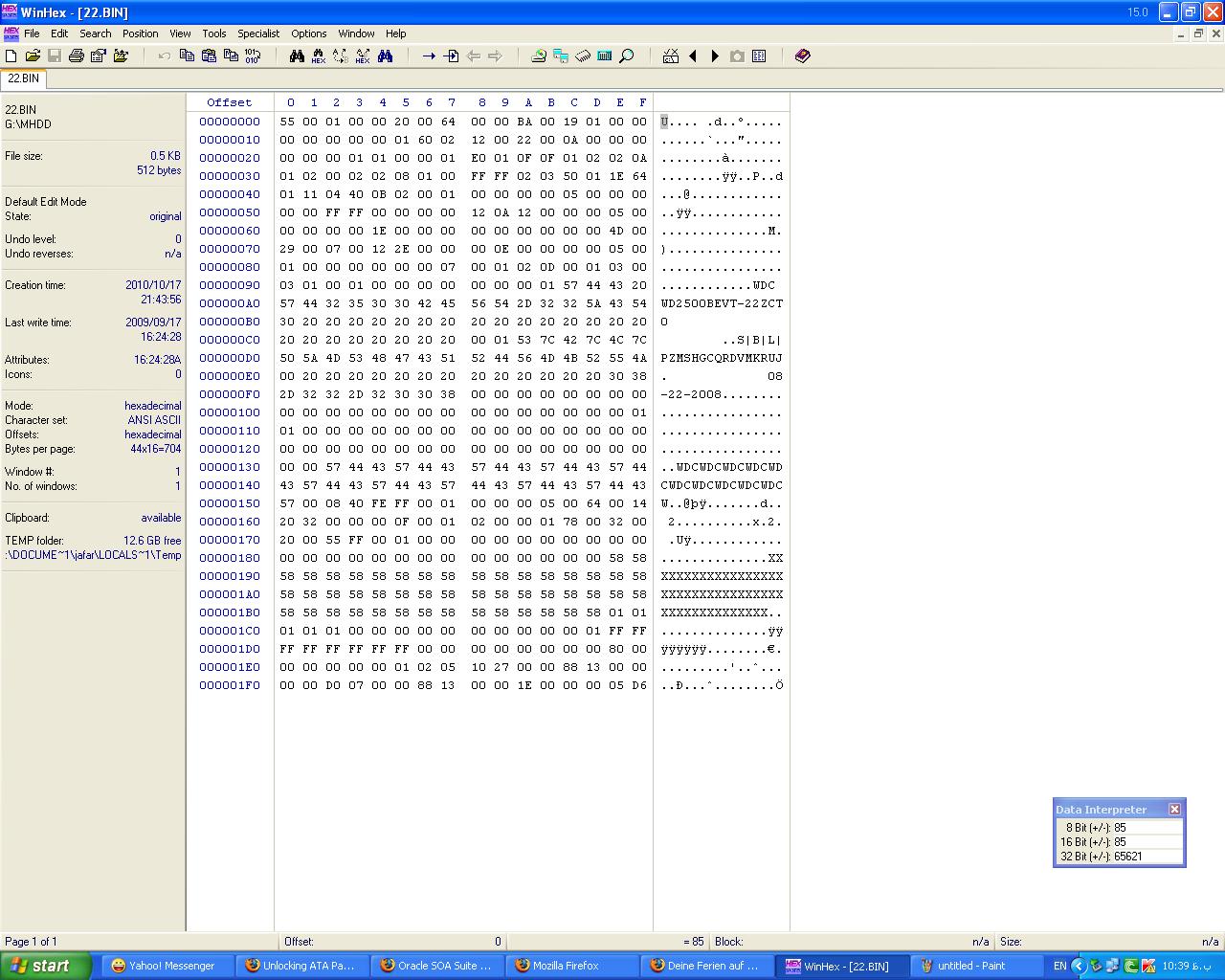

Hi all, First of all, i would like to congratulate you all in giving up your time to help some n00bs like myslelf. Well Done.
I have been able to get Soo Far with getting my HDD Password. I have managed to dump the file using MHDD however have tried every suggestion on here to get the password :(
Here is a screenshot of my dump and would be forever grateful if you could give me the Master Password.
Regard
Jamie Cruickshank
Thanks in advance!
PostPosted: July 27th, 2010, 23:42
Posts: 3598
Location: Chicago
You should ask infringer, he knows how to help you. He even published his own guide for resetting passwords

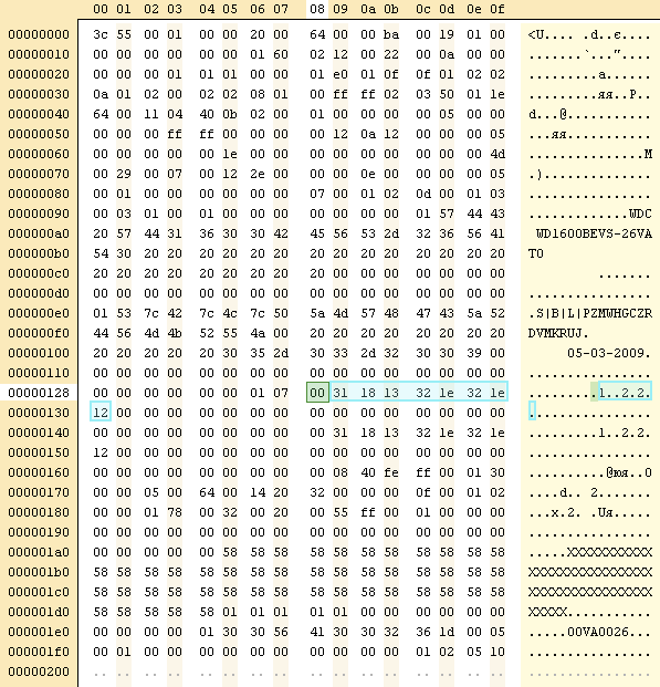

A friend of my wife bring me a laptop with "Enter HDD Password" on startup.
After doing investigations, I found the disk is a WD1600BEVT.
I search all over the Net and find explanations about the message, as I didn't heard about this before.
After lot of searches, I found this forum, with all the explanations about MHDD.
Thank you to all for your contribution,
After loading and executing MHDD 4.5 with the good scripts, I was able to locate the password string.
But I have the same problem than others : it was coded-like.
Then I red all the posts and found those with coded strings and "decoded passwords"
I don't have the magical program which decode the strings, but I found how it work ! :D
In my log (22.bin) , I can read somewhere :
00 01 07 00 1F 00 12 00 30 00 00 00 ....
the coded user password is composed by : 1F 12 30
look at the keyboard scan codes table located at : http://flint.cs.yale.edu/cs422/doc/art- ... APNDXC.PDF
and find the password in clear : s e b
that's all.
It took me a while to analyse and find it, but I think Internet is a sharing stuff that's why I want to write this post, maybe will it be usefull to many .....
Thanks again for all informations I found Here.

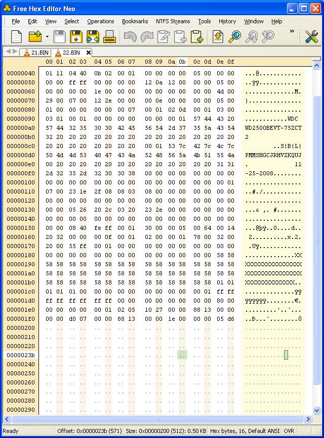

PostPosted: September 30th, 2010, 11:30
Joined: September 29th, 2010, 18:29
Location: Italy
i have this DUMP... if someone can help me to find the password in hex, i thank him for ever..
PLS HELP ME
script 22.bin
http://img180.imageshack.us/img180/2494/catturace.jpg
wd1600bevs
when use this hdd in a acer laptop ask me enter hdd user password... i think is right mhdd for my problem??
