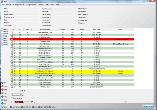

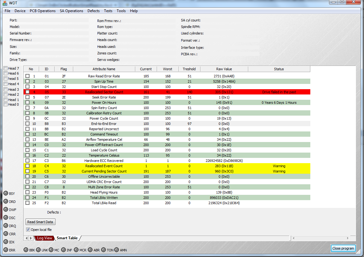

Smart Attrib Table..it's a sector of 512 bytes. the drive firmware respond with it for an ATA command. WD holds some secret attributes. to see them we can download the module 21 and search for the smart sector deep inside. :)
here's a first screen from my gui app. according to ata specs, each smart attrib has an ID, a flag and the rest of columns u can see (12 bytes). there is one more table for threshold values. the flag's bit 1 tells that the attrib its vital (the odd flags). it turns to red when any of current or worst values became lower than threshold. the current and worst values are generated by firmware, based on the "raw value". let's say that the drive starts to make BADs...then the smart code in firmware..checks how many bads are, and lower the worst and current values using some scaling factor. I made yellow the bad related attribs to warn that something it's going bad. if you have any idea what to color in addition please let me know.
in the picture I opened a 21 mod file..(royal drive), and parsed it with my code. in addition I could get the smart sector from the drive with an ata command, but it will miss some hidden attibs.
so a drive it's failing if an attrib with odd flag has the current/worst values lower than threshold.
the wd mod 0x21 seems to have a shadow copy(not seen in directory mod 01)...named mod 0x20

I notice that you don't issue warnings for hidden attributes, eg attribute 0xC3.
BTW, flag bit #7 appears to determine whether the attribute is hidden.
Hidden SMART attributes in WD HDDs:
http://malthus.zapto.org/viewtopic.php?f=59&t=127&p=155

if we can see those hidden...attribs..then it doesn't matter what bit 7 is :) wanted to let the column header clicks sort the items by flag. inserting your H there will screw the data. :)
the log you posted in your link it's from a parser made by u?

tried to edit the smart table and upload it to SA. it doesn't work :mrgreen:
the write mod 21 ends fine, with no error..but when I read it back...it doesn't reflect the modifications. perhaps that table it's only a reflection of the data stored in another places and gets overwritten back as soon as I change it.

IIRC, MODs 20, 21, and 22 store the SMART data. If you compare the raw values of the Total LBAs Read and Written attributes, I believe you will see that one MOD is updated before the others.

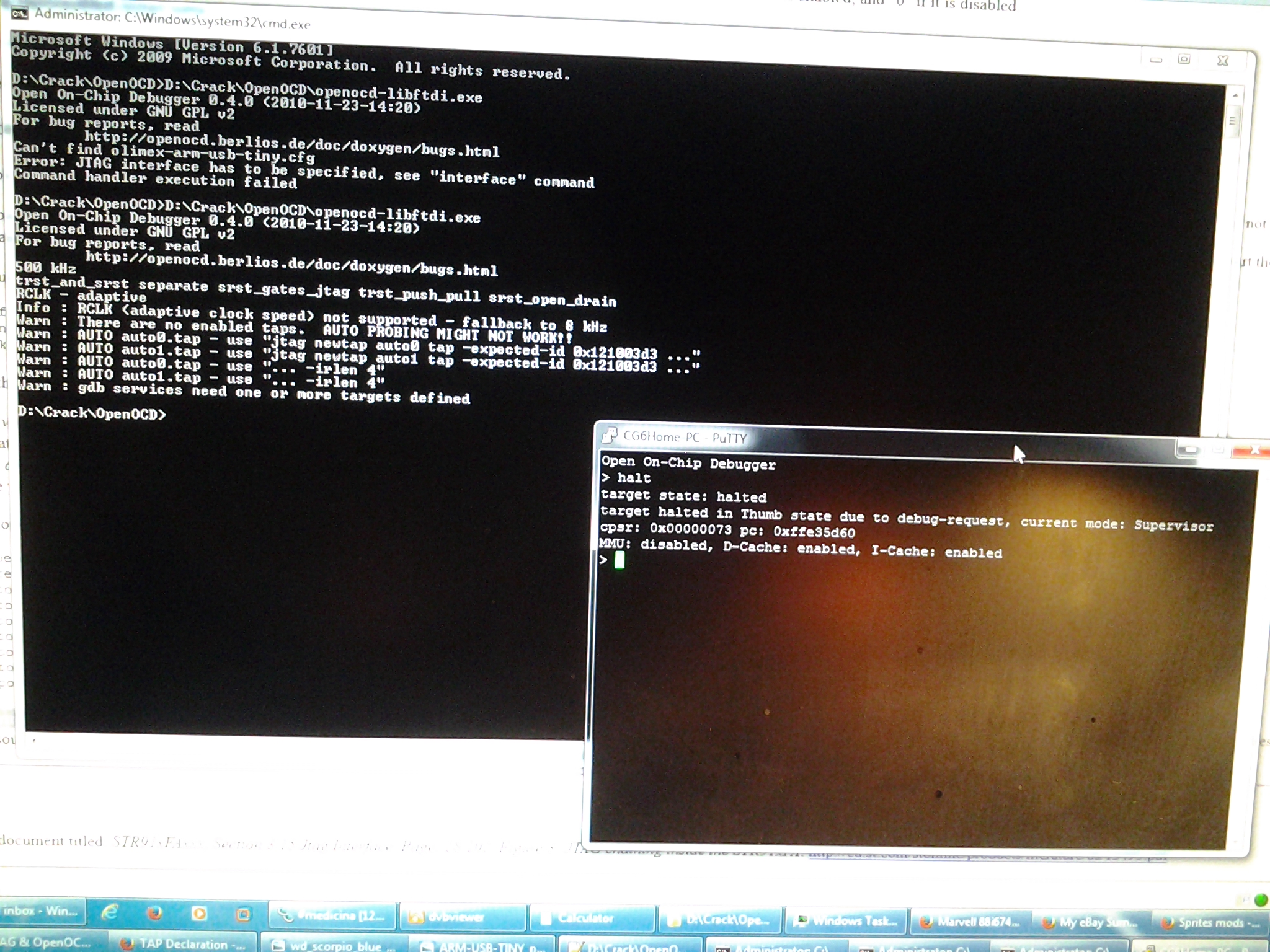

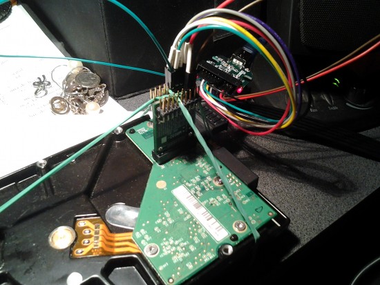

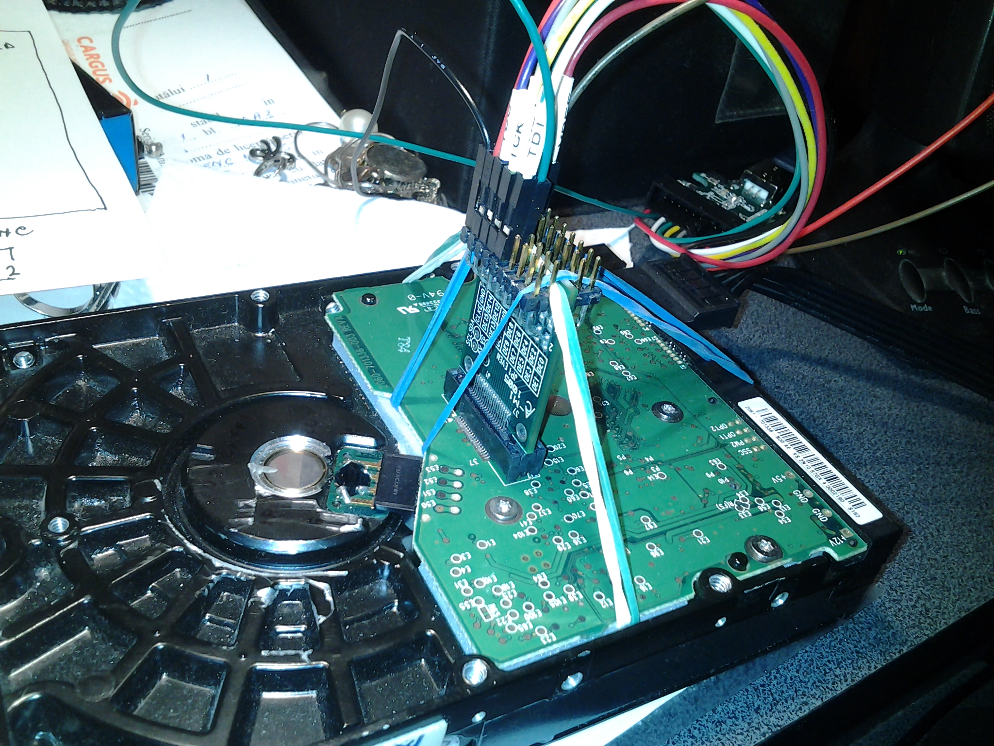

WD6400AAKS with some stuff on it :)
no soldering, just some elastic rubber bands.
this cpu has 2 TAPs (test acces ports) not quite like in Dejan's sample. to build a working script we must auto-probe the TAPs and add all to the feroceon.cfg to be able to halt or debug. newest CPU's have more TAPS, each one controlling something (cores etc)
I used OpenOCD with a usb jtag debugger, wired to a mictor breakout. the jtag con1 fellows this arm cpu specs.
basically with this setup a new firmware can be written to ram which is just what we need to temporary start the pcb, access it with a software and flash the internal rom. of course you could study the firmware's flash_write code, write a injector which then flashes the rom as soon as it is executed.
however I couldn't manage to connect to the PCB for which this thread exists :) ..maybe the con1 has other wire scheme for old pcb's, or the contacts are not quite well.
meantime I found another donor somewhere in France. what I need now it's a clean room and some practice with head replacement technique.

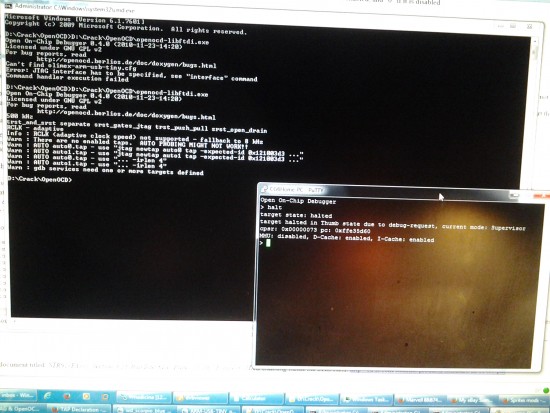

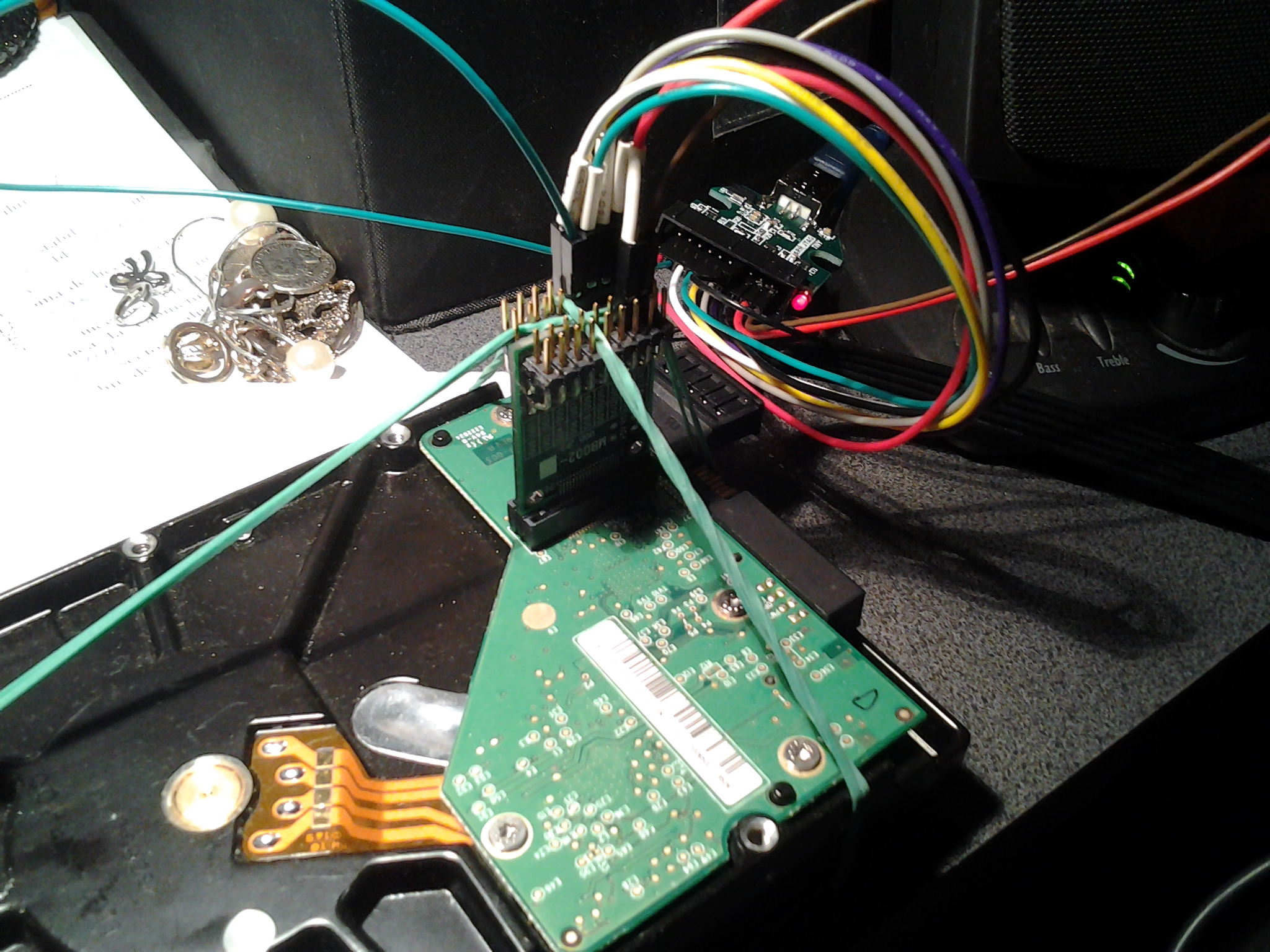

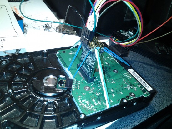

wow. I managed to hook also the wd2000jd. (it seems to be from the contacts) the TAP it's like dejan's :)
Open On-Chip Debugger 0.4.0 (2010-11-23-14:20)
Licensed under GNU GPL v2
For bug reports, read
http://openocd.berlios.de/doc/doxygen/bugs.html
1500 kHz
trst_and_srst separate srst_gates_jtag trst_push_pull srst_open_drain
jtag_nsrst_delay: 200
jtag_ntrst_delay: 200
Info : clock speed 1500 kHz
Info : JTAG tap: feroceon.cpu tap/device found: 0x259663d3 (mfg: 0x1e9, part: 0x5966, ver: 0x2)
Info : Embedded ICE version 6
Info : feroceon.cpu: hardware has 1 breakpoint/watchpoint unit
Error: unexpected Feroceon EICE version signature
Info : accepting 'telnet' connection from 0
target state: halted
target halted in Thumb state due to debug-request, current mode: Supervisor
cpsr: 0x800000f3 pc: 0xffff0e70
MMU: disabled, D-Cache: disabled, I-Cache: disabled
MCU 88i6540-lfh1
MDL: WD2000JD-60KLB0
this would be nice to debug, since the bootstrap it's quite small. the unpacking code etc.

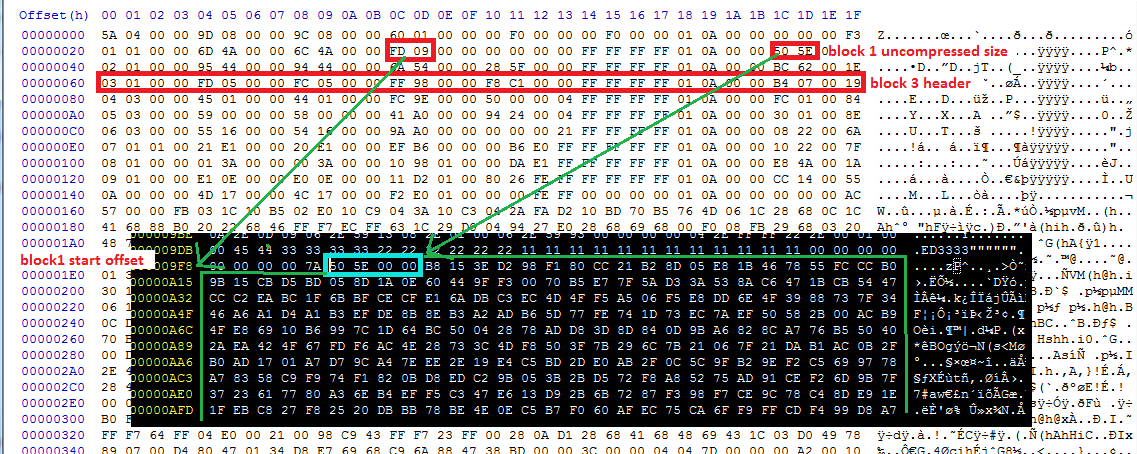

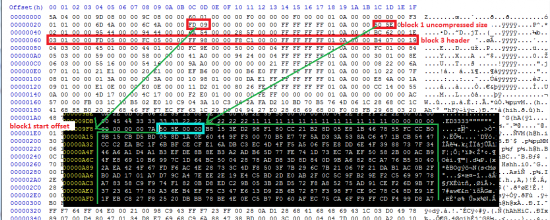

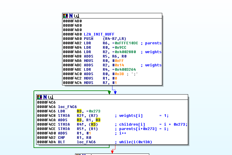

I'm trying to figure out what's the compression algorithm for the firmware's blocks and I think I got something. I'm doing IDA debugging but it doesn't work to well since it seems it doesn't handle well instructions stepping; also the "touch only" connections seems unstable and I'm loosing control frequently. right now I'm debugging first block of the firmware which it's a loader which unpack and map all the remaining blocks.
I found that the second byte (the first it's the block number) in each block's header has the first bit indicating if the block it's compressed.
KLOAD:FFF1F1B6 LDRB    R0, [R0,#1]     ; gest second byte in header
KLOAD:FFF1F1B8 LSLS    R0, R0, #0x1F   ; test bit 0
KLOAD:FFF1F1BA BEQ     loc loc_F1C6
 Post subject: Re: WD2000JD problem
PostPosted: September 13th, 2013, 11:38
Joined: August 22nd, 2011, 15:43
Posts: 209
Location: Romania
the uncompressed size of rom blocks it's made from 2 words in header. the lower word it's at offset 0x1C in block's header. also if you scroll at the block start in rom image, you will find the the uncompressed size also there, the first dword. :)
the decoding/uncompressing routine it's in the first block (ID it's 5A aka block Z), which it's not compressed and it's executed by the bootstrap (code built in MCU which loads the firmware);
you could analyze the first block with an arm disassembler.

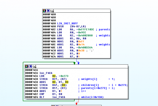

from what I've found it's seems that the algorithm it's a sort of LZAH
// initialize arrays
         foreach (i in [0 .. 0x139])
            weights[i]       = 1;
            parents[i+0x273] = i;
            children[i]      = i + 0x273;
         foreach (j in [0x13A .. 0x272])
            def i = (j - 0x13A) * 2;
            weights[j]     = weights[i] + weights[i + 1];
            parents[i]     = j;
            parents[i + 1] = j;
            children[j]    = i;
