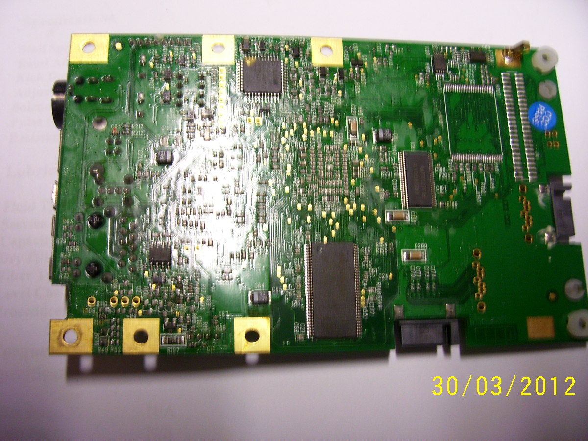

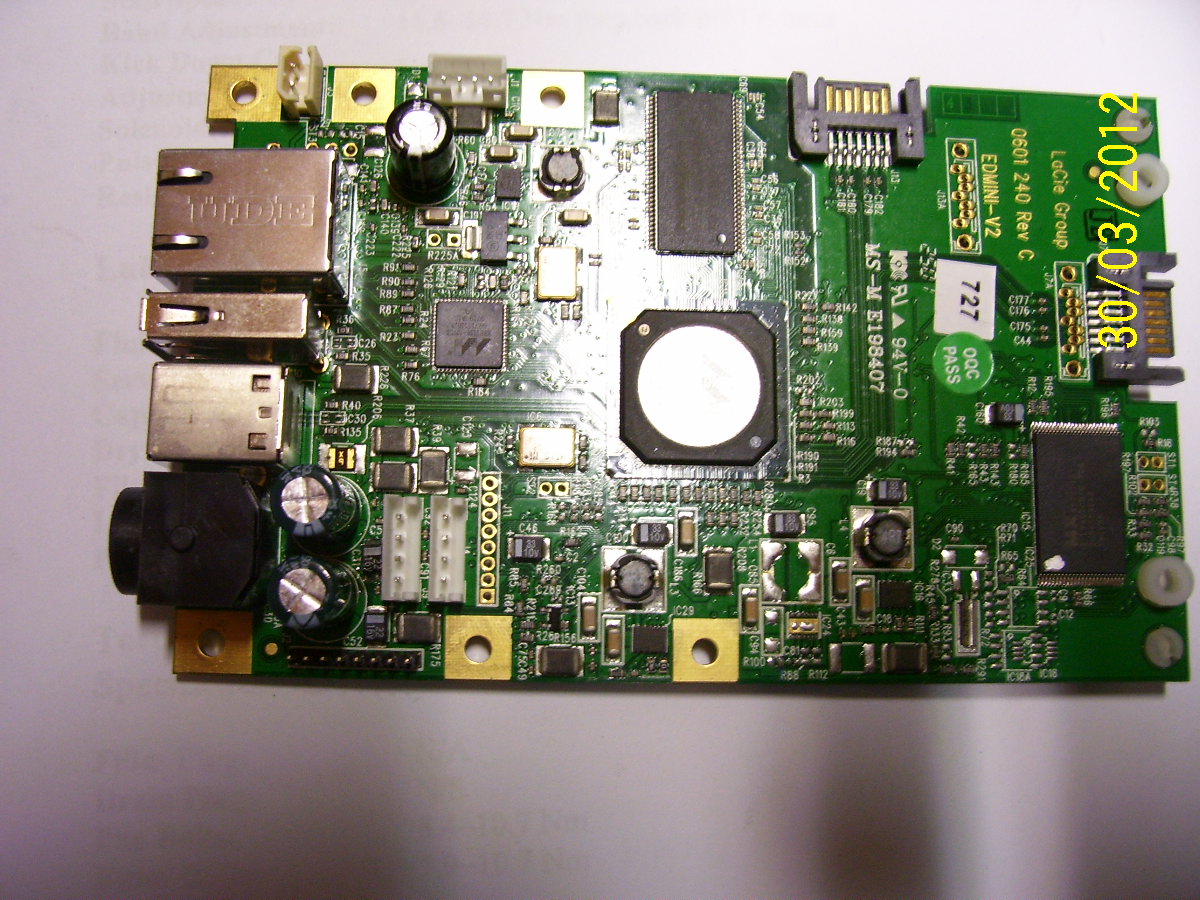

I've attached a photo of the board, not sure if it will help, I just thought as the item was made in 2007, there would be a better, faster firmware update since then?

photo of the back side where the IC20 chip is, but cant get a clear hi res photo of itself(have tried but blurry!).
Re: Lacie Ethernet Big Disk 2TB replace HDDs
March 29th, 2012, 21:37
I doubt that it will help you at all, but the board's firmware appears to be stored in a Macronix NAND flash memory chip (IC15) in the bottom right corner of the first photo. AISI, you would only need to reprogram this chip (via a header on the PCB ?) in the event that it became corrupted.
As for IC20, I can't make out anything from the photo. In any case, I suspect that nothing would be gained by poring over the hardware, except to satisfy our curiosity.

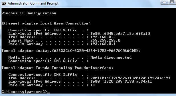

o.k. well yet another night of trying to get it recognized.... Still no luck!
Here's a screeny of what it shows in ipconfig in command prompt, but if I try & type any of them into explorer bar nothing, says it cant find or doesn't exist!
I even tried the proceeding numbers after what show's up in the ip config, but nothing!
It seems even weirder as the blue power switch on the device is non responsive just stays on all the time & pressing the micro switch does nothing to shut it down or reset it!
I have to switch power on & off at teh wall to control it!
Thanks again Grant

However, AISI, warnerr is saying that you have a problem in the connection between your Windows box and your router. Just to be certain, I take it that you have a router, and that one port on this router is cabled to your Windows PC and another is connected to your Lacie NAS.
After your Windows box boots up, it waits to receive an IP address automatically from a DHCP server running inside your router. If the timeout period expires and the PC still hasn't obtained an address, it then reverts to its alternate settings, in which case it uses those manual settings which you have supplied. I presume you have obtained these IP addresses from the Lacie manual.
You can confirm beyond doubt that you have a connection problem by disconnecting the network cable from the PC and then rebooting. If ipconfig still produces the same output, then that would suggest that there is some problem between the PC and the router.
BTW, you can capture your ipconfig output to a text file, as follows:
ipconfig /all /batch winipcfg.out
You could also use the GUI alternative, winipcfg.
The fact that the NAS doesn't respond to its soft power button may be indicative of an internal problem. I don't know whether this would be hardware or firmware related. You could try to narrow this down by connecting your NAS to your PC via USB. Your Windows box should detect the USB device via PnP and then prompt you for drivers. Afterwards the Lacie box should appear as local storage.
