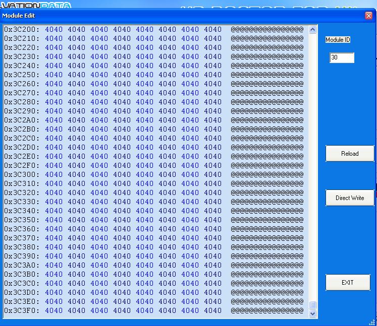

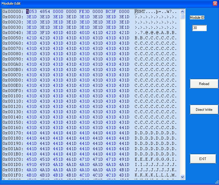

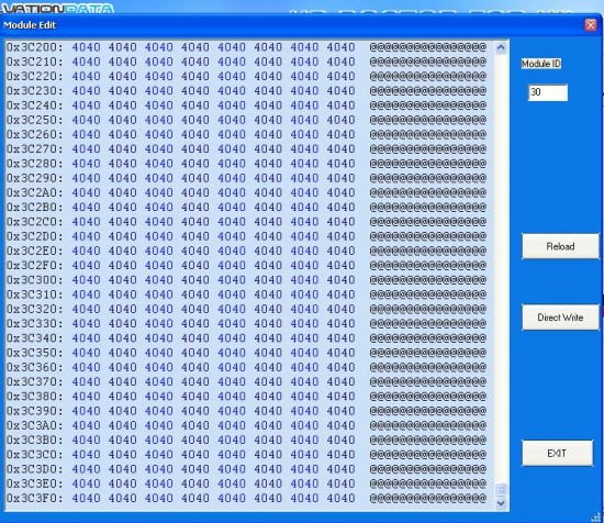

Do you have the FW for this drive in SD format? Looks like I can write/update the modules but I can't get any good modules from my SA-C. SA-C Only goes up to 30 but SA-A shows 51.
these are the modules that I can't get...
0
1
26
28
30
31
33
34
35
36
37
38
39
40
41
48

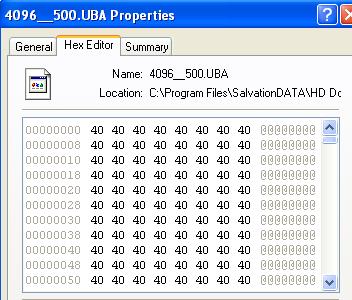

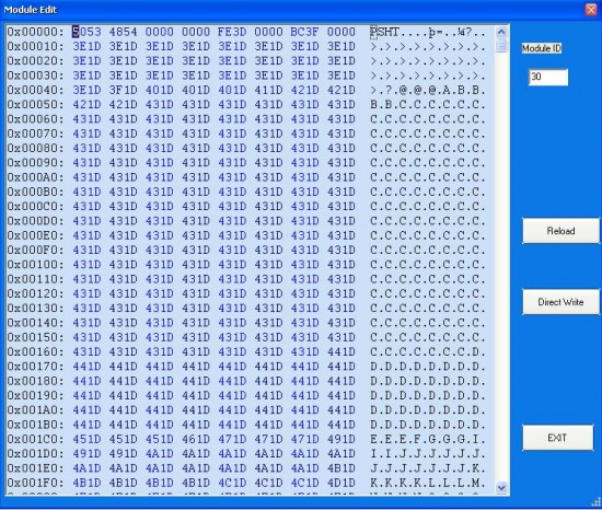

What am I doing wrong here????
