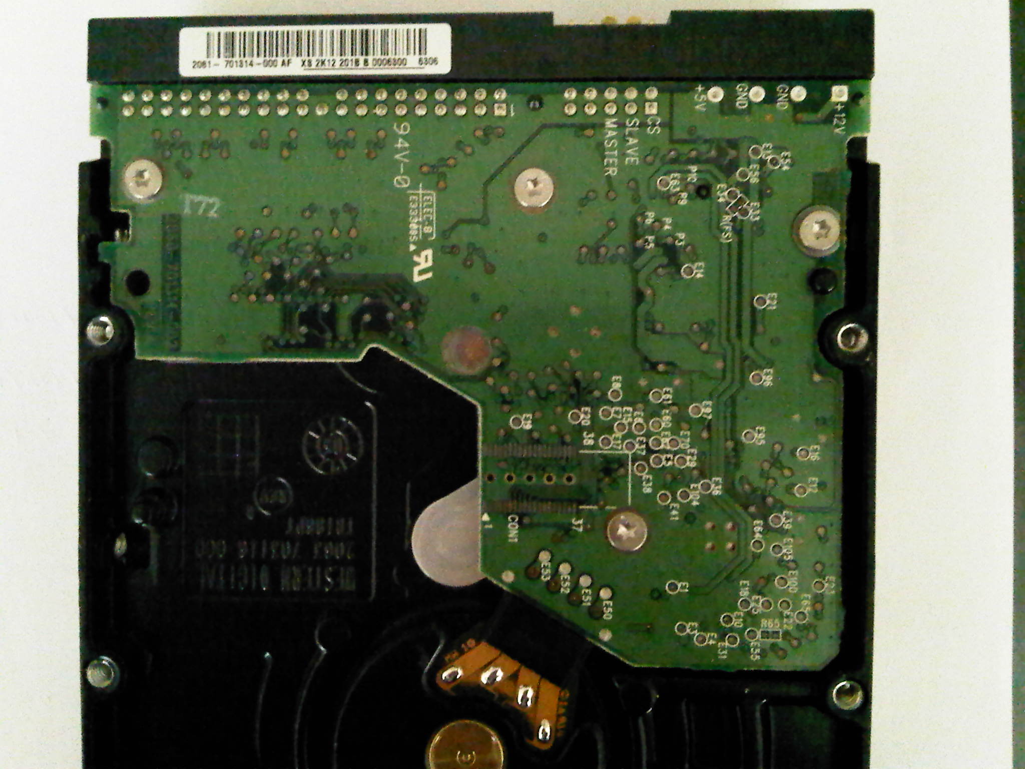

Hi fzabkar - that would be great as the pcb on my drive doesnt look at all like the other pics on this post.
Ive uploaded pic of the drive :Caviar WD3200BB-55KEA0
Many thanks in advance!! :D

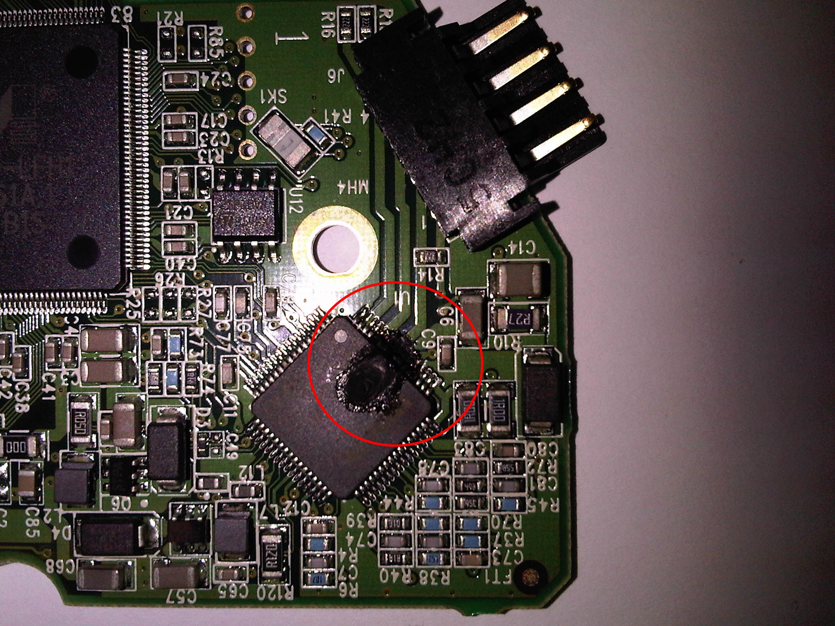

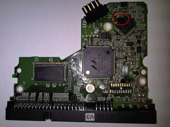

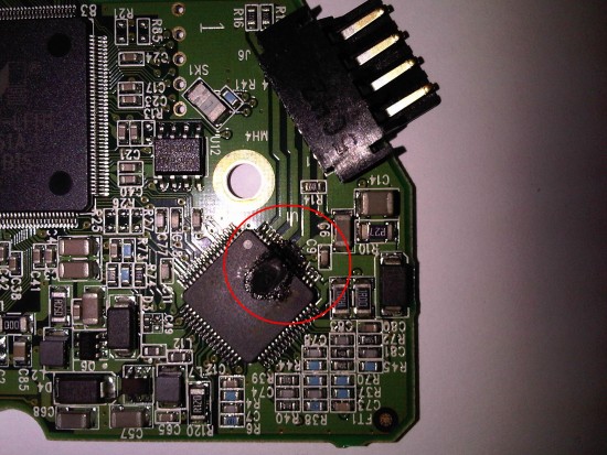

Scrap that - Ive took the board off realising components on other side (Duh!!).........and found that a chip has been blown as shown.
Is there anything I can do????
Please tell me I can replace the board to get access again???
HELP!!!!

Spildit wrote:
Check if the short is still there ! You might have another burned TVS, plug on the computer directly and check if the computer goes down with the drive puggled in, or check the PCB for short with the multimeter....
Thats not a very good way to check for shot circuit . He should have tested the 5/12 bolt pins for 0ohm?! plugging it in like that with a fault can still cause other things top fry.
HELP!!!!
You should start your own thread.
Thats an easy fix. If you got the right tools and experience. PCB swap is good start but only 1/3 of the way.
Check for quotes.
EDIT
Looking at the picture again- closely - it might actually not be that easy.. you need to send for quote to pro to test where the fault is. Just doing random stuff will completely destroy this drive.
Free Solutions

Posts: 1493
my money is on a Fried pre amp. You are looking at £500 - £900 if you want to see the data again.
 Post subject: Re: Seagate 320GB ST3320820A - PCB swap?
PostPosted: October 6th, 2010, 7:29
I wonder if BEFORE doing "something" the preamp was OK.... :mrgreen:

.......guessing 'something' being removing the pcb???
I accept my stupidity if this was the case :( (though how would I have removed/replaced TVS's without removing the pcb.....and I did use anti static equip)
I have created new thread
wd3200bb-fried-smooth-chip-help-t17263.html

"something" was intended like removing the TVS , NOT checking the rest and using a common PC or PC power supply.

I was unable to check with desktop PC as I connect ext drv to laptop.
But I did use a seperate external interface to test.
All testing seemed to match exactly to original posters situation which made me believe TVS's.
Then on removing pcb I saw damage to the chip.
PostPosted: October 6th, 2010, 8:33
Anyway it's a bad damage. There are chances that there is a internal damage AND you can fry a new PCB (that in any case , replaced straight away WON'T WORK). All depends on how valuable is your data and how much risk you want to take into account by tinkering with the drive.
PostPosted: October 8th, 2010, 3:11
Posts: 17316
Assuming there is no internal damage, you need to transfer the 8-pin serial EEPROM chip at U12 (between the Marvell MCU and motor controller) to your donor board. This chip stores unique drive specific calibration data. Hopefully it survived. If you are not experienced in soldering, then ask your local TV/AV repair shop. Otherwise, there are PCB vendors who will transfer the ROM, or its contents, for $10.
