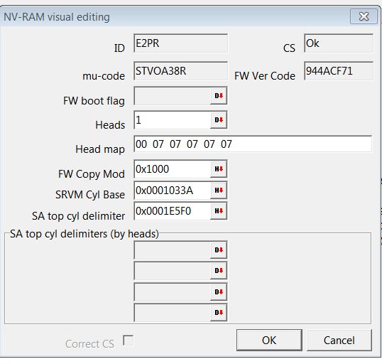

Posts: 264
nvram editing
 Post subject: Re: Hitachi 500Gb - HDP725050GLA360 - Dead PCB?
PostPosted: May 22nd, 2015, 4:09
Posts: 17231
Maybe I've introduced a red herring. Perhaps your model doesn't have a boot flag.
In any case I have no idea how a drive behaves when you edit the boot flag, but FWIW here is an article about a much earlier model:
http://www.disk-imager.com/data-recovery-blog/?p=1363
Later models appear to have FW boot flags of 0x81 and 0x80.
Maybe I'm barking up the wrong tree, but would it be worth retrieving the resources from a donor drive and comparing its PCB NVRAM and NVRC SA copy?
PostPosted: May 22nd, 2015, 4:27
ROb wrote:
nvram editing
One head?
Doesn't look right
PostPosted: May 22nd, 2015, 4:53
Posts: 17231
pcimage wrote:
ROb wrote:
nvram editing
One head?
Doesn't look right
Yes, the HDT721016SLA380 has 1 head (section 4.1). The 250GB model has 2 heads.
Deskstar 7K1000.B and E7K1000 and CinemaStar 7K1000.B Specification:
http://web.archive.org/web/201212271121 ... ev3.01.pdf
PostPosted: May 22nd, 2015, 7:38
Posts: 264
I compare both the copies of Donor drive. i.e. the PCB NVRAM and NVRC SA copy. They have some difference in them, i am not an expert of this subject. Some more hint might help me resolve this issue.
PostPosted: May 22nd, 2015, 7:39
pcimage wrote:
ROb wrote:
nvram editing
One head?
Doesn't look right
Yep, that's right.
I got confuddled by the post title "Re: Hitachi 500Gb - HDP725050GLA360 - Dead PCB"
