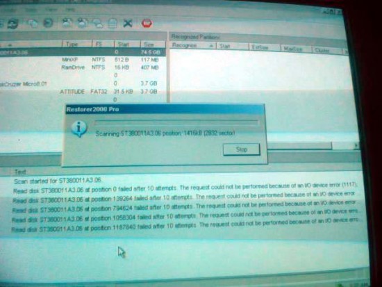

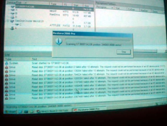

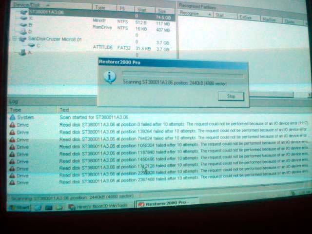

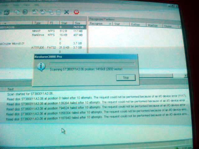

jsingh wrote:
select the option to run the windows XP pe that is inside the hiren's boot cd. You will end up with a booted OS (windows xp) and you sould be able to run tools to get your data back.
i downloaded the iso and create a bootable cd of hiren....
now when we boot from cd there are 4 options
BOOT FROM HARD DRIVE
START BOOTCD
START MINI WINDOWS XP
WINDOWS MEMORY DIAGNOSTIC
i select START MINI WINDOWS XP. then it load some files FROM cd and my cpu's red light start little blinking... iT looks like it is trying to load files form my hard disk ... and after few min in processing of OS xp it shows me a xp desktop with some system program icons....
then i put a pen drive in usb port and install the restorer2000 pro and it shows my HDD without any extra info
then i start scanning of HDD
and it showing so many failed output.... and which software i ll use now in this os... coj there are so many windows/partition utilities .. suggest me else may be i ll do some wrong.....
which utility help to read my hdd data ....
i uploaded a snapshot please take a look
 Post subject: Re: A tricky Partition recovery job ..help me
PostPosted: July 26th, 2009, 12:03
I think the problem , beside the HDD, is that the OP doesn't have either the basic skills or knowledge about filesystems, drive imaging and so on - just searching for a "magic wand" that does not exist or free help that is impossible. I think this thread will reach 5000 posts without finding a real solution : we don't know the physical status of the HDD neither the logical , AND the problems started because power was cut DURING A CRITICAL OPERATION LIKE UPDATING / RECALCULATION OF FS TABLES so the structure is in unknown or corrupted state. If I had the drive at hand I would have reconstructed BY HAND what went wrong - at first post I said to myself that this was more of a data reconstruction case than of a logical recovery.
If he's lucky, the FS need only to be reconstructed and fixed, and data will come back, maybe with some lost directory structure.
If not, only a pro can judge what to do (fix FS ? raw recovery ? try to find FS fragments and put the pieces together ? a combination of such methods ?) and what is no longer possible, as too many attempts and too many wrong things (one for all : working on the patient drive) done on the disk.
If data is really important (be honest !) , admit your limits and take it to a pro and have the job done (and pay for it)
If you cannot afford it, then continue at your own risk, or accept the loss of data.
Nothing more to say, sorry.
PostPosted: July 26th, 2009, 13:39
Joined: October 19th, 2006, 11:56
Posts: 217
Spildit
Do you realize that you probably had made his problem worse and he is now perhaps totally screwed up, just by your "Charity"? You made him erased his first thousands of sectors on an unknown condition drive, without thinking seriously that what could be the coss and it's resolution. That was the worst charity you have ever made.
Jsingh
You have screwed your drive probably by DIY. Your drive previosly was reading sectors perfectly, as you mentioned in this post (tricky-partition-recovery-job-help-t12815.html#p84432). You can see for yourself, that at that time, there was not even a SINGLE bad sector.
And now, restorer pro is unable to read all sectors from the disk. This is probably due to your attempts to the drive, including that erasing attempt.
We all here are not for the discourage you, but certain problems may need to be handled by specialists, otherwise you may lose your valuable data (if it's valuable to you at all). People ship their drives to foreign countries for recovery, because in many cases, there is not a skilled professional in their entier nations. Thus, you are lucky in this case, that you have got a professional only at 6 hours distance. Though you have poked enough with it, but if you REALLY have a data worth more then 7 years and un-replacable information, you should immediatly stop playing with it, and take it to the professional, otherwise there will be a moment, when nobody on this earth will ever be able to get your data back.
Final note to spldit:
That was a very un-professional attitude this time buddy. You have tried this charity thingy many times, but if it didn't help, it never harmed either. But this time, do you even have a thought, that you probably have made him loose his precious information forever? Tell me, which DR professional is ever going to suggest/perform any kind of erasing/wiping operation on a drive with data?
This time, it really made me upset and sad to see someone loosing his hard worked information/data, which could be easily recovered and now probably is a disaster. :(
I just hate spammers...It was a Spammer, who ruined my life!
