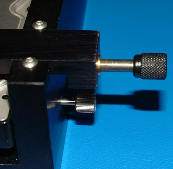

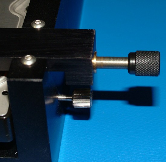

What material is this? Aluminium? Ours looks ugly compared to this beauty, but we use a much smaller thread pitch if it actually the threading that can be seen on the right. Have done two out of three drives with it so far, but I must admit that it were only easy jobs - 160GB and less.

Absolutely - ours is made of massive aluminium to prevent drive vibrations feed through to the head axle alignment, but the adjustment mechanism is very prototype ;)

shaun wrote:What material is this? Aluminium? Ours looks ugly compared to this beauty, but we use a much smaller thread pitch if it actually the threading that can be seen on the right. Have done two out of three drives with it so far, but I must admit that it were only easy jobs - 160GB and less.
This tool was machined from aluminum block.
I have forgotten what the thread pitch is, but it is micrometer grade - in fact, it's difficult to really make out the threads in the photo:

On your first photo I saw something glodish on the right side which looked like some kind of brass acme screw thread - but this would be far too large pitch.

shaun wrote:On your first photo I saw something glodish on the right side which looked like some kind of brass acme screw thread - but this would be far too large pitch.
Yeah, those are the screws that secure the drive body to the alignment jig.
