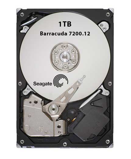

Well they don't have parking ramps then. So do they park somewhere?
Free Solutions
 Post subject: Re: ST3500320AS - Intermittent buzzing, no spin up, no detection
PostPosted: July 22nd, 2010, 16:47
Posts: 1852
Location: Belgium
AT the ID (inner diameter), closest to the spindle.
