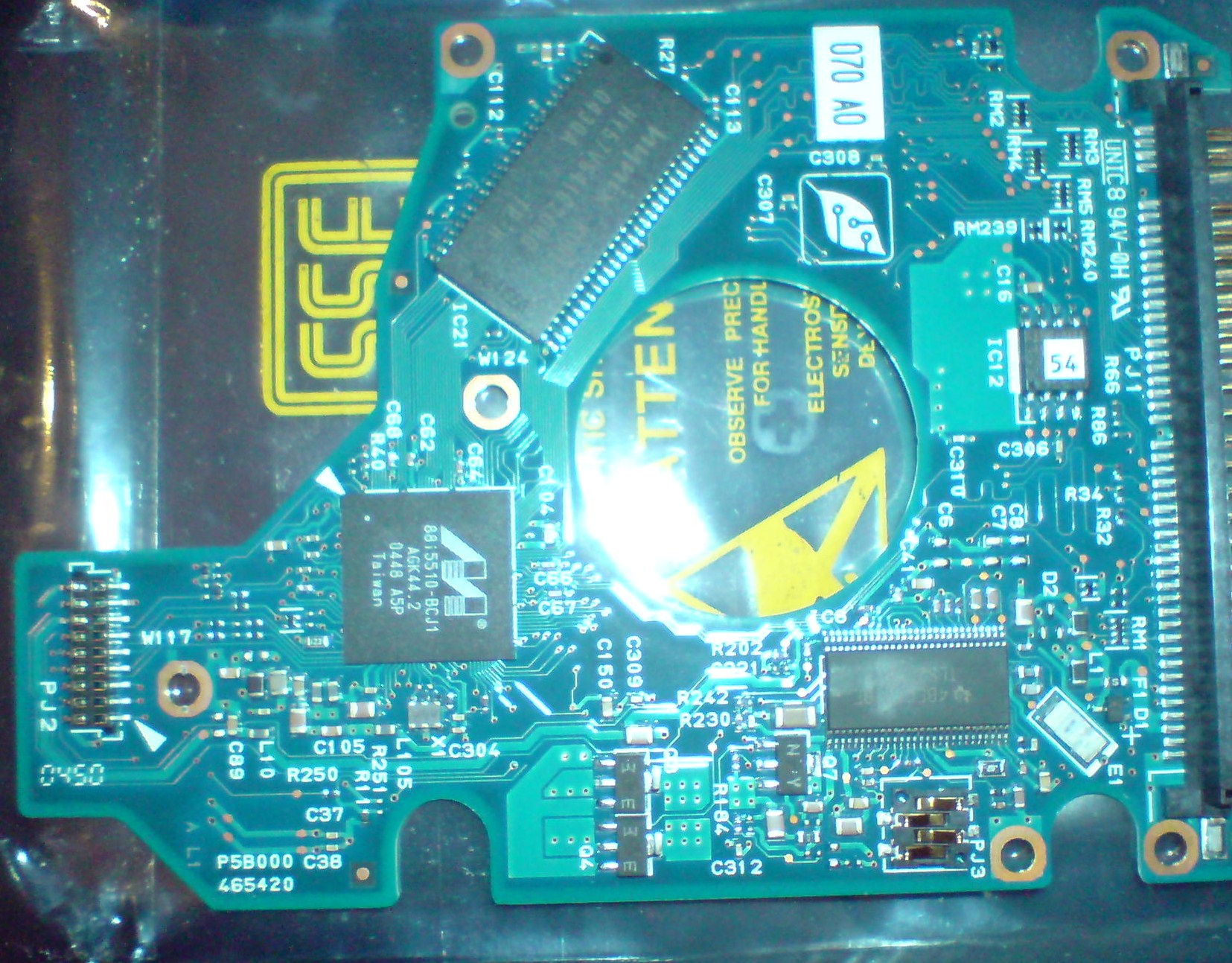

andrew2010 wrote:
Hello all
F1 the component below the F ? No beep on 200ohms setting.
D1 is that the large rectangle adjacent to the E1 marking ?
If not can you circle the correct ones on the pcb photo.
Thankyou
E1 is the white component inside the white rectangle. It is a shock sensor. It is oriented at 45 degrees in order to sense the acceleration in both X and Y axes.
D1 appears to have three pins, which would suggest that it is a dual diode.
F1 is a fuse, and yes it is located below the F. It is open, so bridge it with a piece of wire, or replace it with a 2A picofuse.
If D1 tests shorted (ie zero ohms), then remove it, but be absolutely sure your power supply is OK.
The above job is extremely straightforward. Any junior TV tech should be able to do it for you for a few beers.

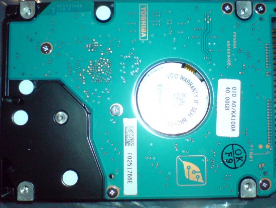

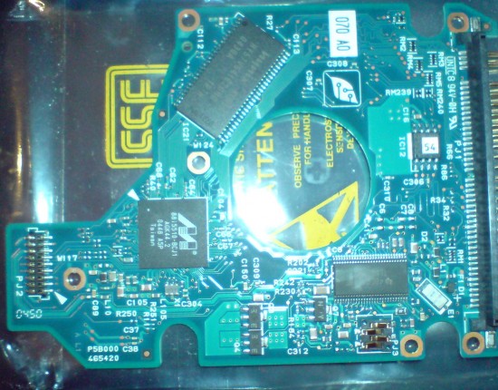

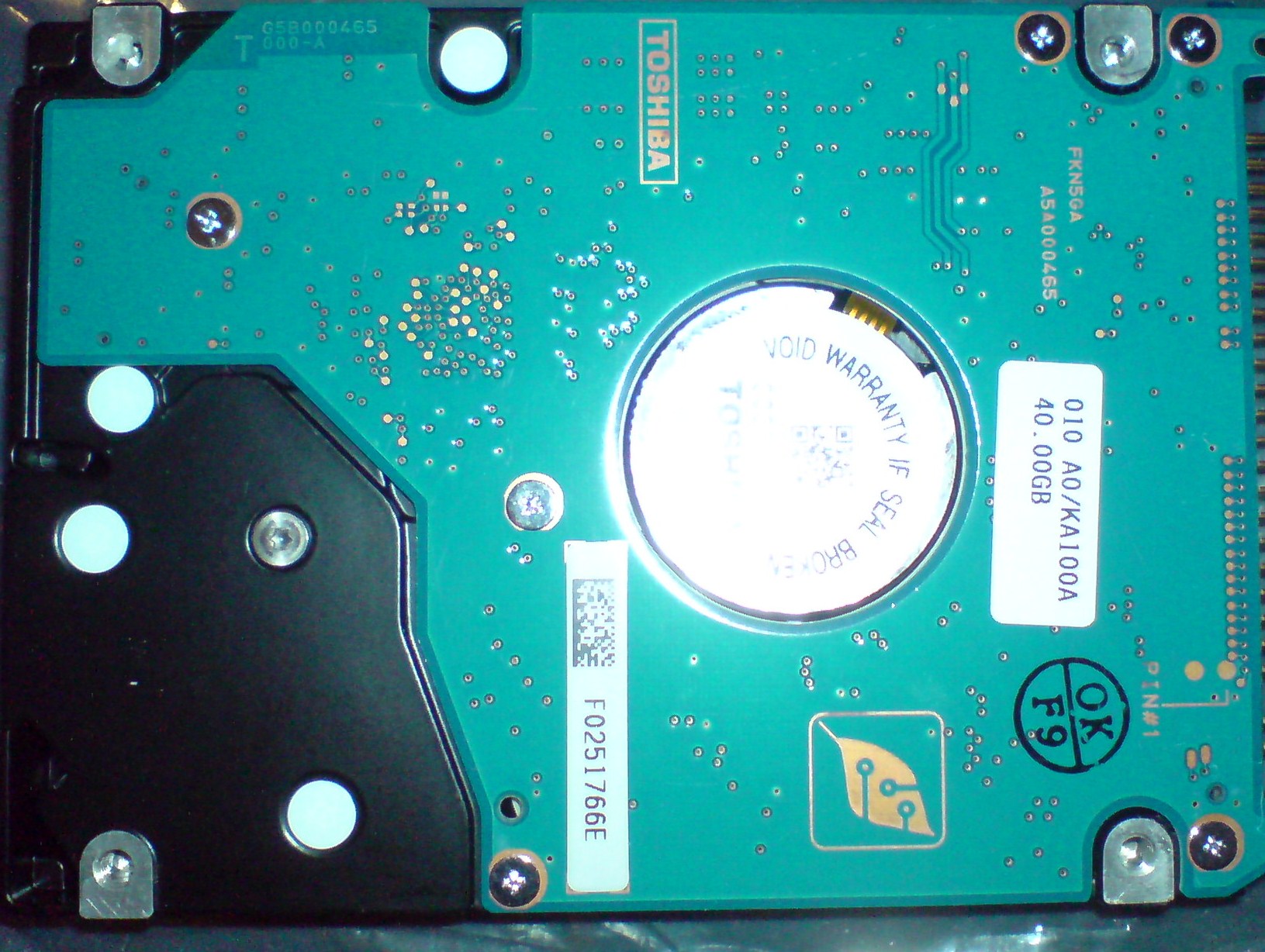

hello all
Can a Guru check if this pcb is ok pcb change and ic 12 swap.
Thankyou
 Post subject: Re: Toshiba mk4025gas shorted on connector
PostPosted: February 25th, 2010, 3:58
Yes, that PCB is OK and U12 is the chip to swap over.
Just make sure you do a good job (or get someone who is proficient at soldering to do it) and don't ruin the U12 chip, or you will have an expensive recovery on your hands.
Good luck!
