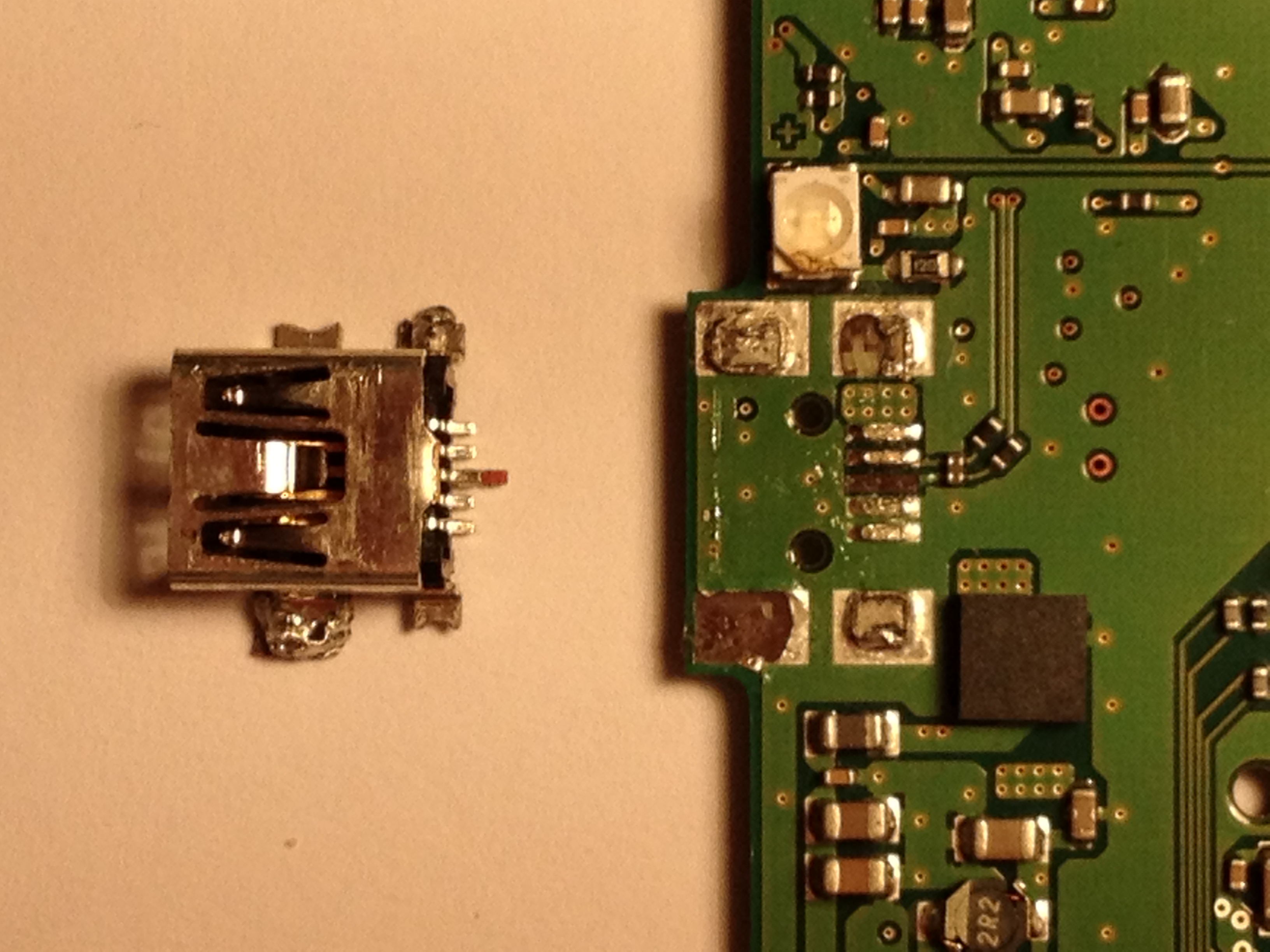

I have exactly the same issue, USB connector is broken.
On the USB connnector you have height connections (if I'm right) four on sides (big connections) and four underneath.
USB connector
When I try to hold the USB connector in its right place, my drive is right alimented but shutdown after one minute. I guess the four big connections are good but it miss one underneath...that's why it doesn't work :? Does someone know which are the different role for all these connections ?
I have also tried to replace the PCB with an other one (same reference number) but it doesn't work... The drive is alimented but not recognized by my laptop. So it seems that fzabkar was right by saying that adaptative data are embedded in the Marvell chip.
I'm not an expert of hardware so I haven't understood everything in previous posts about how to setup a SATA connection. If someone has tried and succeeded to do it it will be very helpful if he or she can describe in details how to proceed :D (Hook up SATA points and components to remove if necessary...)
I will try to find someone skilled to manage to solder again the USB connector... Hope it will work !
Best regards.

Re: Samsung HM502JX USB Only?
April 19th, 2012, 3:44
Connector solded again !
The drive is well alimented, detected by my laptop but unfortunately not recognized...
The connector seems to be well repair so there is perhaps something more.
Too bad !
April 19th, 2012, 7:26
I would suspect that 5V pins touched one of the data pins and burned something there when the connector was moving around. A choke on the end of data bus (that small SMD-thingie across both data lines) might have gotten cracked from the impact of connector and is non-functional now.
Second guess is that hdd spins down or goes into standby after a minute because no data is being transmitted - data bus is non-functional - might still be an issue with soldering - dirt, oils etc that short it to ground or between D+ and D-
Is the cable ok and tested? Are USB ports on computer ok and can provide the needed power? Check for shorts. Check for continuity from USB - cable to those black resistors. Check for pull-up/pull-down resistors from data pins.
Try a computer with USB 1.1 standard (it is far more tolerant to errors) if the HDD supports it.

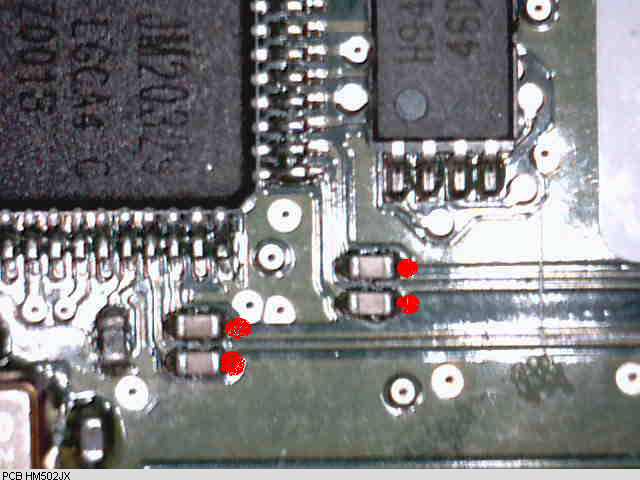

May 16th, 2012, 13:24
here is the picture.
The SATA cable is direct connected to the RED POINTS Tx/Rx to capacitors!
With SATA is the drive NOT DETECTED !, with USB cable is all OK!
Whats wrong ? (must i replace the capacitors and solder direct to the IC or ....)
ANY IDEA, THANKS FOR HELP !
May 16th, 2012, 16:53
You need to remove the capacitors. At the moment there are two SATA controllers trying to communicate with your drive -- the one in the Initio chip, and the one on your computer's motherboard. Removing the capacitors disconnects the Initio IC.

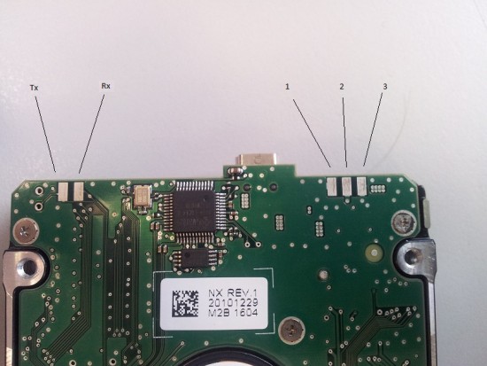

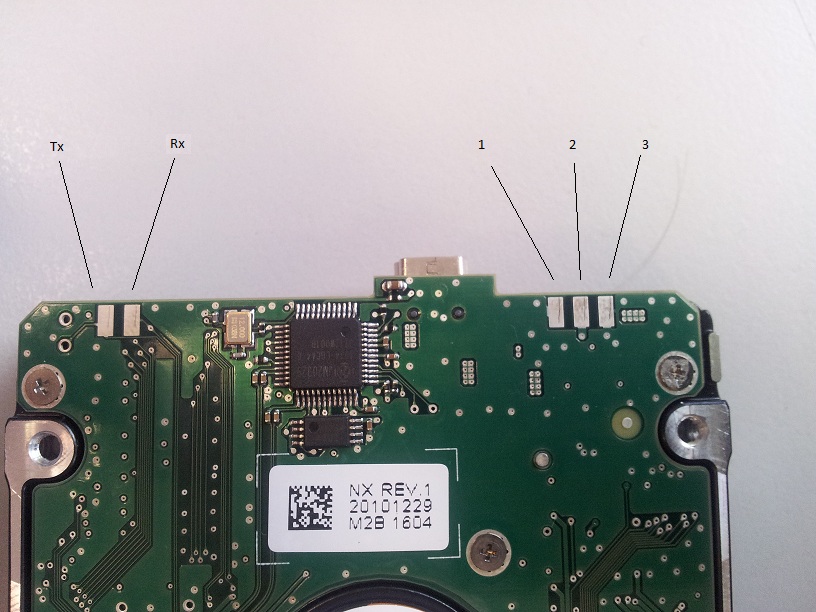

June 12th, 2012, 9:57
Hello, just joined.
Site looks good!
My story:
Samsung HM502JX with an issue. don't know exactly,
No power > pins a bit damaged > repaired still no power
Client says that for a while they needed to "wiggle" connector to get it to work.
Don't have access to good soldering abilities and don't want to remove capacitors yet.
As per picture attached and based on what has been said he so far, could someone identify what 1, 2, 3 are for?
+/-5 GND?
Samsung what are 1 2 and 3
June 29th, 2012, 14:38
mande01 wrote:Hello, just joined.
Site looks good!
My story:
+/-5 GND?
Hi everybody,
I got my Samsung HM502JX powered! So, 1,3 are for GND and 2 is for +5V.

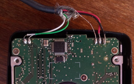

July 28th, 2012, 9:50
PLEASE, I NEED YOUR HELP
zhelana did you get ? How was your solder?
mande01 And you ?
Look at my solder:
I've tried reversing the wires GND and the TX and RX, but still not working and I see this message:
What is the TX and RX wire? green or white.?

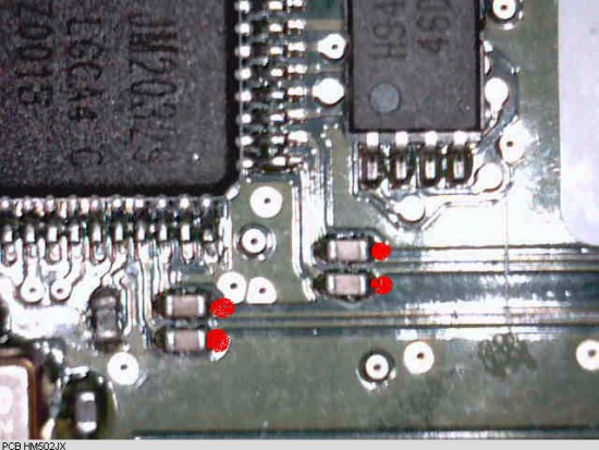

August 13th, 2012, 14:33
fzabkar wrote:Connect the Rx and Tx points to a SATA connector according to the following pinout:
http://pinouts.ru/HD/serialATA_pinout.shtml
Remove the four coupling capacitors near the JMicron bridge chip.
Hi fzabkar, I followed your instructions letter by letter.
The HDD is powered through USB, I removed the capacitors and connected the respective TX RX wires of the SATA cable to the IC according to your advice.
I checked continuity with a multimeter and it's fine and there isn't any short circuit.
The HDD spins but nothing happens when I turn on the computer, Windows doesn't see my SATA connection.
Am I missing anything?

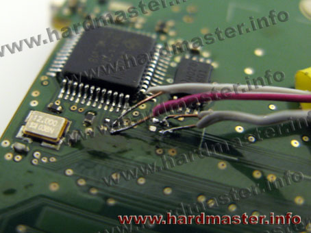

Can you not solder a new usb connector or are the tracks damaged?
DIAGS4711 pic (remove the 4 capacitors)
http://www.hardmaster.info/news11/27-03-2011.html
http://translate.google.co.uk/translate ... CCUQ7gEwAA translated
USB connector pinout http://pinouts.ru/Slots/USB_pinout.shtml
A bit of R&D to work out which is D+, D-, 5v & earth on the pcb

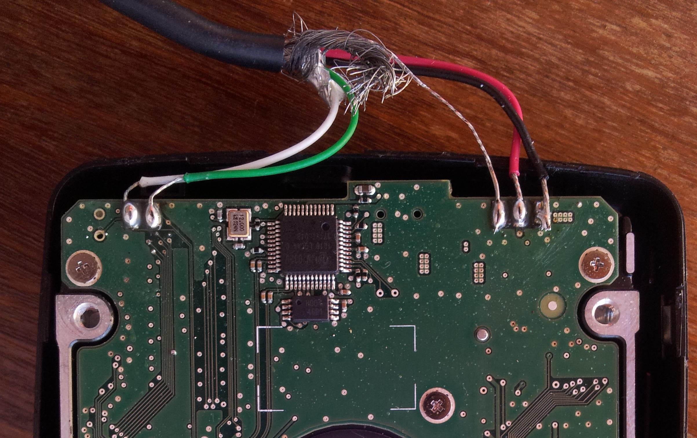

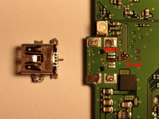

October 6th, 2012, 5:03
dadoo63 wrote:Thanks for your reply
I cannot solder a new usb connector in place of the one broken. I've already seen the links you gave but it didn't help me and I don't want to replace by a sata connector :s
I don't really know how to repair it now :(
I've find a way to make it working temporarely.
I've solder the power like on hadner's screenshot
and I've solder the TX/RX like that :
When I connect the HDD, it works and I can recover my datas but regularely it fails, I just have to unplug and plug again.
Thank you all for your help ;)
