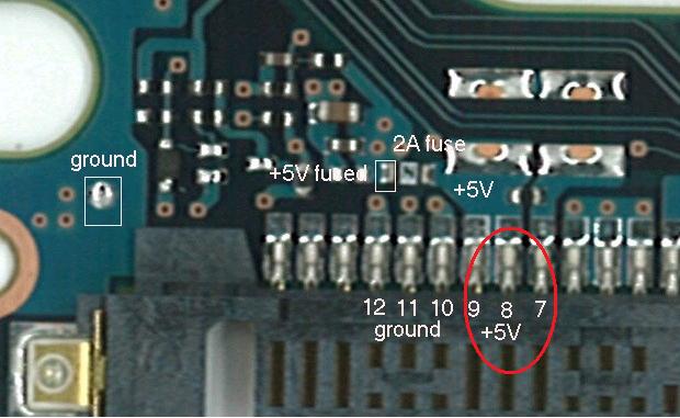

Thanks nande, but how can I tell if the fuse N is open or not? Can I swap the fuse N from the donar PCB?
For the Marvell MCU, I found that the model 88i6735A-BAN1 is the same as the donor PCB, but the next line the original MCU FP18561A is different from the donor PCB. I don't know if it affects the recognization of the HD device in BIOS
Measure the resistance of the fuse with a multimeter.

The fuse N is open. I have compared it with the new PCB. So can I just short the fuse ?

Measure the resistance between each side of the fuse and circuit ground. Compare it against your new PCB. If there is a low resistance, then this would suggest that another component is damaged.

yes, the new PCB have very low resistance.

yes, it's about 0.13Ohm

I think you may have misunderstood me. Measure the resistance between the test point labelled "+5V fused" and any point marked "ground", eg pins 12 and 10 of the SATA power connector, or the ground plane on the left. Compare these measurements with your good board.
See http://www.users.on.net/~fzabkar/HDD/MHW2080BH_fuse.jpg

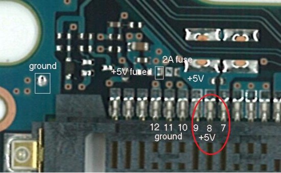

the +5V pin 9,8,7 doesn't show any resistance with the ground on the old board.

It means there is something wrong with your old pcb. Easiest fix is to swap the ROM of your bad pcb to the new pcb.

You are correct, but the donor PCB MCU is different from the original PCB
The donor PCB
88i6735A-BAN1
FP18S61
The original PCB MCU is
88i6735A-BAN1
FP18S61A
If I swap the Rom, will it work? I don't know if the different MCU will destroy the harddisk data.

Check both PCB, if the same B10x marked on pcb then it should be ok to ROM swap.

I have found someone to perform the soldering work for me. The data is able to read now.
