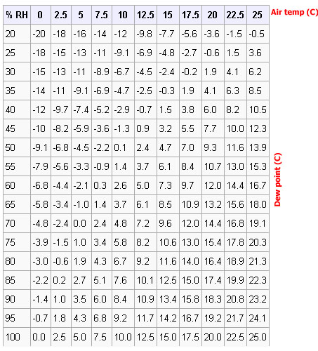

PostPosted: April 13th, 2010, 0:56
Joined: January 6th, 2010, 7:38
Posts: 72
Doomer, whilst what you say about AP and AH are true, they are of much less concern than the change in RH for a given change in temp.
Over a temp range of 30 - 0c, there is about 10% change in AP, but about 80% change in RH.
For this same reason, DP and the formation of ice or frost [if DP is 0c or less] is largely independent of rate of temp change.
A 10% change in AP has only very minor effect on DP.
It really, [simply put] depends on what the initial RH is inside the drive which will determine the DP or FP temp.

PostPosted: April 13th, 2010, 14:22
Posts: 3598
Location: Chicago
That's why there is silica gel granules in the breathe filter and sometimes in recirculation filter
BTW I attached DP table for everybody who may be interested in it
File comment: Dew point table
