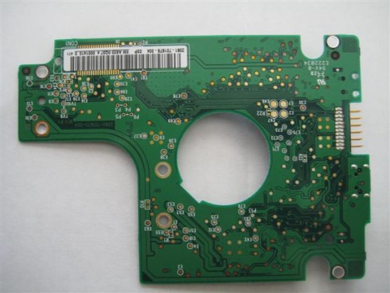

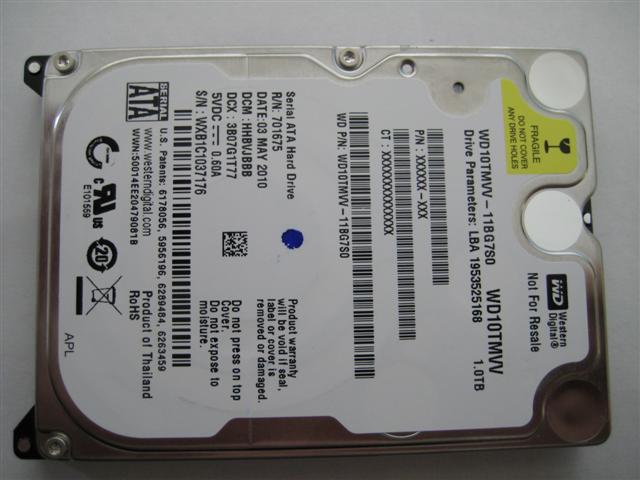

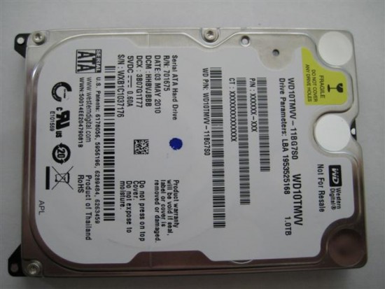

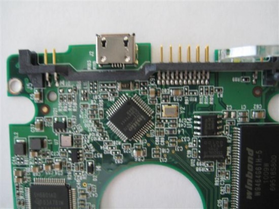

Here are the photos of mine:-
PS the disk is spinning, there's a quiet click, but i don't think it is a bad click at this stage (think i'm trying to too hard to hear noise). Windows does not see anything attached at all, not even in unrecognised device.

This drive has a micro USB connector. The pinout for USB is easy. The important thing is the OS is not recognizing this device. Most likely the USB IC is at fault. Even if the drive had issues with the HDA the USB should recognize in the OS. I can not read the part number of the IC closest to the USB connector. Maybe you could post the details. Also I think there is the standard ROM next to the big SDRAM IC. So a new PCB and ROM swap may work.

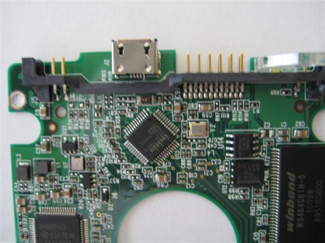

The bridge chip appears to be an Initio INIC-1607E. I can't see all the part numbers, but the ROM may be attached to the bridge rather than to the MCU.
The fact that the USB chip does not identify itself to the OS is inconclusive. Some bridges need to see a hard drive before they will ID themselves.
I would verify that the oscillator is running, and that the 3.3V (?) supply is present. Then disconnect the serial EEPROM's data or clock pin, and verify that the bridge chip identifies itself with Initio's Vendor ID and Product ID. Unless the chip is a specially masked run for WD, the external ROM will have WD's Vendor and Product IDs.

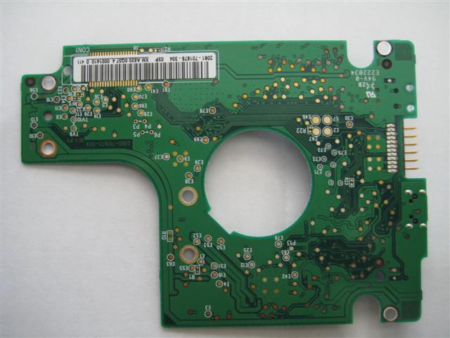

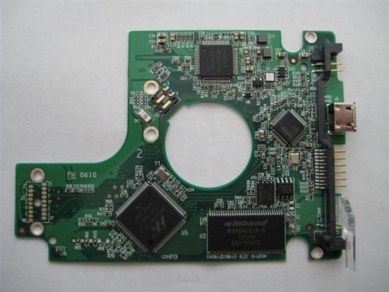

I'm interested in exploring the pinout if you are, but I would like to see a clear, detailed photo of both sides of the PCB.
From what I have been able to make out from the photo in the following thread, several of the header pins go to the serial EEPROM that is associated with the INIC-1607E bridge chip.
viewtopic.php?f=1&t=16838
It should be very easy to at least find out where the other pins go, but determining their function may require just a little more effort. :-)

numerobis wrote:
I don't know what "information" you want to get for your help ...
I only want a detailed photo. :-)
May be this will help?
Solution with decrypting (Initio chip is present) is very simple.
Angel Data Recovery

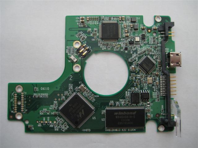

Thanks DR-Kiev. Am I right in assuming that the 5th wire connects controller ground to HD ground?
In fact this SATA "pinout" is relatively straightforward to determine. You don't need to be an Einstein or a "guru" to work it out. ;-)
All you need to look for are two thin parallel pairs of traces, probably capacitively coupled, running between the bridge chip and the MCU. These will be the Tx/Rx pairs.
As for the order of the pins, one would expect that the physical positions of the pins on the bridge chip and the MCU would be in the same order as the SATA connector on a SATA HD. This would facilitate an orderly PCB layout (imagine a SATA connector intercepting the Tx/Rx pairs). If this doesn't work, then you would try the reverse order, for those cases where the chips are on the reverse side of the board. If neither works, then there are still 6 additional permutations.
One other concern would be whether simply tapping into the SATA traces creates a double termination. Even removing the coupling capacitors would still leave reflective stubs. Whether this significantly impairs data communications would be something to consider. Still one more concern would be whether the bridge could be held in the reset state, to keep it quiet during data transfers.
As for the 12-pin header, einstein's statement that "there is a special pinout connection for this drive which can be done and converted to sata" was ambiguous in that it suggested he had gained SATA access via the header. AFAICT from the available photos, there are no thin parallel traces terminating at the header, so SATA access is unlikely.
However, in another thread, I observed a trace from pin 6 of the bridge's EEPROM chip heading out to the header, after passing through a series resistor, R97. Although R97 was not populated, it appeared, in the absence of a clearer photo, that the header provided access to the EEPROM, or to the bridge.
In retrospect, it also makes sense that the SATA test points are consecutively numbered.
