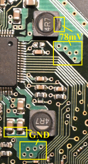

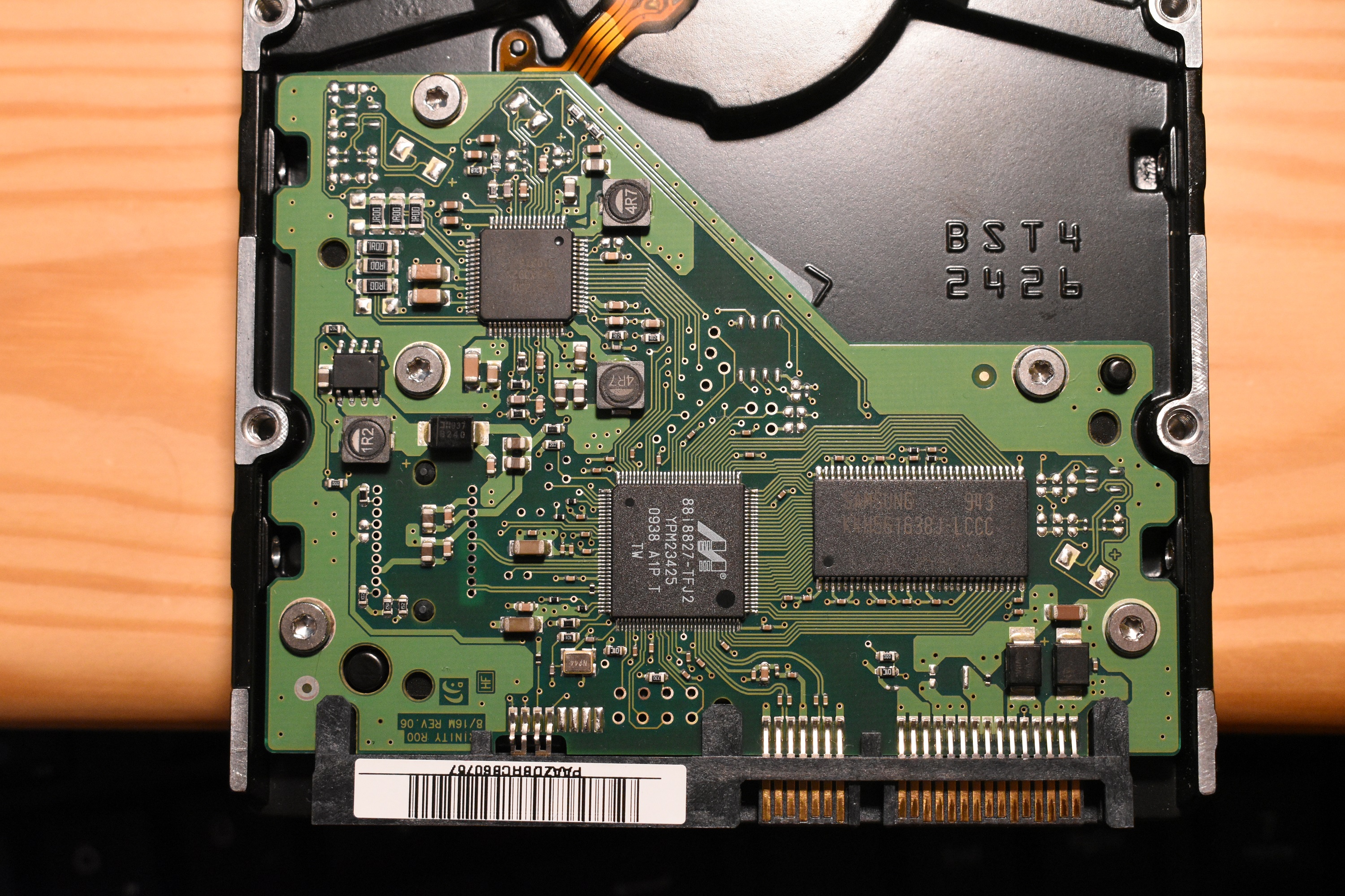

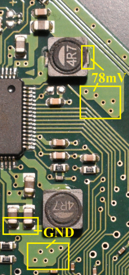

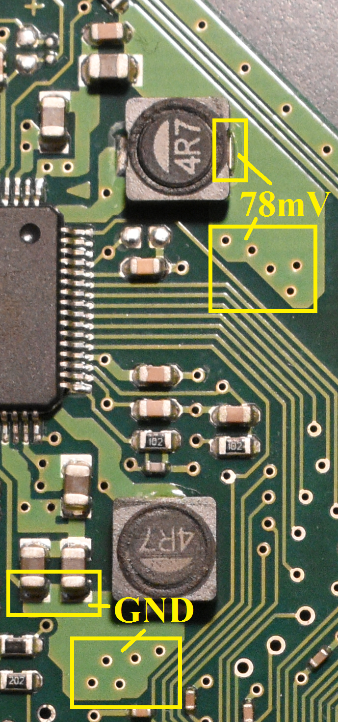

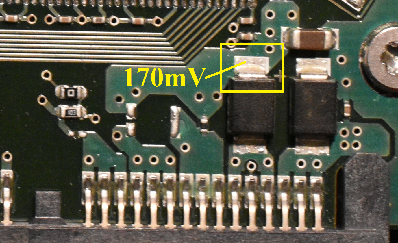

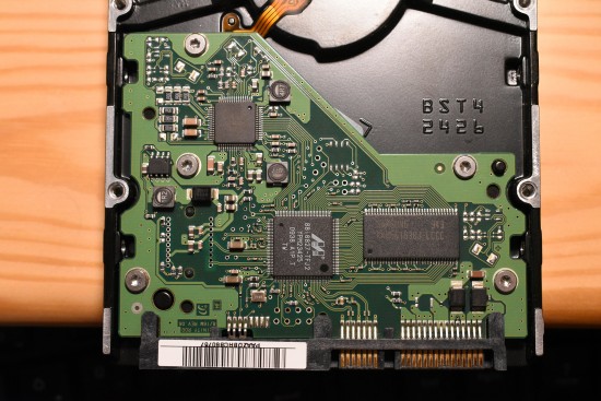

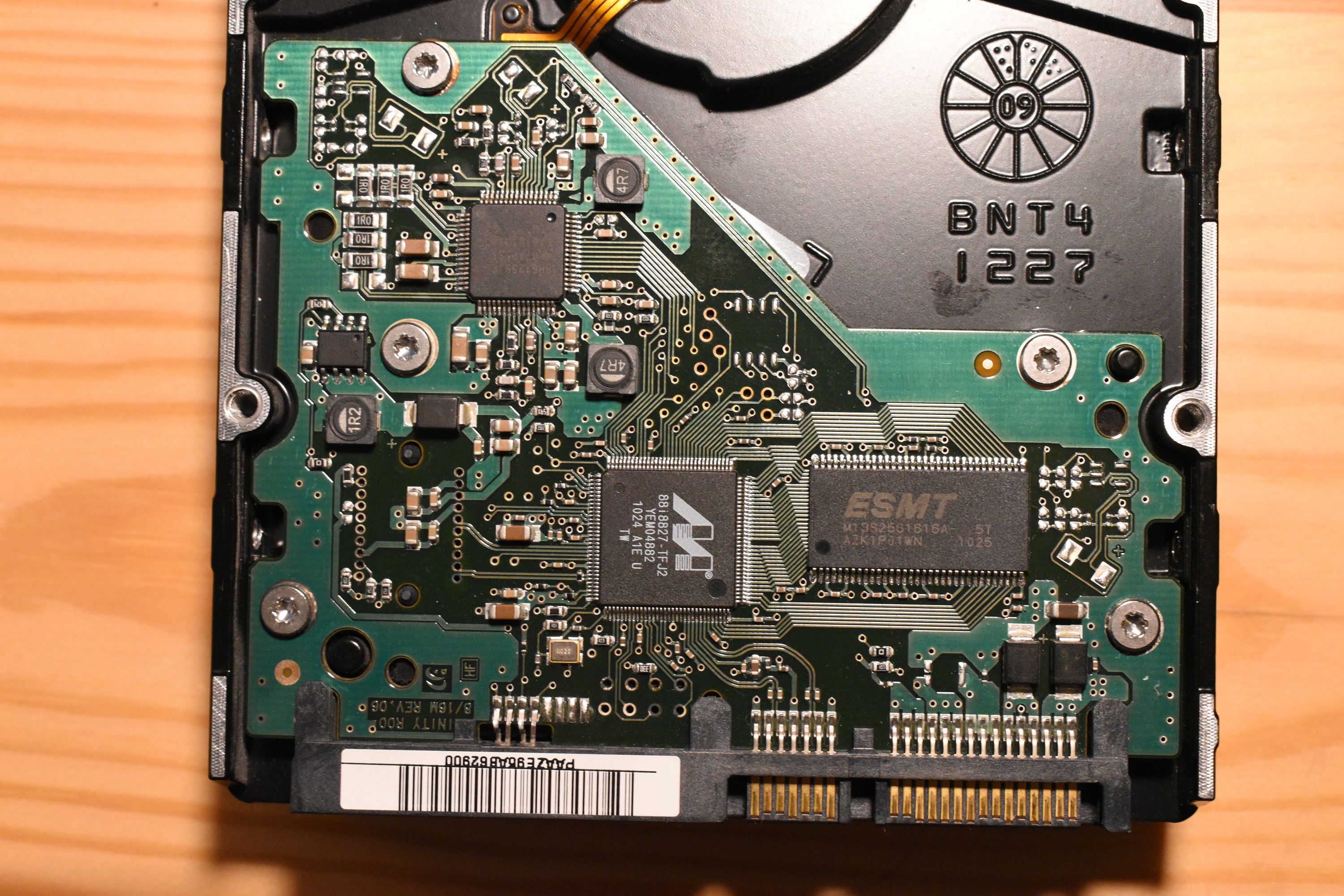

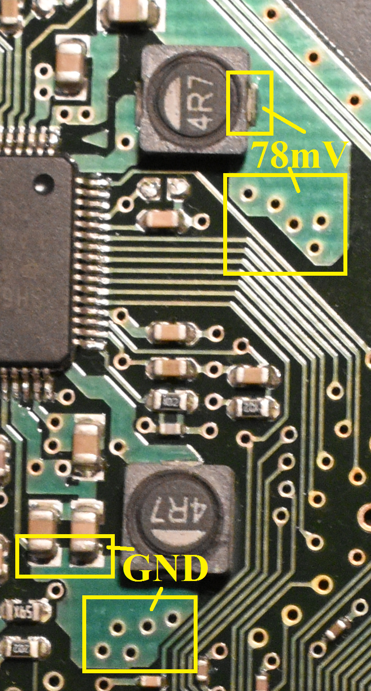

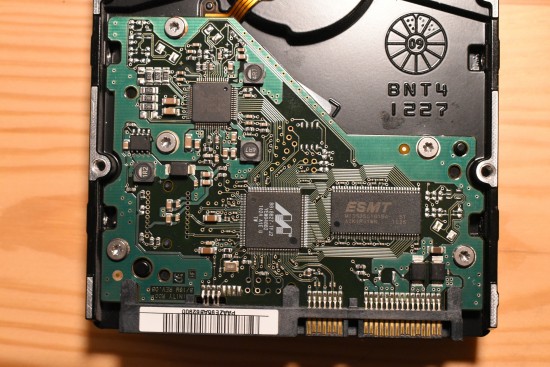

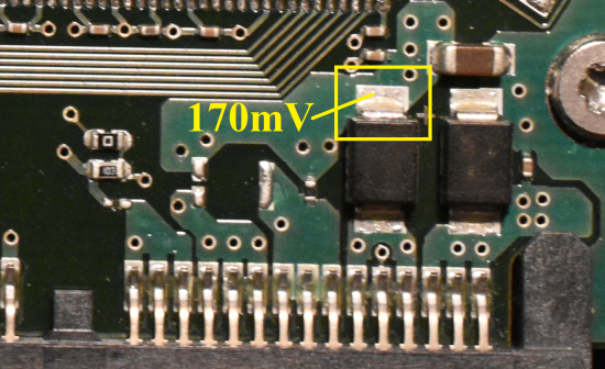

Hello Guys,
I have two bad HD154UI. The power lines of my CM case's HDD bay were swapped. so both of them got 12V to their 5V line. I have checked the diodes, they have a couple of MOhm resistance, I assumed they are fine. I have also checked the fuse next to the 5V diode, it has a few Ohms, so it seems fine too. I have made the measurements, fzabkar proposed.
Please help!
Thanks,
zsedro

File comment: HDD2 PCB

File comment: HDD1 PCB
 Post subject: Re: Replacing PCB diode question - Samsung HD154UI
PostPosted: December 10th, 2016, 14:56
Posts: 17228

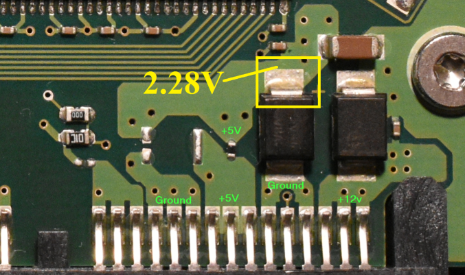

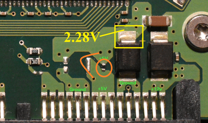

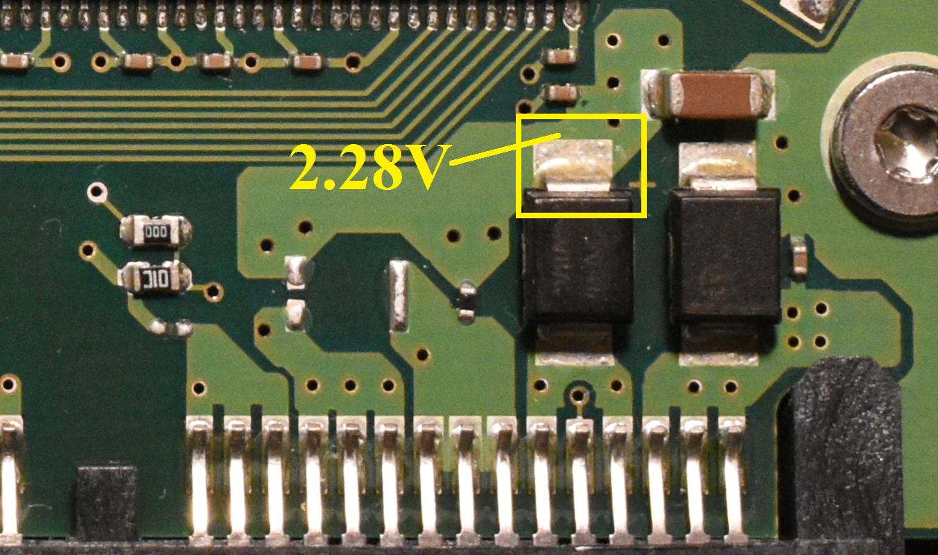

@zsedro, your voltage measurements would suggest that there is a problem with your PSU, the 5V fuse, or your measurement technique.

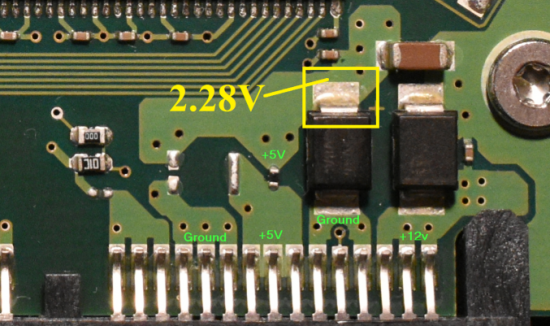

@fzabkar, first, I had measured with an external sata-usb adapter, which has its own psu, now, I did a similar measurement with my pc's psu and also with another mutlimeter. I have got similar results. I have got everything you showed (the sata pinout:gnd-5v-gdn-12v), but not the 5v at the diode. I used a screw as ground and I measured at the small holes and also at the leg of the diode. Can it be the capacitor, or can it be the 5v diode? What is your suggestion?
PostPosted: December 10th, 2016, 15:39
Posts: 17228
The "fuse" must be open or high resistance.

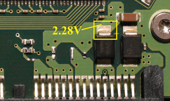

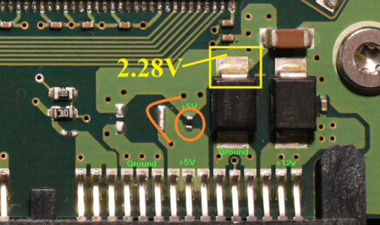

You mean this spot (circled)? I measured closed in between the two holes connected with the line on the image.

Posts: 17228
There cannot be a potential difference across a short. :?
Perhaps the "fuse" is a resettable type that returns to zero ohms after power is removed?
Could there be a "dynamic" overload? What is the resistance between ground and each of the Vio and Vcore test points (at the coils)?
Are you testing the PCB off the drive (preferable)?

You are absolutely right, sorry. The "short" was 140 Ohms and 70 Ohms for the two drives (measured with the fixed range multimeter @200), I was just stupid enough to use my multimeter's short circuit detector feature. I was measuring everything up until now with the board on the drive. At the coils, I measured 1.2 KOhms and 60 Ohms to the ground.

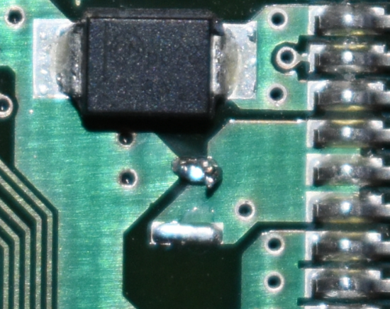

A load resistance of 60 ohms is probably OK for the Vcore supply. I'm surprised that the 5V TVS diodes survived after the fuses were stressed. Good luck with the repairs.

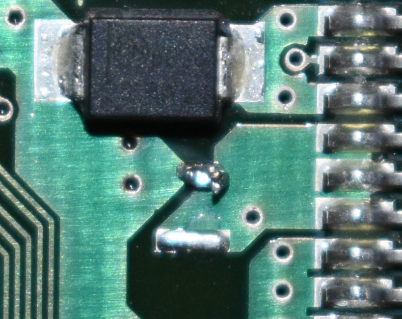

Thank you very much fzabkar! :D I did the fix today (I have put a blob on the fuses), and it works like a charm! God bless you, man! It could have taken weeks and $500 to ask a company to fix this problem for me. Do you have any paypal, or any page, where people can donate you?
