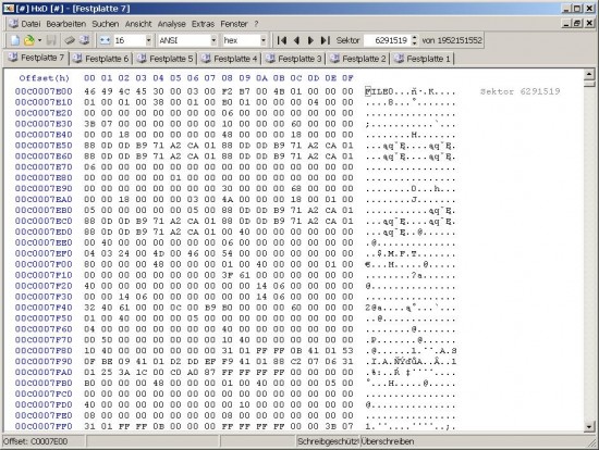

 Post subject: Re: after partition recovery windows shows raw file system?!
PostPosted: December 15th, 2010, 16:49
Posts: 17249
disaster wrote:
One other sector you could check is the backup boot sector at LBA 0x745B44EA (= 1952138474 in decimal). The contents of this sector should match sector 63.
They appear identical. You can make the comparison easier by copying the sector data to a file, and then using the File Compare command in a Windows DOS box, ie ...
fc /b sector_63.txt sector_1952138474.txt
The next sectors to compare would be the $MFT starting cluster (0x000C0000) and the starting cluster of the $MFTMirror (0x0745B44A). The volume has 8 sectors per cluster, so the logical starting sectors numbers are 0x600000 and 0x3A2DA250, respectively. Add 0x3F (= 63) to the logical sector numbers to obtain the physical LBAs. This places the $MFT and $MFTMirror starting LBAs at 0x60003F (= 6291519) and 0x3A2DA28F (= 976069263), respectively.
Hopefully my calculations and reasoning are correct. If so, then you should see the beginning of the $MFT metadata at the abovementioned sectors. Examine the next 7 sectors to see the entire cluster.

The $MFTMirror if your calculations are correct for starting sector (976069263) all 7 sectors are filled with 00-s!
How does this effect the filesystem/partition recognition by windows?

What does sector 6291519 look like?
BTW, a cluster consists of 8 sectors (the starting sector plus the next 7). Just to confirm, are you saying that sector 976069263 plus the next 7 sectors contain all zeros?
I will attach the pic soon.
Yes, thats right.
PostPosted: December 18th, 2010, 6:05
Joined: December 10th, 2010, 3:25
Posts: 27
Sorry, this is weird. Unfortunatelly I did not make a log previous, but now the sectors are not full with zeros.. I dont understand. :D
6291519 (see attached)
20 zeros
21 not empty
22 zeros
23 not empty
24 zeros
25 not empty
26 zeros
976069263 same as 6291519
64 zeros
65 same as 6291521
66 zeros
67 same as 6291523
68 zeros
69 same as 6291525
70 zeros
PostPosted: December 18th, 2010, 15:45
Posts: 17249
You stated that you ran CHKDSK. If you ran it in repair mode rather than readonly mode, then perhaps it rebuilt the $MFTMirror.
Notice that at offset 0x00C0007EF2 there is a unicode text string, "$MFT". I believe you should find similar strings in the other sectors corresponding to other metafiles, eg $BADCLUS and $BITMAP.
See http://en.wikipedia.org/wiki/NTFS#Metafiles
BTW, I suspect that when CHKDSK verifies the integrity of $BITMAP, it would do so by taking a walk down the MFT and determining the clusters occupied by each file. It would build its own bitmap of free and occupied clusters, and then compare it against the $BITMAP maintained by the OS. They should be identical.
