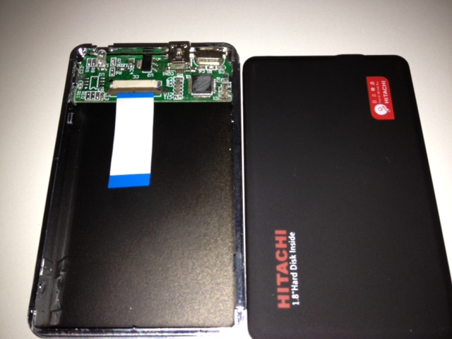

this any good to u folks - I am having a similar issue - my problem with this is that it is too narrow not too wide but the pins match with my Toshiba SSD
24 Pin LIF HDD to 22 Pin SATA Adapter Card
http://www.ebay.co.uk/itm/24-Pin-LIF-HD ... 35c1775706

Very difficult I found my http://www.drivestar.biz this site and it worked well for me
Luiz
