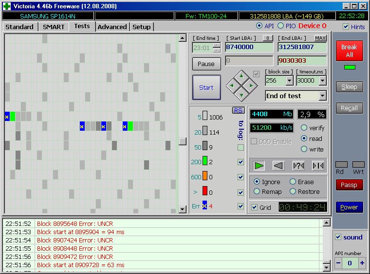

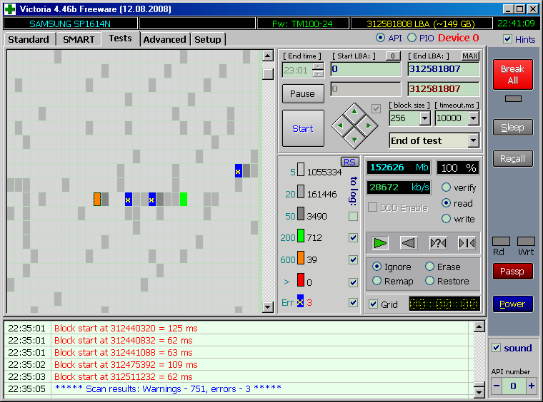

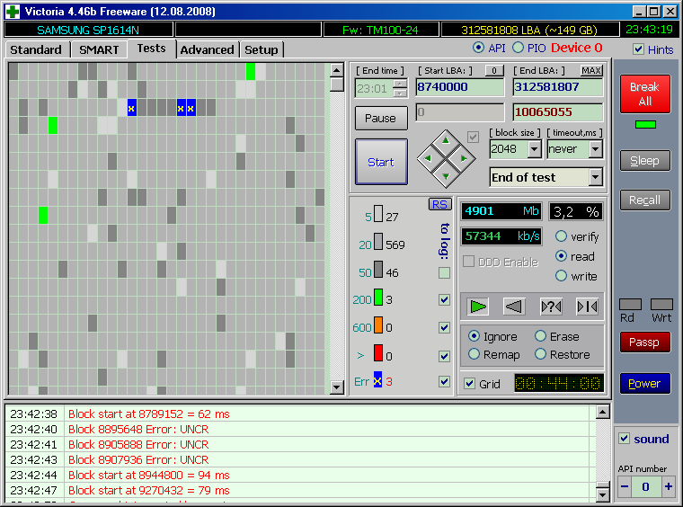

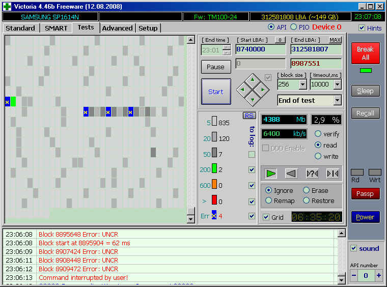

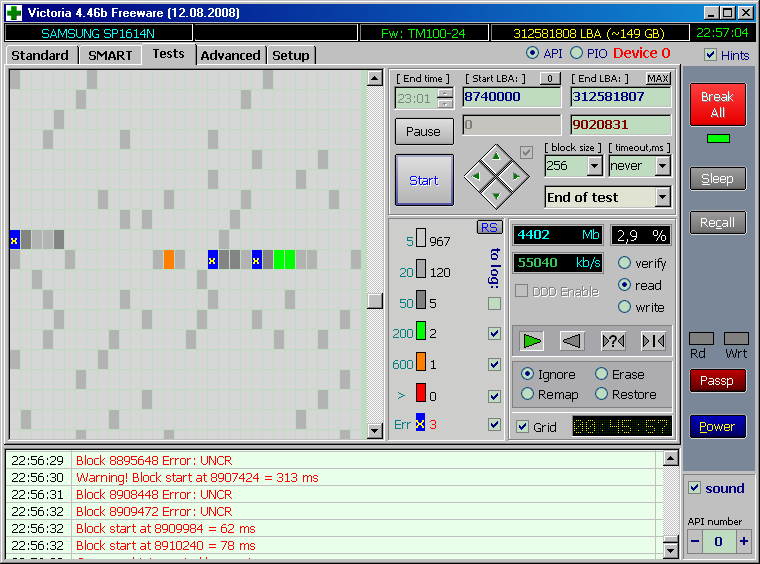

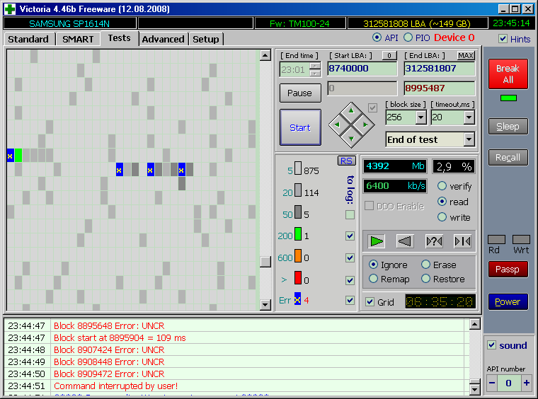

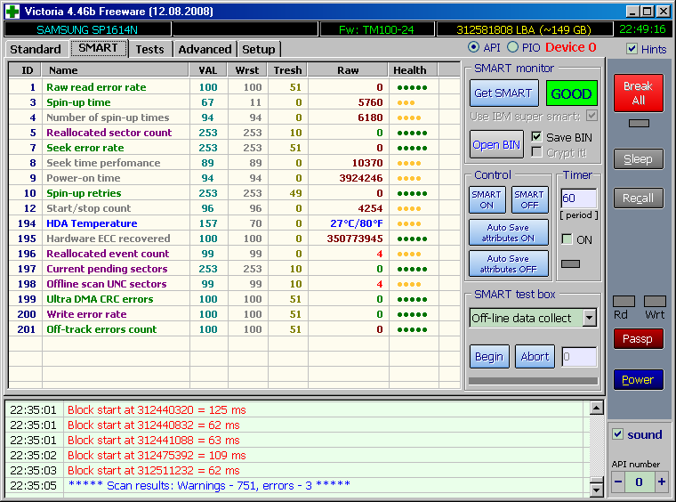

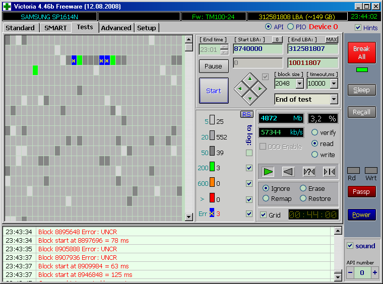

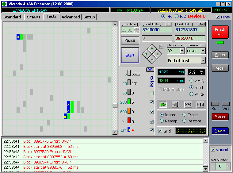

I tested Samsung SP1614N also with Victoria.
The results are not always the same even for bad blocks (even when the options in the software were not changed).
Setting timeout to 'never' did not change anything.
Running something in the background will corrupt the results - when I opened 3 MB pdf file at the same time when the scan was running it caused some extra dark grey and green blocks to appear.
So my conclusion is that such testing software, which has to be run in Windows will never give reliable results regarding surface map access times.
Hence, IMHO MHDD, which has to be run in DOS should give the truest results (if run from DOS and not from command line in Windows).
Victoria SP1614N bad sectors 30000 ms timeout nosn.png [ 26.64 KiB | Viewed 5761 times ]
Victoria SP1614N bad sectors timeout 10000 block size 2048 nosn.png [ 26.85 KiB | Viewed 5761 times ]
Victoria SP1614N bad sectors timeout never block size 2048 nosn.png [ 26.94 KiB | Viewed 5761 times ]
Victoria SP1614N bad sectors timeout never block size 32 nosn.png [ 26.65 KiB | Viewed 5761 times ]
Victoria SP1614N bad sectors timeout 20 block size 256 nosn.png [ 26.67 KiB | Viewed 5761 times ]

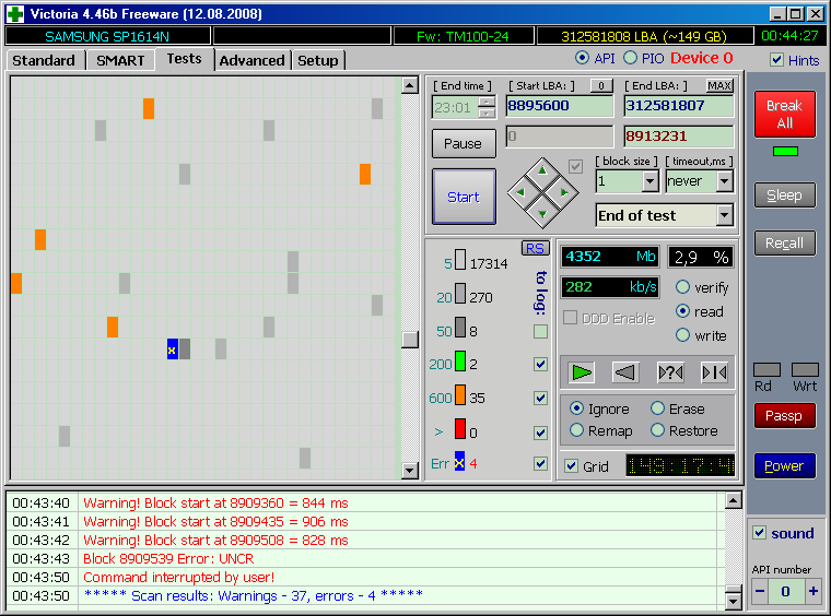

A scan with block size set to 1:
Victoria SP1614N bad sectors timeout never block size 1 nosn.png [ 26.78 KiB | Viewed 5754 times ]
Victoria SP1614N bad sectors timeout never block size 1 1.png [ 1.5 KiB | Viewed 5754 times ]
These are sequential:
Victoria SP1614N bad sectors timeout never block size 1 2.png [ 1.48 KiB | Viewed 5754 times ]
Victoria SP1614N bad sectors timeout never block size 1 3.png [ 1.46 KiB | Viewed 5754 times ]
Victoria SP1614N bad sectors timeout never block size 1 4.png [ 1.47 KiB | Viewed 5754 times ]
Victoria SP1614N bad sectors timeout never block size 1 5.png [ 1.53 KiB | Viewed 5754 times ]
Victoria SP1614N bad sectors timeout never block size 1 6.png [ 1.49 KiB | Viewed 5754 times ]
Victoria SP1614N bad sectors timeout never block size 1 7.png [ 1.52 KiB | Viewed 5754 times ]
Victoria SP1614N bad sectors timeout never block size 1 8.png [ 1.55 KiB | Viewed 5754 times ]
Victoria SP1614N bad sectors timeout never block size 1 9.png [ 1.54 KiB | Viewed 5754 times ]
