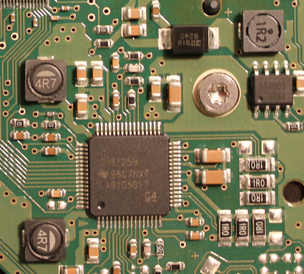

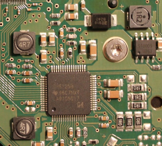

ground to V1 - 10.2
ground to V2 - 143
ground to Vneg - 116.2
Also i have attached an image of the requested area.
 Post subject: Re: Samsung HD154UI
PostPosted: February 22nd, 2011, 6:38
Posts: 17323
I presume V1 is Vcore, which would account for the low resistance. Otherwise, I can't see anything out of the ordinary. ISTM that the motor controller is dead.

The V1 V2 is exactly the way you have them in your schematic so yeah Vcore and Vio respectively.
Is there anything that can be done for that? I am aware that changing the pcb for samsung does not work out of the box...
Thanks again for troubleshooting with me and going step by step with patience. You have been really helpful and aside from the disk I learned a couple more things here !
Measure the resistance between SDRAM pin #1 and each of V1 and V2. The one that shows 0 ohms will be the Vio supply.

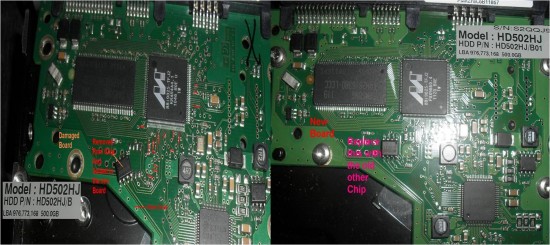

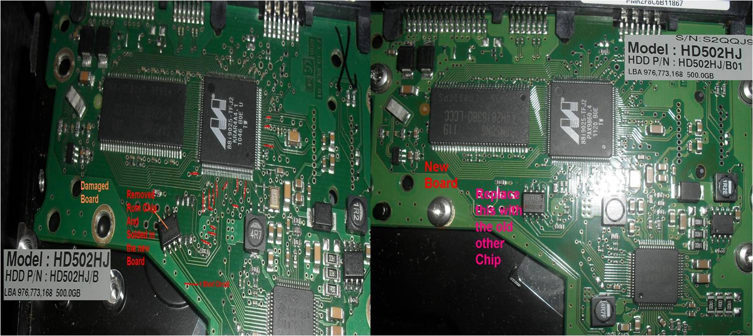

Maybe my comment is late, But thanks to all your comments I recovered a samsung hd502hj/b, I got a samsung hdj502hj/B01
and use the complete board tor eplace the bad one for the new one, I juts replaced the rom chip, and the hard disk worked fine like new, I made 3 experiments and the result were 2 damaged board, the main bad thingas was that with the pc turned off I used to connect the Hd and then I turned on the pc so the bios made a check of the board id and comparing the id with the info located in the rom chip and the data in the plate area were different so the disk stop working again and the borad got damaged again maybe for a programming included in the main rom, so after 2 new hd I decide to make the last try but inserting the hd only when the pc is turned on and inside windows remember the sata device are like usb so they are plug and play, the system detect the hd not the bios so there is no comunication between bios pc and rom hd, then the hd appeared as f and g and the folder start appearind one by one like magic thing but slowly, so I think the rom took all the info inside the disk and declared as good and original rewriting something inside on the main rom of the hd, and then I made a backu of all the need it info, I turned off the pc and then turned on with the hd conected and the bios detected the Hd normally and the acces to the hd was great like new. I hope this could help someone like it did it to me. by ht way in the picture of the bad old Board, the red lines meand diodes in short circuit

Measure the resistance of the zero ohm link ("5V fuse"):
http://www.users.on.net/~fzabkar/HDD/HD103UJ_TVS.jpg
We are testing for short circuits, so stick with the 200 ohms range.
Now, with the board powered up, measure the voltages between ground and the load sides each of the two 4R7 coils. The relevant pins appear to be the top pin of the middle coil and the left pin of the bottom coil.
Also measure the voltage at the left pin of the black diode located to the left of the 1R2 coil.
