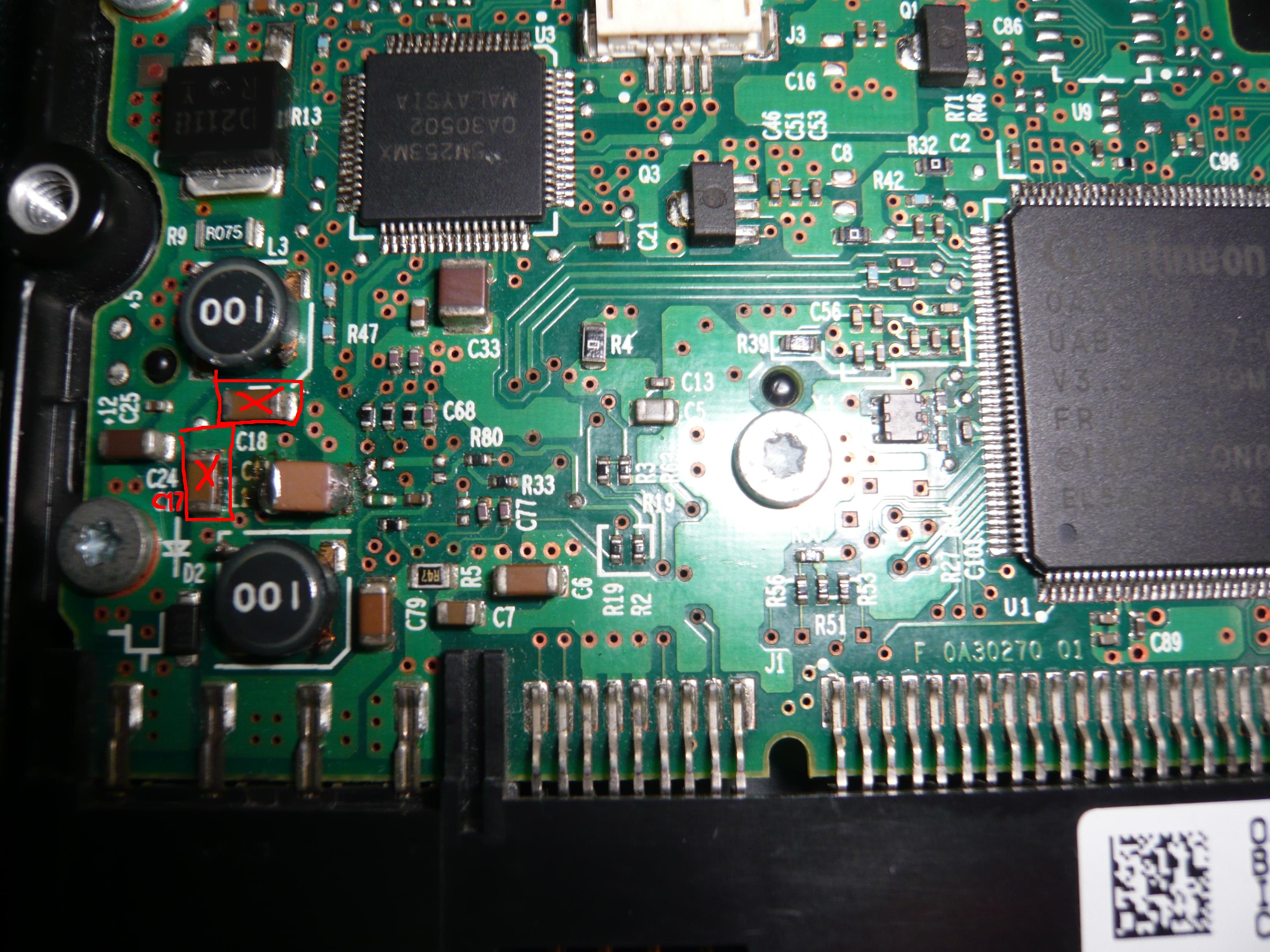

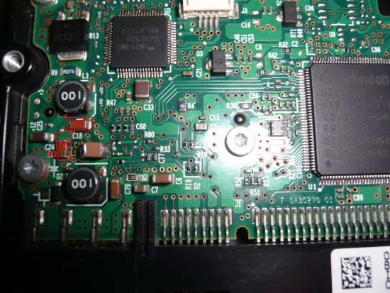

I measured and there is a C17 and C18 that it didn't give me a number on the meter. I don't know what they're for.
 Post subject: Re: Need PCB Hitachi 1TB HDD HDT721010SLA360 P/N:0A38016
PostPosted: May 25th, 2012, 21:22
Posts: 17352
danidiomas, I respectfully suggest that you do not have the skill to fix your drive. Ask your technician to swap the NVRAM, but tell him to be careful not to damage it in the process. Otherwise ask your technician to watch this thread (or your other thread).
