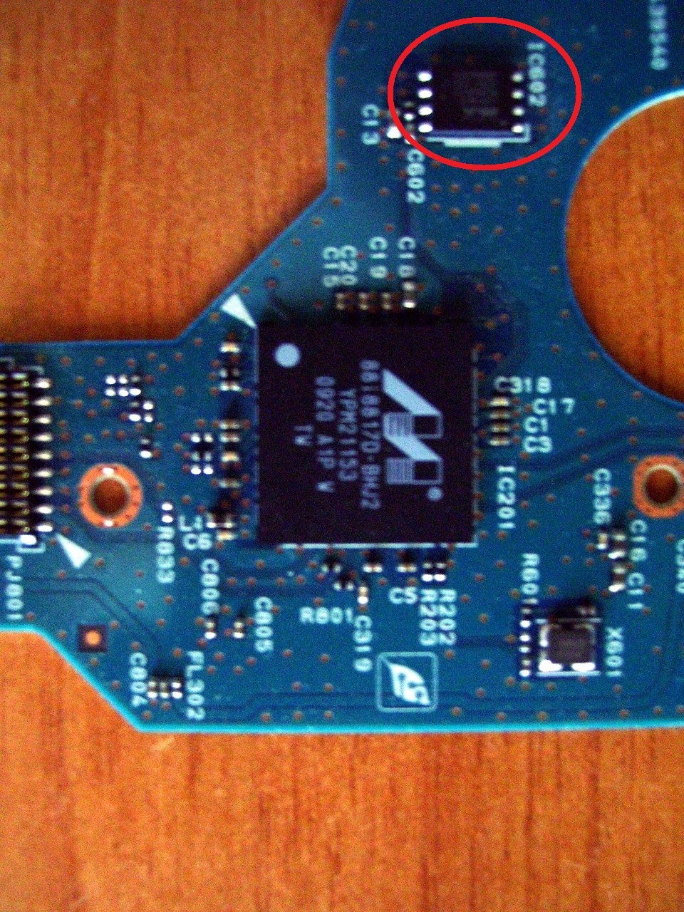

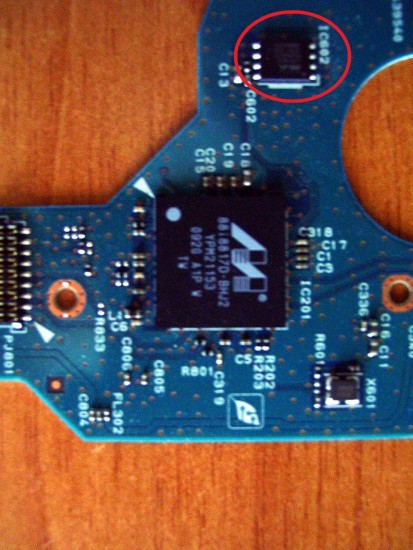

Ok guys, finally i've disassembled the HDD.
Here you are the images:
There's nothing scorched, so, whaere's the problem?? :roll:
What component i must change?
Thanks.

here you go the missing images:

Please, someone can say the component "IC602" where is located? :cry:

It should be written on the board, next to the chip.

Look here:
WTF! :evil: Thank you so much!
Now, for the transfer i must do this:
To get your data, you need:
1) Replacement PCB
2) Transfer MCU (IC602) to new board
I can buy another PCB quietly on ebay, but the component "IC602" is equal on all Toshiba PCB ALWAY belonging to the same model?
Thanks.
