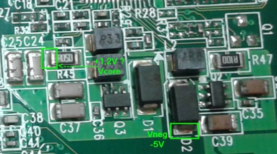

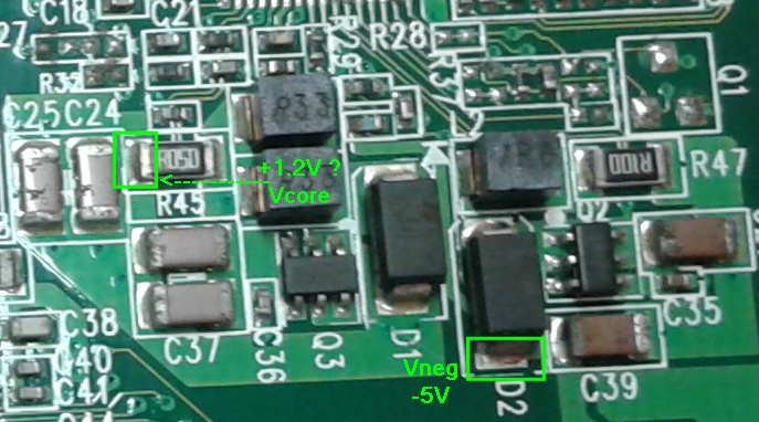

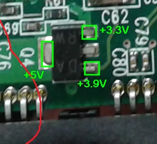

May 5th, 2016, 16:42
Measure the Vio, Vcore and Vneg voltages. Use a screw hole or SATA Ground as your 0V reference.
