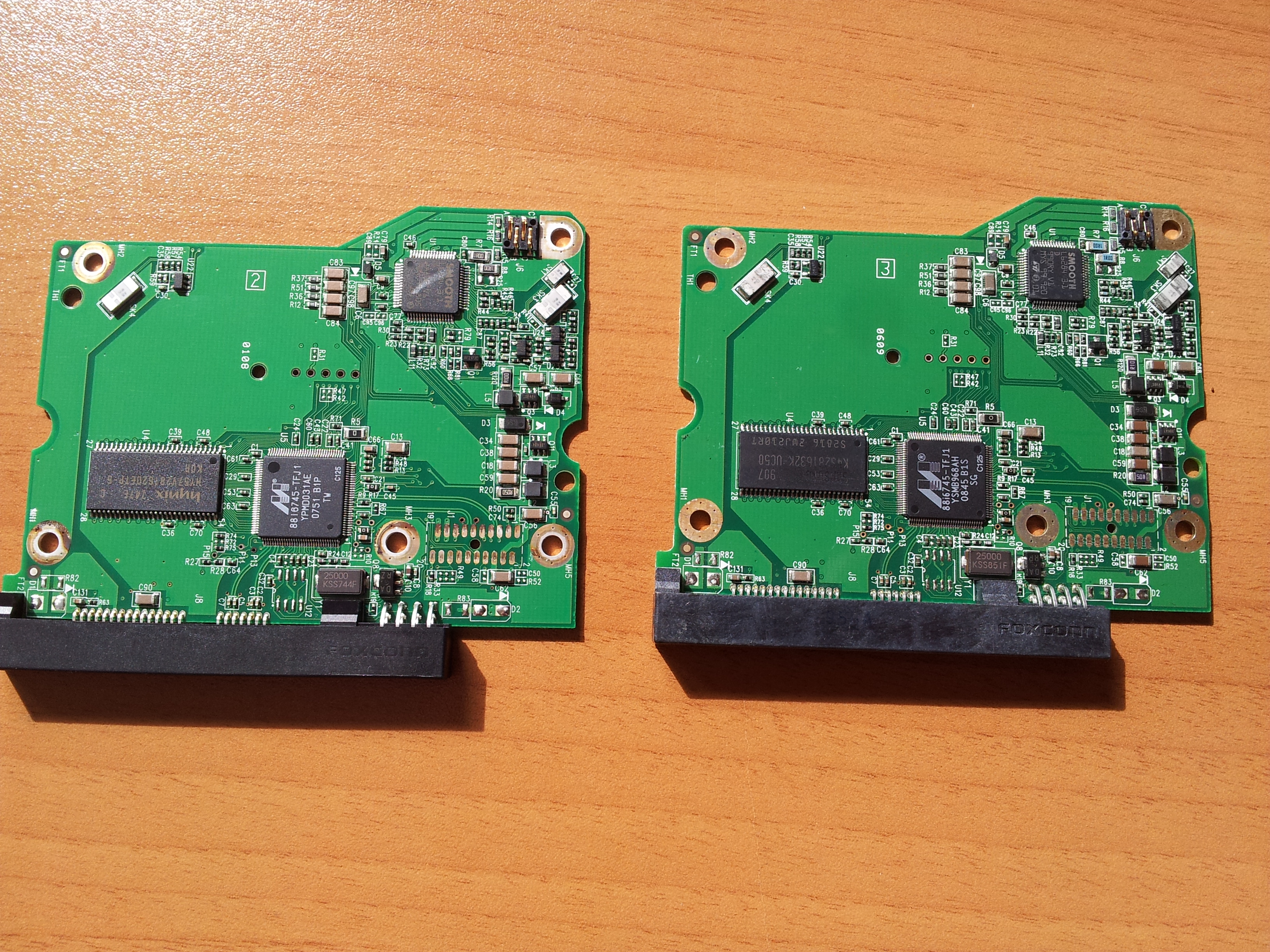

Here are the two boards.
File comment: Both Boards

Your problem report is confusing. In your first post you stated that your drive "does not spin up". This would have suggested a PCB failure.
Now you are saying that the drive spins up, works for a while, then spins down. This could still point to a PCB fault, but it could also indicate a head or media fault.
Furthermore, your PCBs have the 88i6745-TFJ1 Marvell MCU that is affected by a "head mimic" problem. I have no firsthand experience with this problem, so I can't say whether your drive's symptoms are consistent with it. In any case, the location at U12 is vacant, which means that your drive's unique "adaptive" data are stored within the MCU. In this case a "ROM" transfer won't be a simple DIY proposition.
BTW, I suspect that your drive may be one of those that does not spin up if it cannot detect a preamp. If so, then this may explain the initial no-spin symptom. However, you have since cleaned the preamp contacts (J1), so this rules out a connection issue. Nevertheless you may like to see how the drive behaves if you place some insulation tape over the preamp contacts on the PCB. Do this with your spare PCB.

Ok, fzabkar, tried using insulation tape over J1. It spun up.
So, you think that my only solution would be swapping the MCU from the Old board to the new board?
I can make that happen. Although I don't have the equipment to do that myself, I have people that have that, and know how to change chips on boards.
In your opinion, should I go and do that tomorrow?

It sounds like you may be describing a Power Up In Standby (PUIS) issue.
Does your original WD PCB have a PM2 (PUIS) jumper? If not, then perhaps the drive is configured for PUIS in the firmware. If PUIS is enabled, then you could attach the drive to a SATA port on your desktop PC, and then use HDAT2 (http://www.hdat2.com) to disable PUIS. To wake up the drive, you would need to start HDAT2 with the /w switch, as follows:
hdat2 /w
If the drive then spins up in your external enclosure, this would suggest that the USB-SATA bridge board in your original WD enclosure was responsible for spinning up the drive.

But listen to this. I thought, what the hell, I'll try the old non-functioning circuit board again. To my surprise, the drive spun up, and started working perfectly. I started to copy the data, but then it died at 2.5GB. (I still need some 38~ to go, to get the important stuff (family pictures) out).
Then I did the switch again. Used the replacement board, spun up the drive, then powered it down, and then used the original. I got another ~800MB out.
What do you guys think is wrong? Any steps that I should take?
EDIT: Ok, I tried it a third time, using the replacement board to spin it up, and then trying the original board to get it to work, but now it won't power up at all.
I have a feeling the problem is a lot simpler than what we're discussing. And I think we'll get lucky with this.
I repaired 4 drives with this exact same problem (at least the symptoms match) by reflowing ALL the connections on the board with a heat pencil. In my case the tipoff was a slight dull appearance of the solder.
The replacing and swapping of the boards is making intermittent connections on the faulty PCB sometimes work. I had observed these precise exact identical symptoms on the drives I repaired. I had blindly reflowed 3 PCB's and these 3 drives are in the field working just fine. On number 4 I got curious and took my time. I had used a microscope and dental pick to look at the solder connections. And far too many of them were "soft". The solder was almost like a thick paste that was never heated fully. All it takes is ONE intermittent connection and your drive is out of commission!
Now, I'm taking a guess here, based on what I read, that this is the issue. And if the reflow job is done carefully and gently, there's no harm done to future recovery operations. Unless you screw up the reflow and make all kinds of shorts. Then it's game over!
