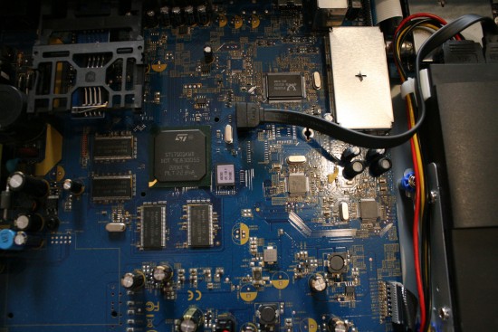

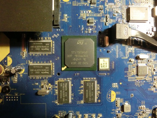

Remove the cover and read the part markings on the largest chip. It could be that Google will turn up some reverse engineering (aka hacking) experiences with boxes based on the same chip.

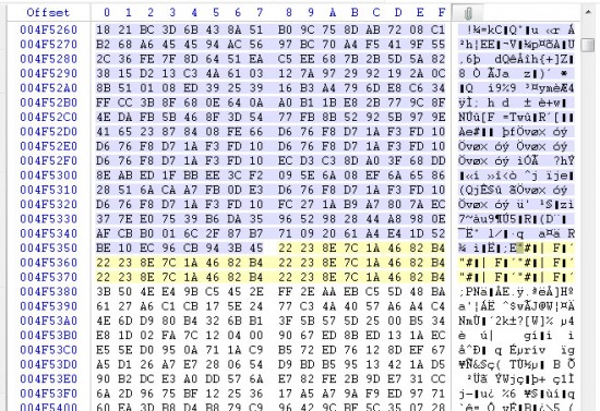

Hello.
I analyzed my HDD from CISCO 8485dbv and found some information about video.
reading the data you will notice some file names .idx .ifo .trp
then there is a lot of empty space $00
and to offset 4AA95E8 starts a data to offset 4D89218
then again, it is an empty space
and again, some data
The data given in range starred in the file dump00.trp
dump00trp file now you can play any TRP file player.
The picture shows a piece of broadcast.
It seems that the cisco broadcast divides into smaller files.
Unfortunately, without consideration of the filesystem, searching for pieces and combine them manually is a tedious.

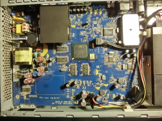

Today I tried putting an other 20 GB HDD into the DVR, but unfortunatelly, recording did not work with this HDD - I dont know why. Maybe the DVR requires its 320 GB HDD.

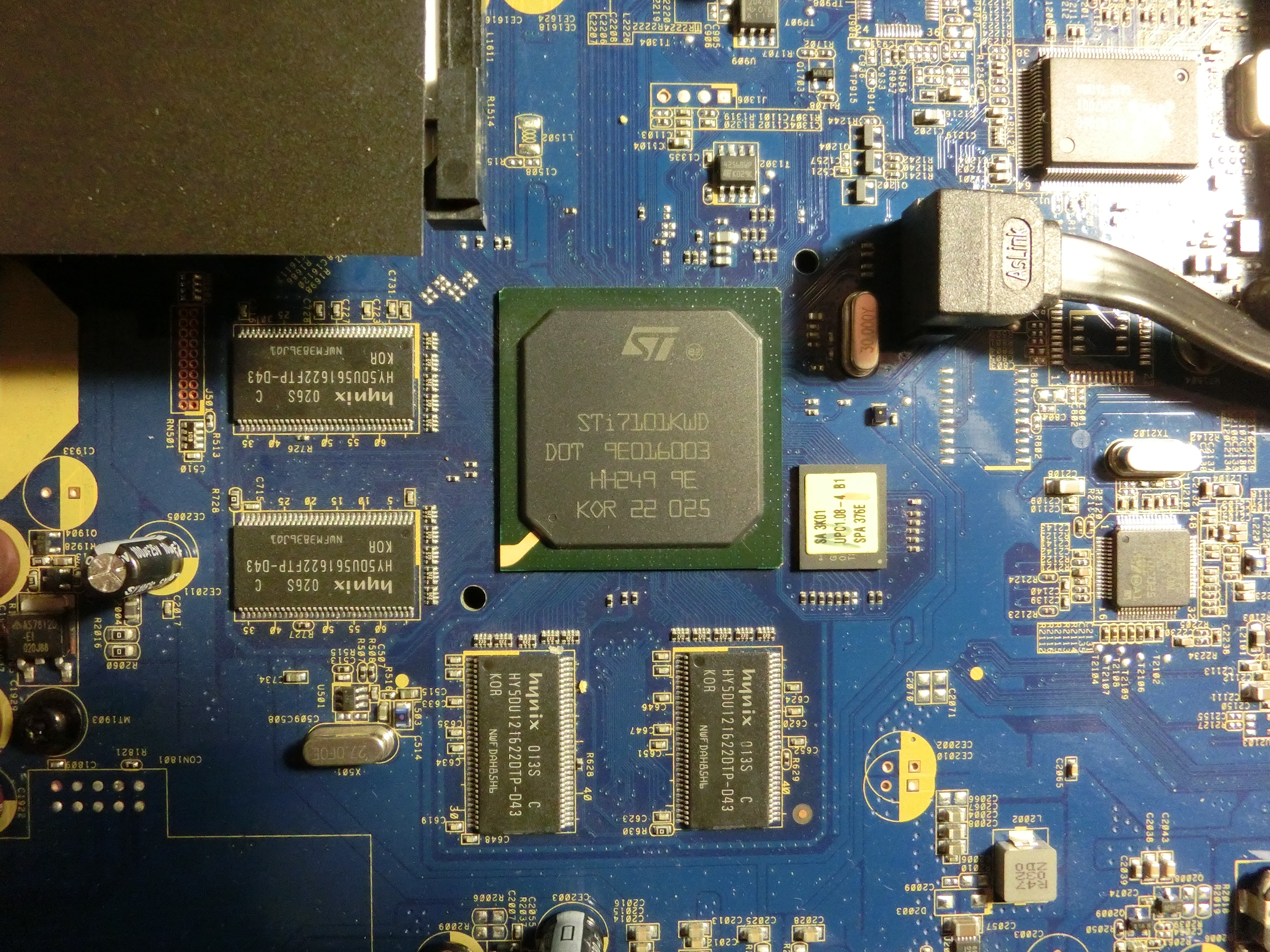

@ fzabkar: okay the biggest chip says
STi7101KWD
DOT 9E830055
220KE9E
MLT 22 848
see photo1 below.

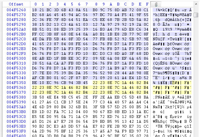

@ RadiM: man, you are great! it also worekd with my HDD. The offsets were slightly different from yours, but it worked! I saved the data between the 00000... and the "#Ž|F‚´... (which seems to be some kind of separation in this filesystem, see photo2) and extracted it into a new file with a .trp ending and I was able to play the file with Media Player Classic. It showed 10 seconds of a recording.
We are getting closer to hack this! Anybody has more ideas, how to get the full sized recordings from the HDD?
Thanks!!

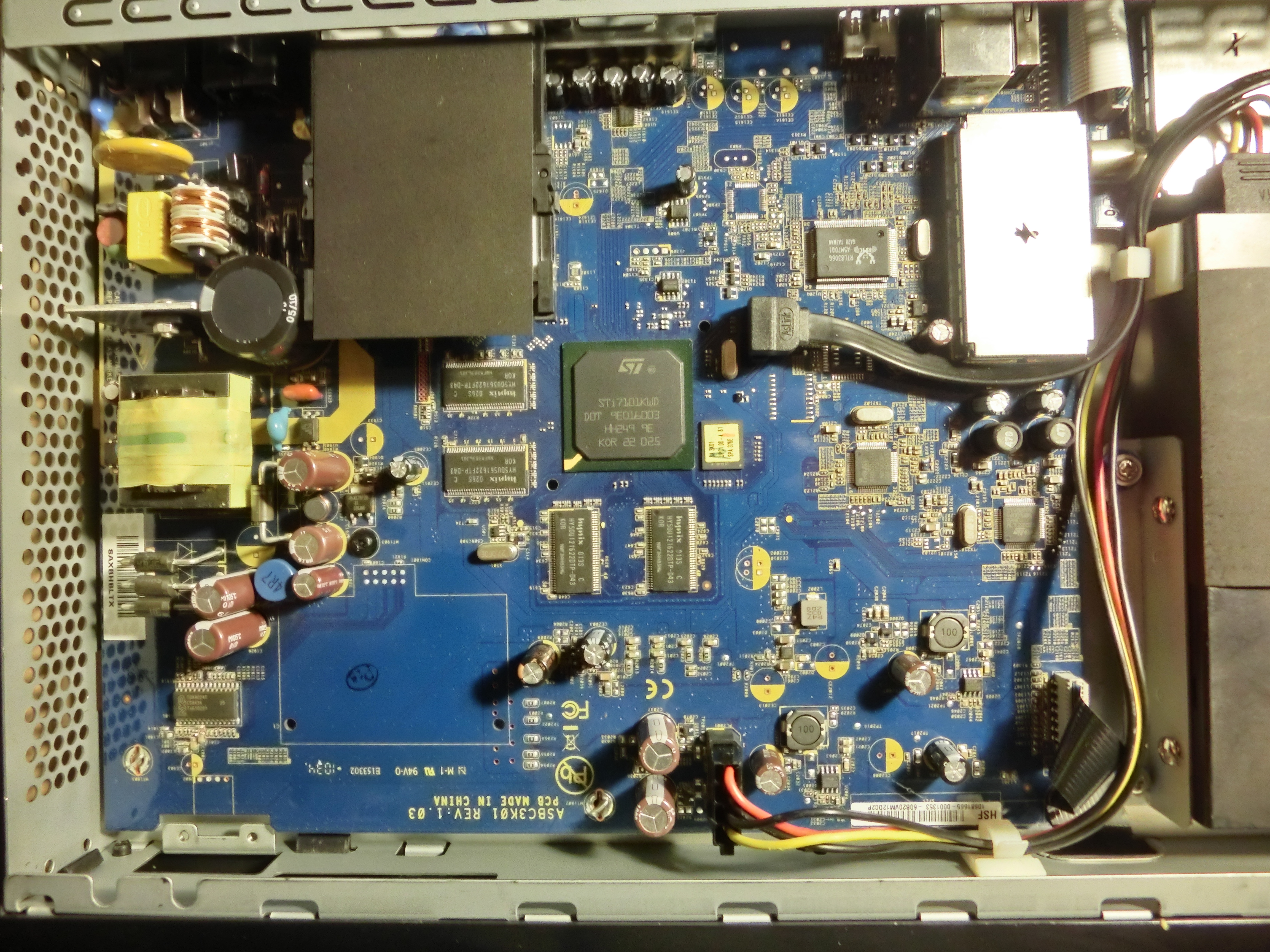

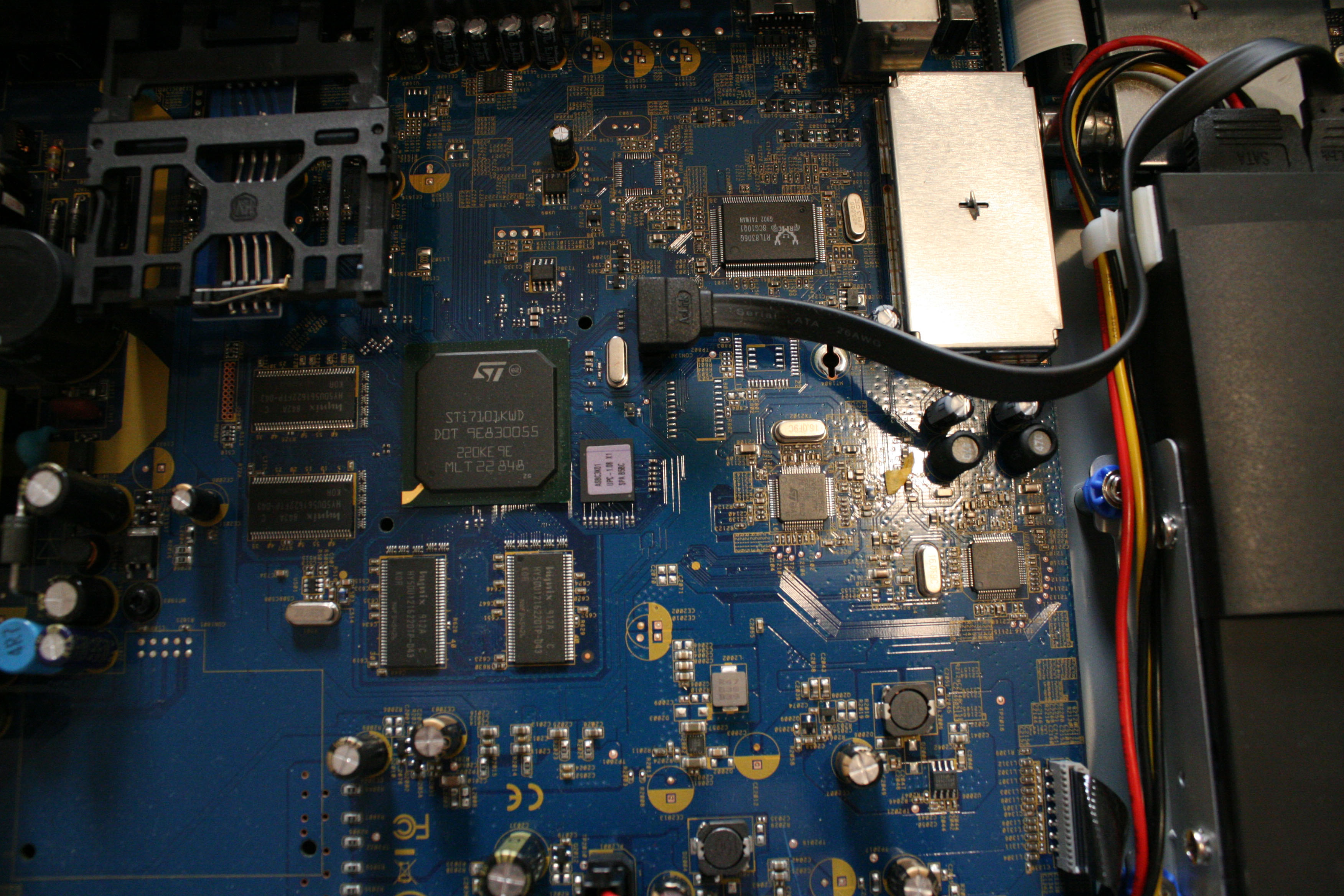

Hello
If anyone need. I added new better photos in attachment.
FW and modules from HDD from this recorder
WD3200AAJS-56B4A0
WD-WCAT1E077027
01.03A01 05.D9E
Pinnacle (Royl)
WD3200AAJS-56B4A0 from CISCO8485.rar [3.17 MiB]
Downloaded 570 times
