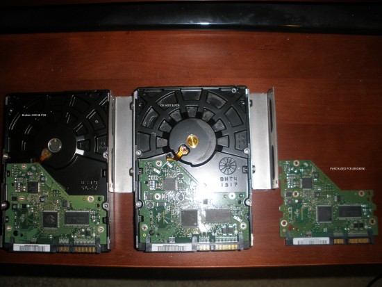

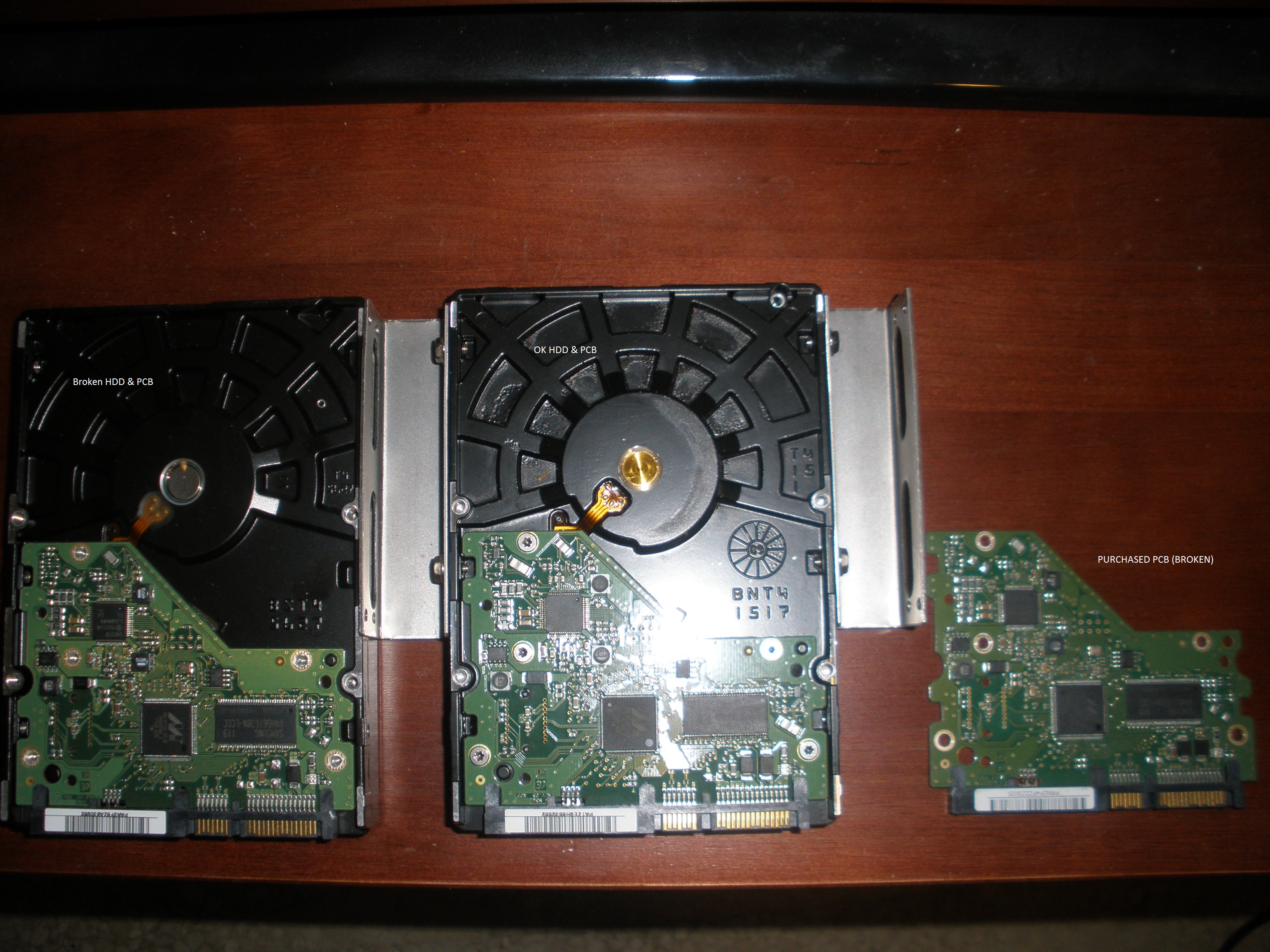

i still can't post photographs. About the purchased PCB when i place it on the damaged HDD this not spins... does not prove it that this PCB is broken? (With the PCB of my other HDD, the damaged hard disk spins)

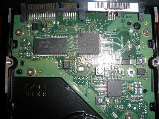

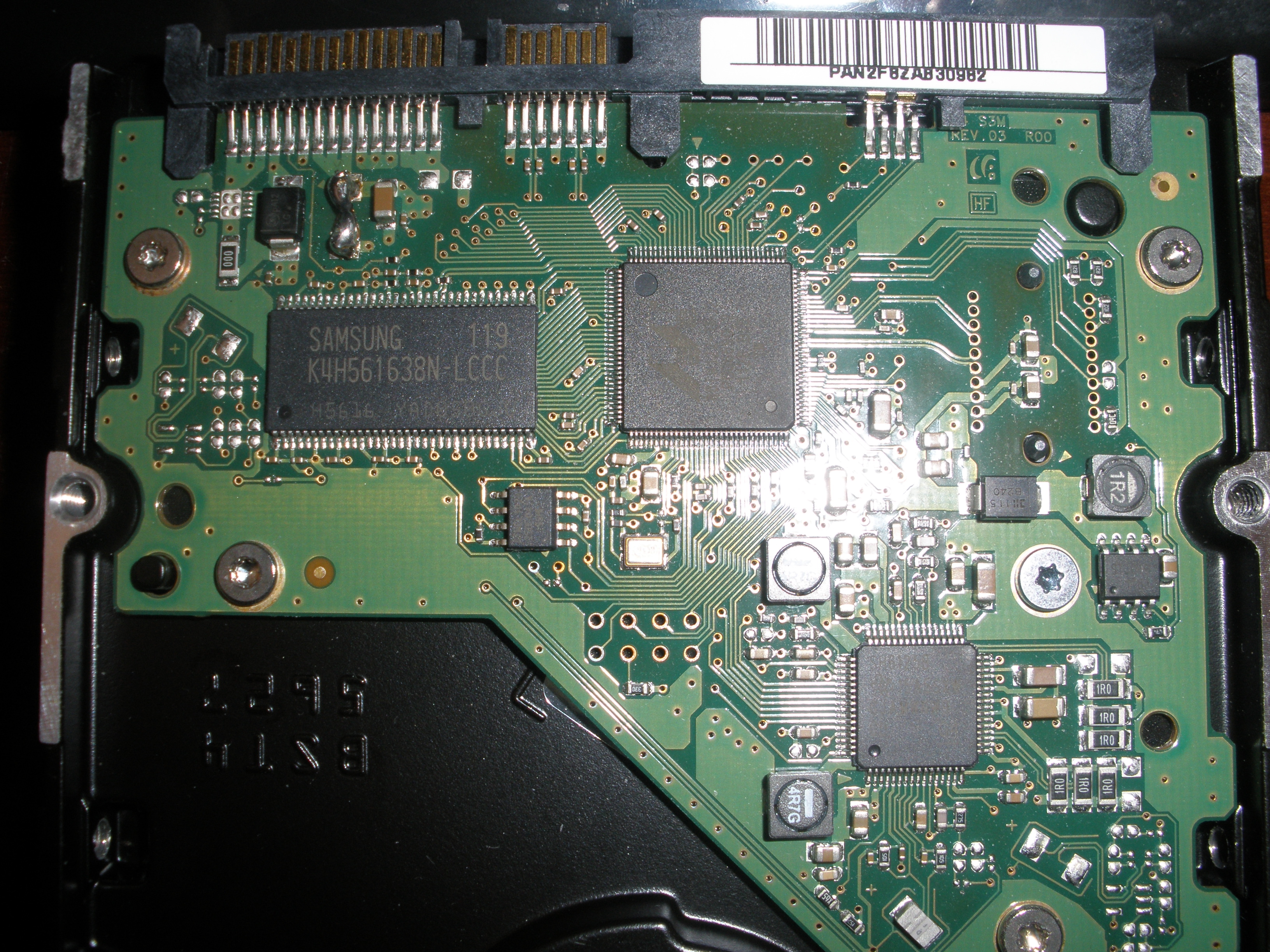

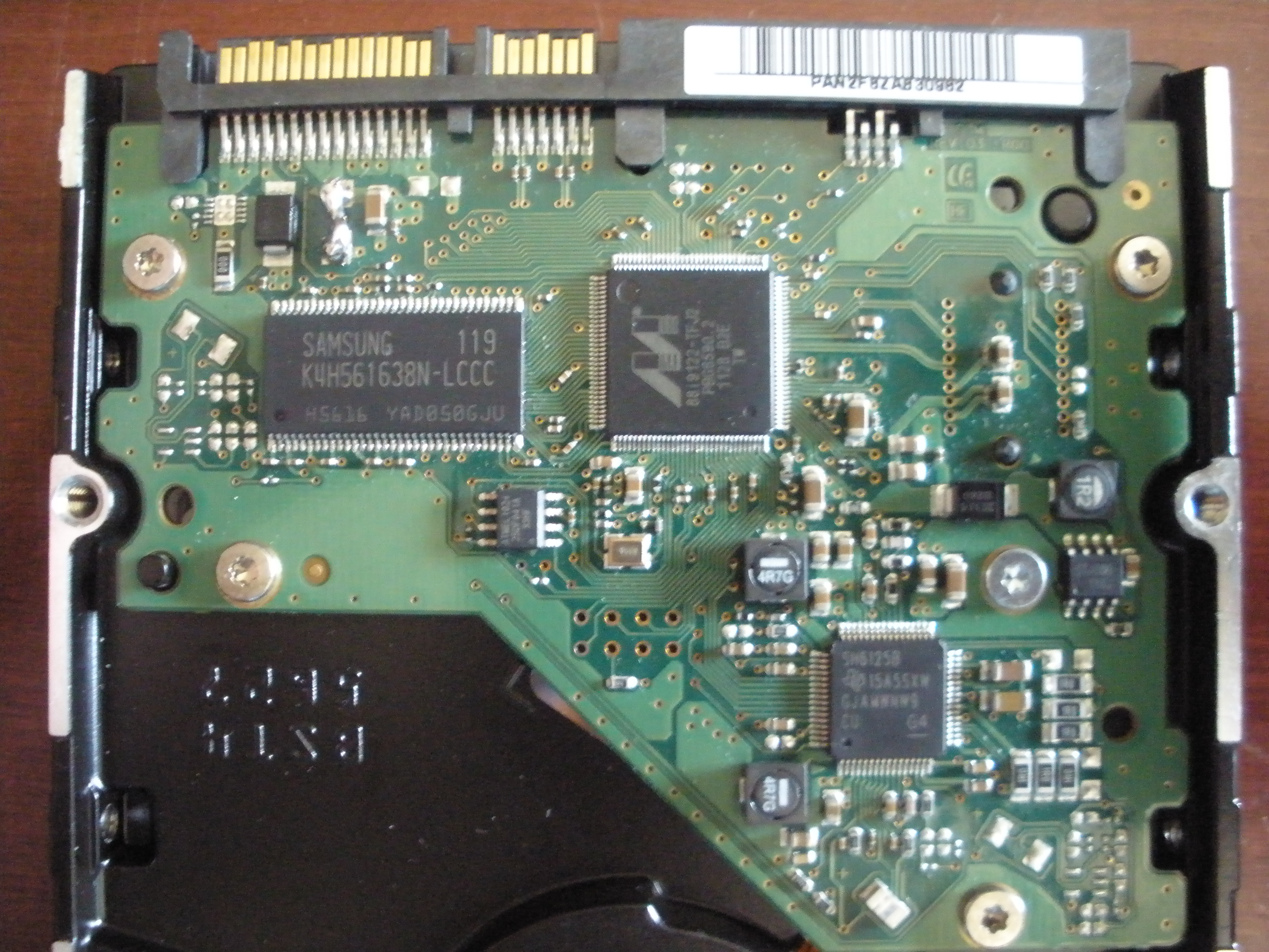

If anyone could indicate me the flash chip with the firmware from this patient PCB i will try to put in the donor PCB. The 8-pins chip of the left it's a ATMEL 1024 250F041A SSHF. The other one (right of the spindle IC) is a STJ009 116J.
Re: Samsung HD204UI PCB BF41-00314A 00
May 16th, 2012, 3:20
madloc wrote:it's a ATMEL 1024 250F041A SSHF

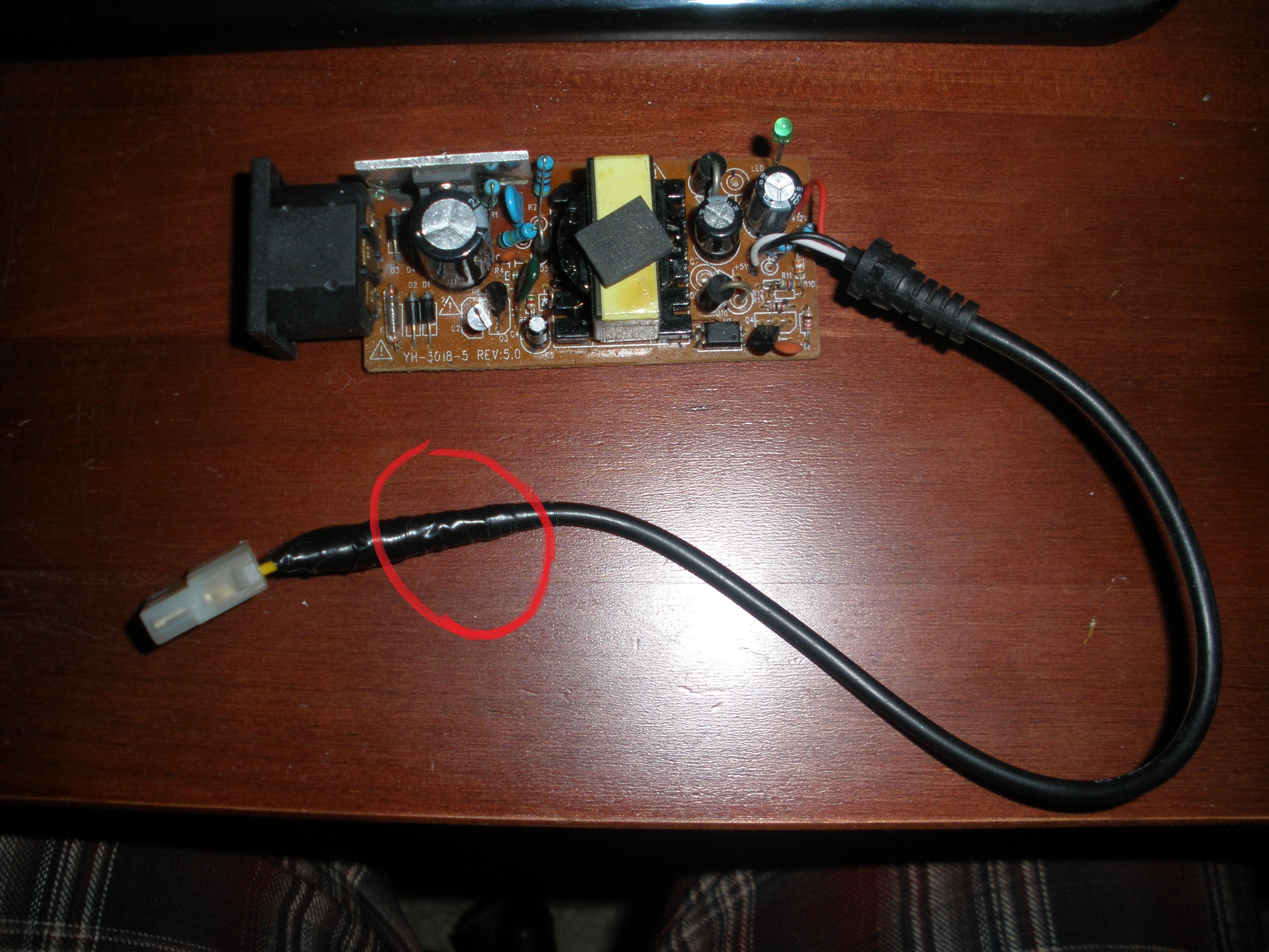

BTW, the reason you removed the diode was because it was shorting the power supply. By replacing the diode with a piece of wire, you replaced a short circuit with another short circuit. Not a very clever thing to do ...
That said, if your power supply was well behaved, then it should have shut down gracefully. Can you tell us what brand it was?

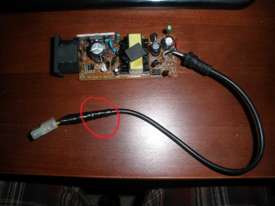

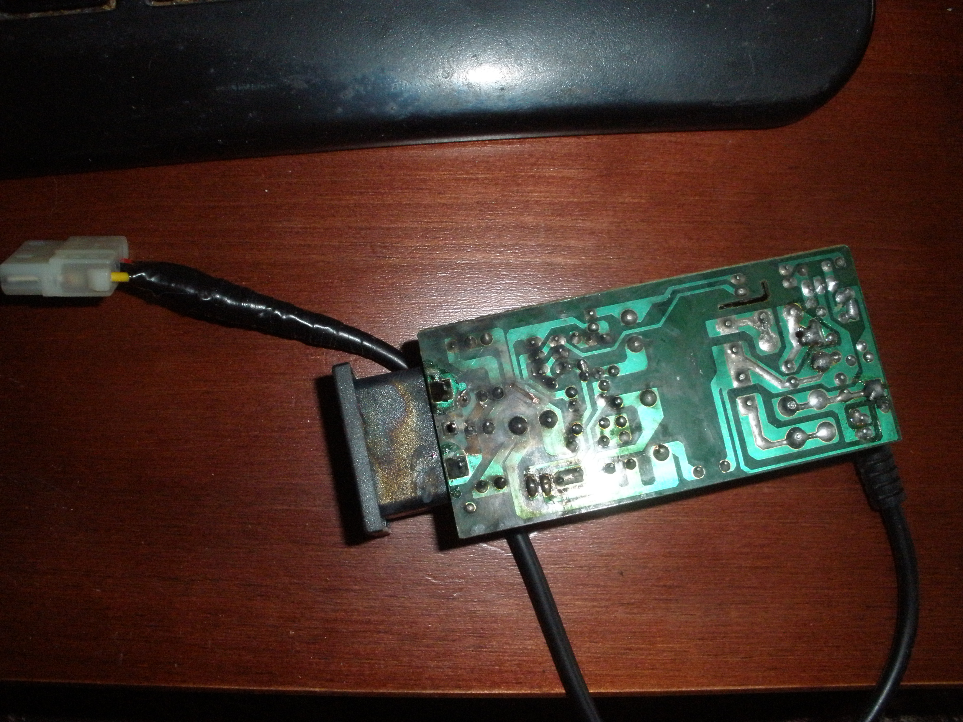

fzabkar this is the power supply:

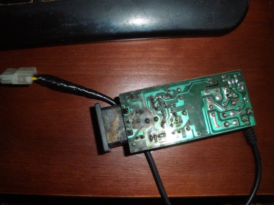

The problem was in the wires (red marked), was crossed and have 12v where 5v and 5v where 12v. Before wired the diode i have repaired the power supply (i was using it with other HDD and no problems at all). Then i plugged the broken HDD with the wired TVS diode and the power supply blows up:
This is all the stuff (with the wired diode removed):
And finally this is the letter i wrote to the website where i purchased the PCB:
N.º de recibo: 4866-6845-1257-4043
Id. de factura:1606
Hello:
The PCB you send me is broken. I have two HDD HD2040UI both with BF41-00314A, one is the broken and the other is ok. With the PCB of the ok HDD, my broken HDD spins, with your PCB the broken HDD does not spin. To be sure also i have tried your PCB on my ok HDD and DOES NOT SPIN neither.
The PCB of yours is visible used and it looks like you sold it to me with the VCM Controller broken. I want a WORKING PCB BF41-00314A fabricated on 2011/09 in any other case i want my money back.
I'll be wating for your news.
P.D: I have attached a photo.

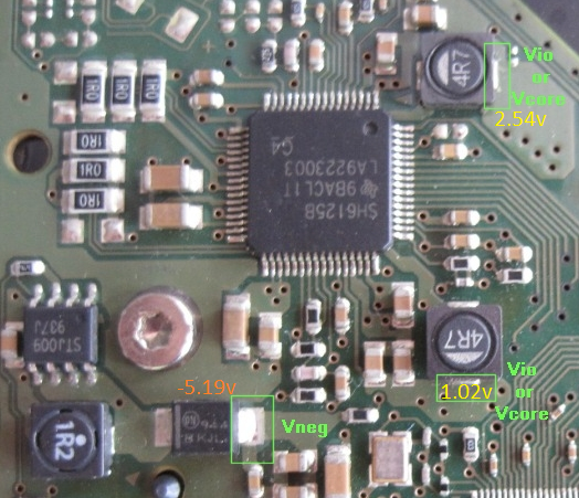

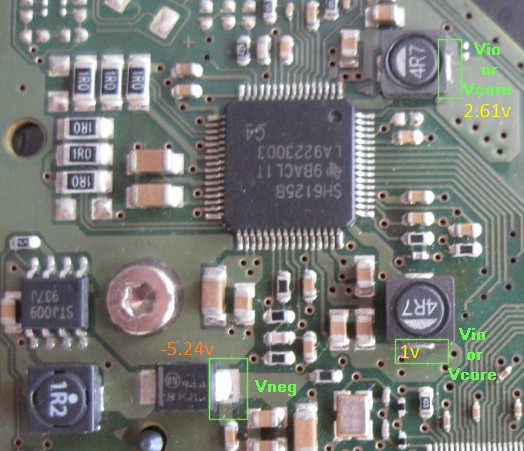

If you can operate a multimeter, measure the three voltages in the photo clip:
http://www.users.on.net/~fzabkar/HDD/HD103SJ_regs.jpg
You can disconnect the PCB from the drive when doing this. Measure all three boards. Use SATA ground as the common terminal.

All I want to do is to narrow down the problem. If these voltages are absent from the purchased PCB, then it will be proof that it is dead. If the Vio supply is absent or shorted, then that will cast doubts on the survival of the flash memory. In any case, measuring the supply voltages is one of the first and easiest things to do when troubleshooting a microprocessor based board. I suggested removing it from the drive to prevent any damage to the HDA if the OP were to slip with the probes.

Sorry, i didn't see your response before. Thank you very much fzabkar. I'm going to do it right now. I'll try to measure with 20v dc
May 22nd, 2012, 13:21

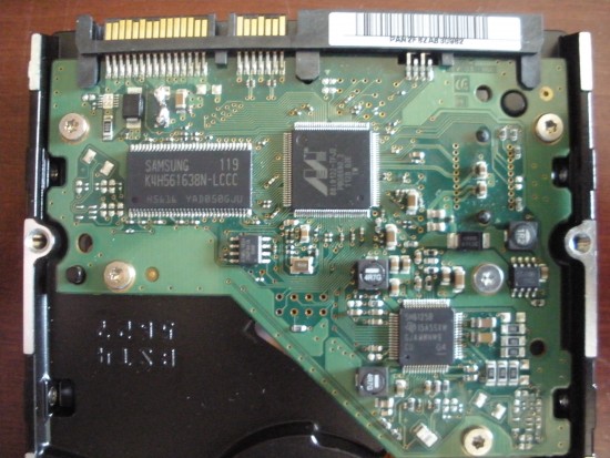

In the PCB of my broken HDD:
In the PCB of my good HDD:
AND in the PCB i bought..... 0v!!!! in the three components!
May 23rd, 2012, 18:35
The PCB that you bought is faulty.
Measure the voltage at each of the two TVS diodes (the striped end).
