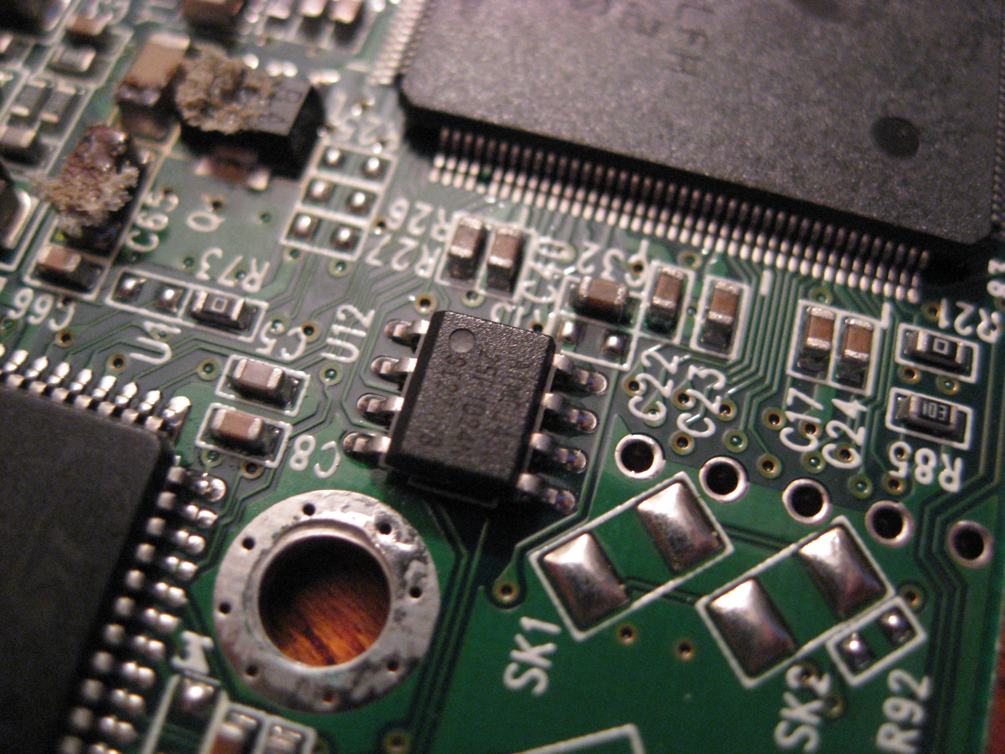

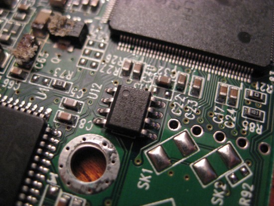

 Post subject: Re: cWD400 Reovery
PostPosted: June 7th, 2012, 19:46
Joined: May 22nd, 2012, 10:11
Posts: 15
Location: New York
Do you mean that 'U12' 8-pin chip?
It looks like it is soldered on to the surface of the board and the pins do NOT go through the board.
Am I supposed to remove that chip from my old board and install it on the new one?
PostPosted: June 7th, 2012, 20:53
That is the chip and it has to be moved to the working PCB.
Make sure you or whoever is comfortable soldering it.

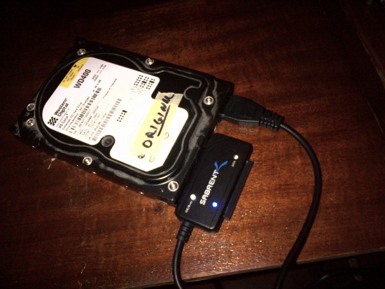

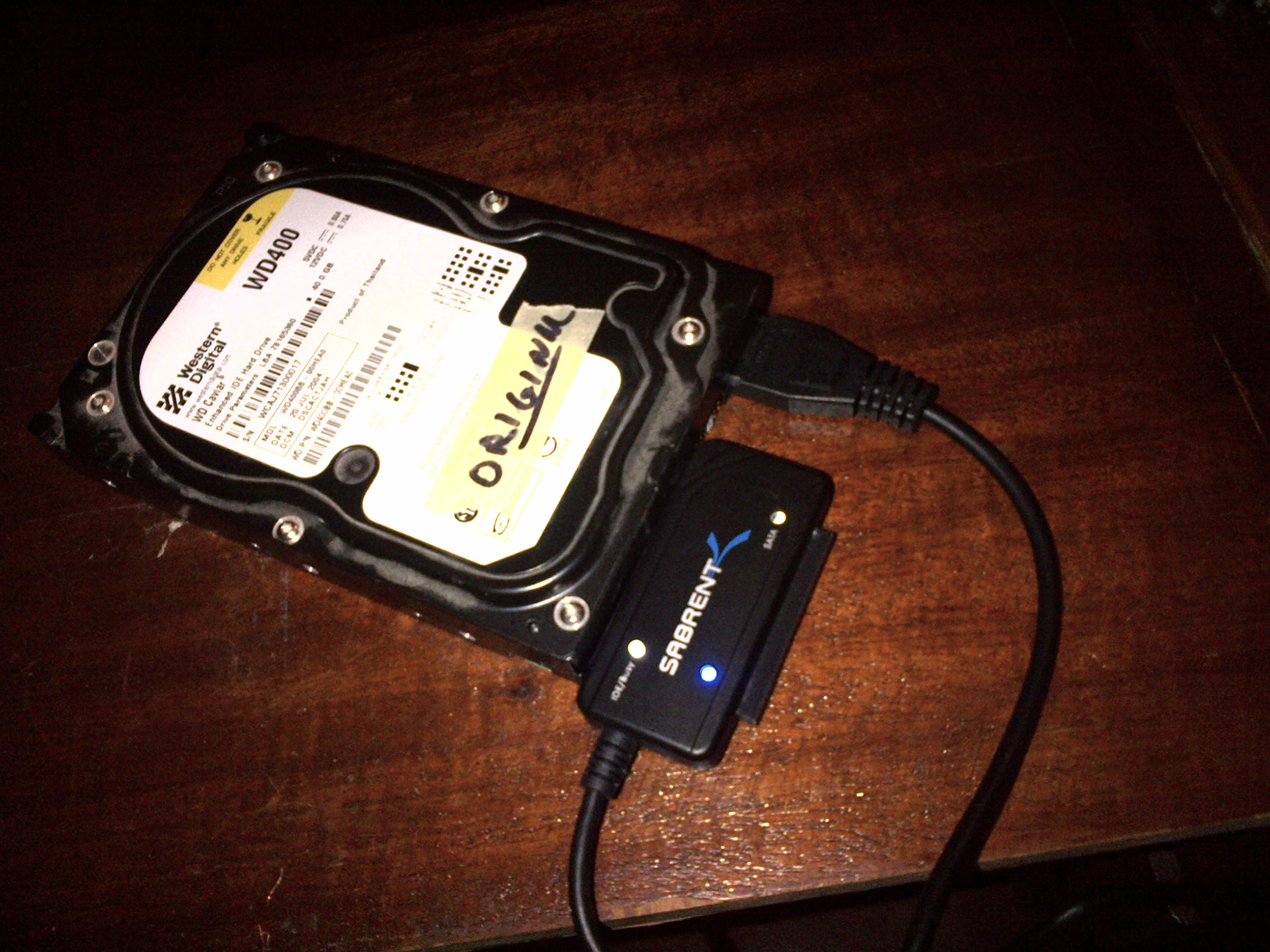

UPDATE
I picked up
1. A 15W soldering iron at Radio Shack. Too big for that pcb...clumsy but usable.
2. .032" rosin core solder. Useless...way too big
3. Desoldering braid. Also useless....way too big.
With a magnifying visor to see the connections, I used the point of a sewing needle (still too big) to pry up the prongs of the chip as I melted the solder.
I was able to tack down the chip into the left over solder on the new board (since I couldn't desolder properly).
I hooked up to a Sabrent Adapter (Tiger Driect) and the drive spun up...no clicks.

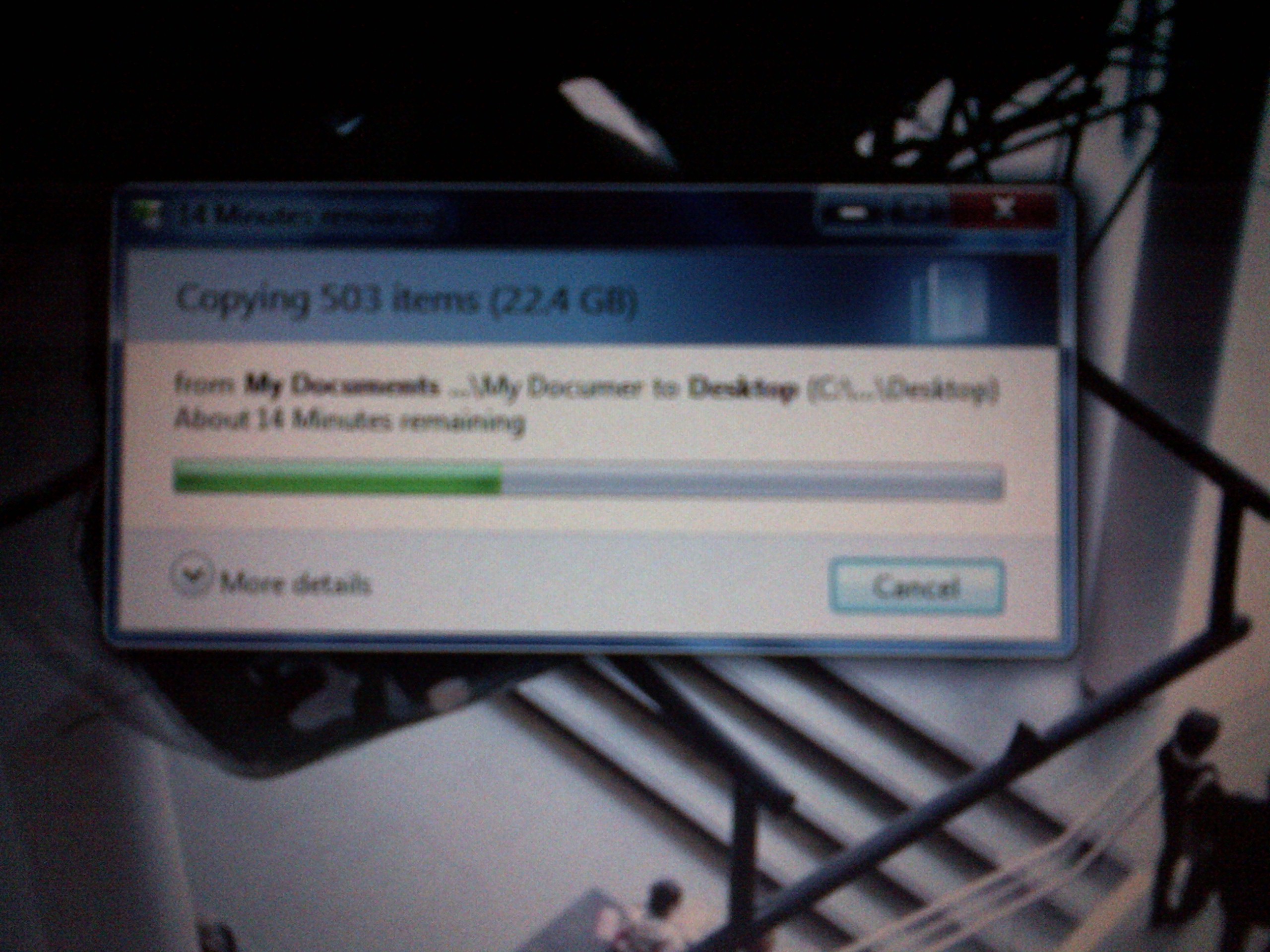

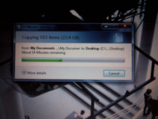

I plugged into the usb of my laptop and after about a minute, the drive popped up! YIPPEE!
I immediately copied all data to the laptop so everything is recovered and safe.
Thank you so much to everyone here who took the time, with great patience, to guide me through this.
