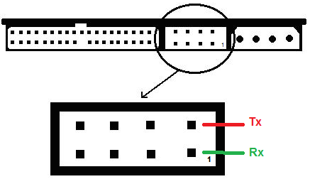

Also, I've finally gotten that Seagate drive back in the office yesterday. Have loaded it up to remind myself exactly of the symptoms it is now exhibiting: Power is applied, it spins up, showing BSY on the ATA registers. I hear a faint tick, and then hear nothing more (the drive remains spinning and busy).
My PC3K Portable lacks a terminal connector for this model (and also seems to lack most ACE models in its database, including this one unfortunately), however I have a TTL serial connector I made some time back with Rx, Tx and Gnd pins. I have 8 pins on this PCB so need to work out if it is possible to connect this way, and to then use PuTTy over the COM port to monitor the Terminal at startup.
Can anyone advise the correct Tx, Rx and Gnd pins for this board? Any/all help greatly appreciated. I'll post the Terminal log up for your interest too, as I work on the drive. Thanks guys.

PostPosted: November 15th, 2012, 4:47
Posts: 3550

northwind wrote:
Thanks for that. After you posted it I've realised I couldn't see the forest for the trees, that was a simple forum or Google search. I appreciate the time for answering such a relatively simple question when I should have known better! Will come back soon with terminal output for anyone following along. Thanks again nw :)

Here we go. Powered up the drive with the TTL interface connected at 9600 baud:
F>Interface task reset
1024k x 16 buffer detected
ALPINE - 1_Disk    M-21  11-25-03 18:53
Head Mask FFFF - Switch to full int.
              Spin Ready
Error Reading Reserve Track Defect List
Platters may have been damaged from the heat after all. Hmm

northwind wrote:
Hm, I've gotten differing advice from Ace Labs for this drive's pin outs:
Previous configuration caused damage to one of my spare PCBs here, so I've been cautious about retrying. Am preparing to test the drive again now with this information. Posting here in case it helps someone else too.
