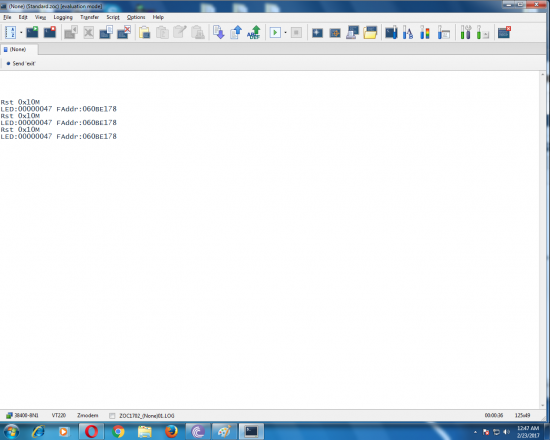

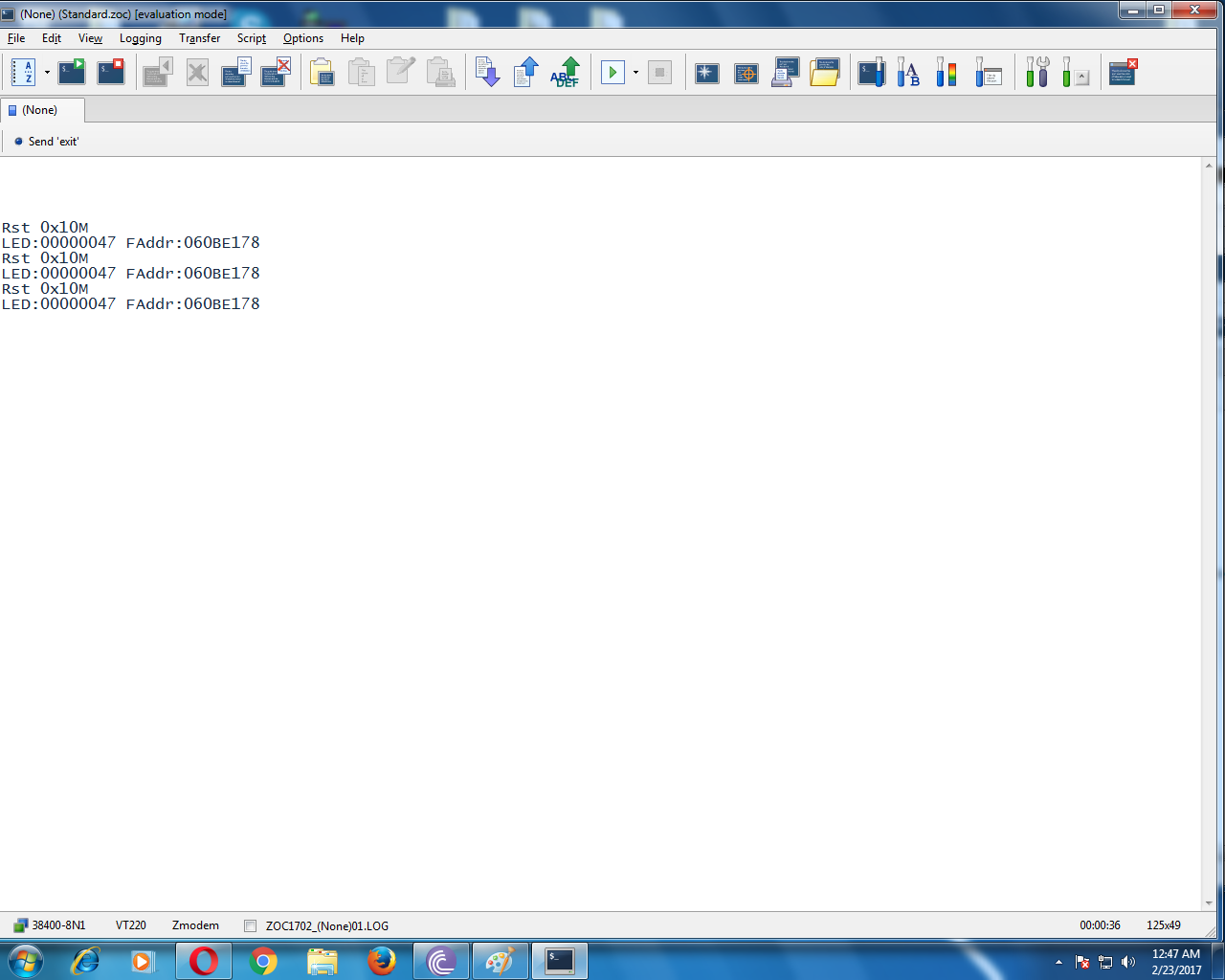

 Post subject: Re: ST2000DM001 BSY
PostPosted: February 23rd, 2017, 4:52
Joined: February 22nd, 2017, 18:48
Location: Paracin
I don't have any important information on it,I buy this hdd because I want to unlock it and sell,I have ttl adapter and when I connect this hdd on it and start terminal hdd send me this message.And when I run script hdd send me "COMMUNICATION PROBLEM.SCRIPT STOP
LED:00000047 FAddr:060BE178
Rst 0x10M
Rst 0x10M "
PostPosted: February 23rd, 2017, 18:33
Posts: 713
Location: Brazil
It is a Seagate, DM Series, and has already presented problems.
Just dump it, or sell as defective/for parts. Any "cosmetic" thing done to it would be just a scam.

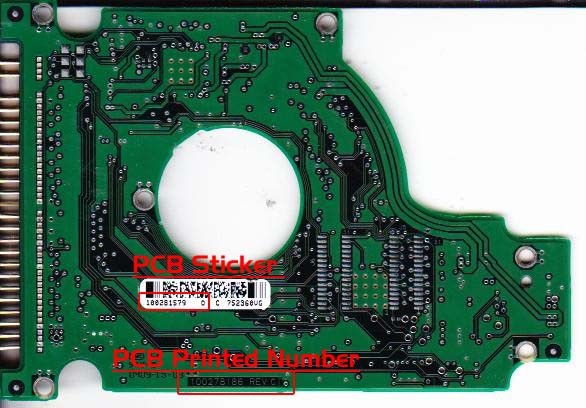

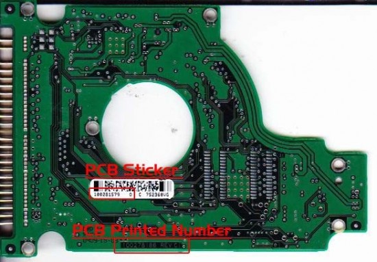

Location: Paracin
Where I have to jump on this board?
This is seagate momentus 7200 fde.2 :(
