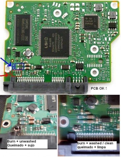

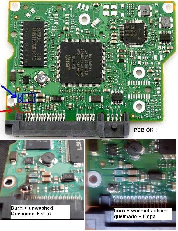

Remove the 12V TVS diode. It will be shorted.
Good morning !
I thought the forum was warning that someone has replied to the topic , but I have not received my email, but I entered the topic to give answers :-)
Thank you Lord for answering FZABKAR .
Really need to know the name of the components to exchange :
See the letter and the color in the new photo I posted .
A - ( Red ) what is the name of the 3 components ( burnt) that appear just after 12 volts ? Resistor ? Diode ? Capacitor ? What is the extent / numbering of these components for me to buy ? You said inductor ( coil ? Spiral ? ) Inductor has so far ? what extent ?
B - (Blue ) What is the name of the 2 components ? It is written " 2R00 " them! Diode ? resistor ? capacitor? What extent ? You have not ordered to change , but I believe they also burned .
12V TVS diode 'll change . Thank you ! ! ! diode actually cracked ( crack , fissure )
I really need to replace diode tvs 5v ? ?
I need details of parts to buy and trade .
eh my soldering large ( robust ) , do not work with precision . I'll ask a friend who works with SMD soldering . That is SMD soldering ? ?
BRAZIL - MG - BH
Bom dia !
Pensei que o forum avisava que alguem respondeu o topico , mas eu nao recebi email , mas eu entrei no topico para conferir respostas :-)
Obrigado Senhor FZABKAR por responder .
Realmente preciso saber nome dos componentes para trocar :
Veja a letra e a cor na nova foto que eu postei .
A - ( Vermelho ) qual o nome dos 3 componentes ( queimados ) que aparecem logo apos 12 volts ? Resistor ? Diodo ? Capacitor ? Qual a medida / numeracao desses componentes para eu comprar ? Você disse indutor ( bobina ? espiral ? ) indutor tem medida ? qual medida ?
B - ( azul ) Qual o nome dos 2 componentes ? Está escrito "2R00" neles ! Diodo ? resistor ? capacitor ? Qual medida ? Você não mandou trocar , mas acredito que eles tambem queimaram .
Vou trocar diodo 12V TVS . Obrigado ! ! ! diodo realmente trincado ( rachadura , fissura )
preciso mesmo trocar diodo 5v tvs ????
Preciso de detalhes das peças para comprar e trocar .
minha solda eh grande ( robusta ) , nao faço trabalho com precisao . vou pedir um amigo que trabalha com solda smd . isso é solda SMD ???
BR-MG-BH
