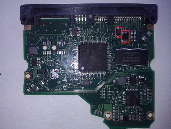

sorry everyone for the confusion and inaccuracy of my posts.. I can say now that i have a better idea of what is happening.
at a last ditch effort, and for the fun of it, i have opened the drive and verified the spindle was froze up. I very carefully freed it up, and as best as i could kept it clean in there using a little eyedropper tool to blow away anything that landed on the platters. I know the consequences of this but as i said, last ditch effort and for fun ;)
Now that i have freed the spindle, plugged the drive back in and started up the computer, i can hear that the original sound is still present. Also the spindle does not spin up. I can now more accurately describe the sound, to me it sounds like an old floppy drive. keep in mind the sound is not constant, it as at about 5 second intervals.
If this is possibly a tvs issue i will attempt to remove the bad chip, if it is recommended.
And btw, SAJunky is correct, after letting the computer sit for a bit it will continue to the BIOS.

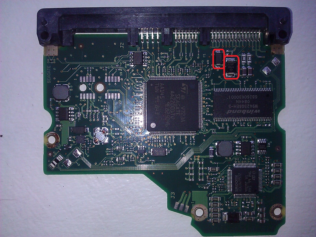

here is a pic of the PCB. please point me to the TVS chips.. i circled what i believe they are

Unfortunately there are too many changes & inconsistencies in the story for me to want to spend too much time on this (as it could be a lengthy waste of time), but here is the best guess I can make out of various parts of the info and some guesswork to fill-in the missing pieces - all IMHO of course:
- Drive was originally external and likely dropped before you got it (due to what you explain later).
- Your original comment about the drive spinning-up was a mistake, as evidenced by you later finding the spindle jammed (which fits with the drive having been dropped); the spindle can't be jammed and spinning-up, so one part of the original story must be wrong and I'm guessing it was the comment about the drive spinning-up.
- Despite you trying to free the spindle, you say the drive is still not spinning-up, but you're hearing it attempt to spin-up every 5s.
Therefore your chances of DIY success appear to be near zero - but as you say, this is just for fun. It seems that your freeing of the spindle was not successful enough, but you don't have the tools and practice to use more advanced approaches. :(

Thank you for the replies. I do know it's not spinning when powered on. I performed the twisting method again while it was powered on and can hear the spindle move back and forth. I have a stethescope but don't think it's worth getting out as I can hear it isn't spinning. There is no vibration at all either.
I read someone with the same drive and same problem describe the sound as a beep, which they said Seagate described this beep as the drive being underpowered. I am using a Molex to SATA adapter if that matters.
Thank you for everyone's time and I do understand I have confused most of you.

Alright, if it is not spinning, then there is a very high change that the PCB has gotten damaged.
This could make sense, as sending continuous power to a seized spindle drive could damage the electronics.
So, if there is a start to get this drive to work, then it is ruling out if there is a PCB issue.
Looking ahead: assuming the PCB is damaged, if the PCB is damaged beyond repair, then you are looking to invest more money in sourcing a compatible PCB and perform electronics work. If there are additional issues beyond the PCB failure, then the investment would be worthless.
If deciding to address the PCB, you will have to read and practice on how to test components on the PCBs using various tools and techniques, soldering, what components to solder, etc. There are several threads containing a lot of information on this forum pertaining to this subject.

Spinup problem would be seen immediately from diagnostic monitor. I admit, testing voltage with multimeter would also pin-point this kind of cause. Only if remote instructions would work, which I doubt. Now you have more experience, but unreliable drive (after opening). It is why everyone in my opinion should start from diagnostic monitor.
