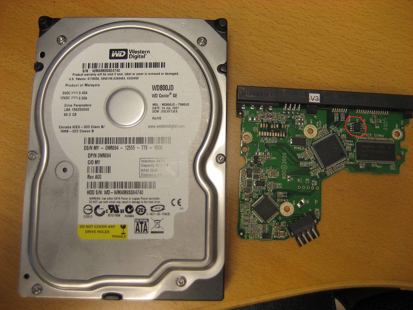

homeschool74 wrote:
! I have a WD Hard drive that will not do anything. When I plug it up nothing happens. The motor is not spinning.
homeschool74 wrote:
It turns out that with the old PCB the drive would turn on. It clicks. It sounds like the head is seeking on the platter. Both PCB's make the same sound.
Vulcan wrote:
This is a direct contradiction to your initial comment, that "When I plug it up nothing happens. The motor is not spinning."

SAjunky wrote:
The only possible answer is gathering servo frequency by reading heads. In other words you need to move heads to keep it on servo.

I just have a drive before me which appeared to me it was spinning up together with Seagate Click of Death sound, but after swapping PCB I was surprised that spinning sound is slightly different. It turned out to be faulty PCB, drive is working now.
mr_spokk wrote:
Could be Pcb though (@ 1%), rest of the 99% goes to bad head(s).

@homeschool74,
As you have a good Pcb (I assume that the Pcb-number is a match) 2060-701335, you can desolder the 8 pin rom chip (marked in red on my pic) from your old Pcb and resolder it to your good Pcb...if it works then it's great. if not, you need someone with more knowledge to take a look at it.
Cheers
Bosse
[img]
[/img]
