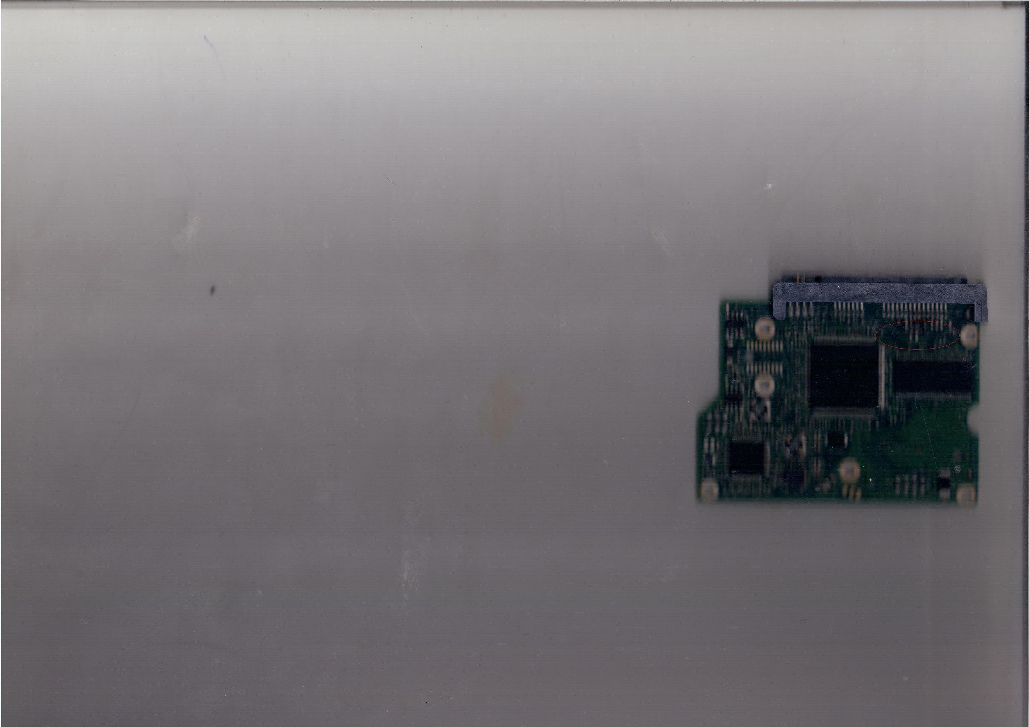

hello fzabkar

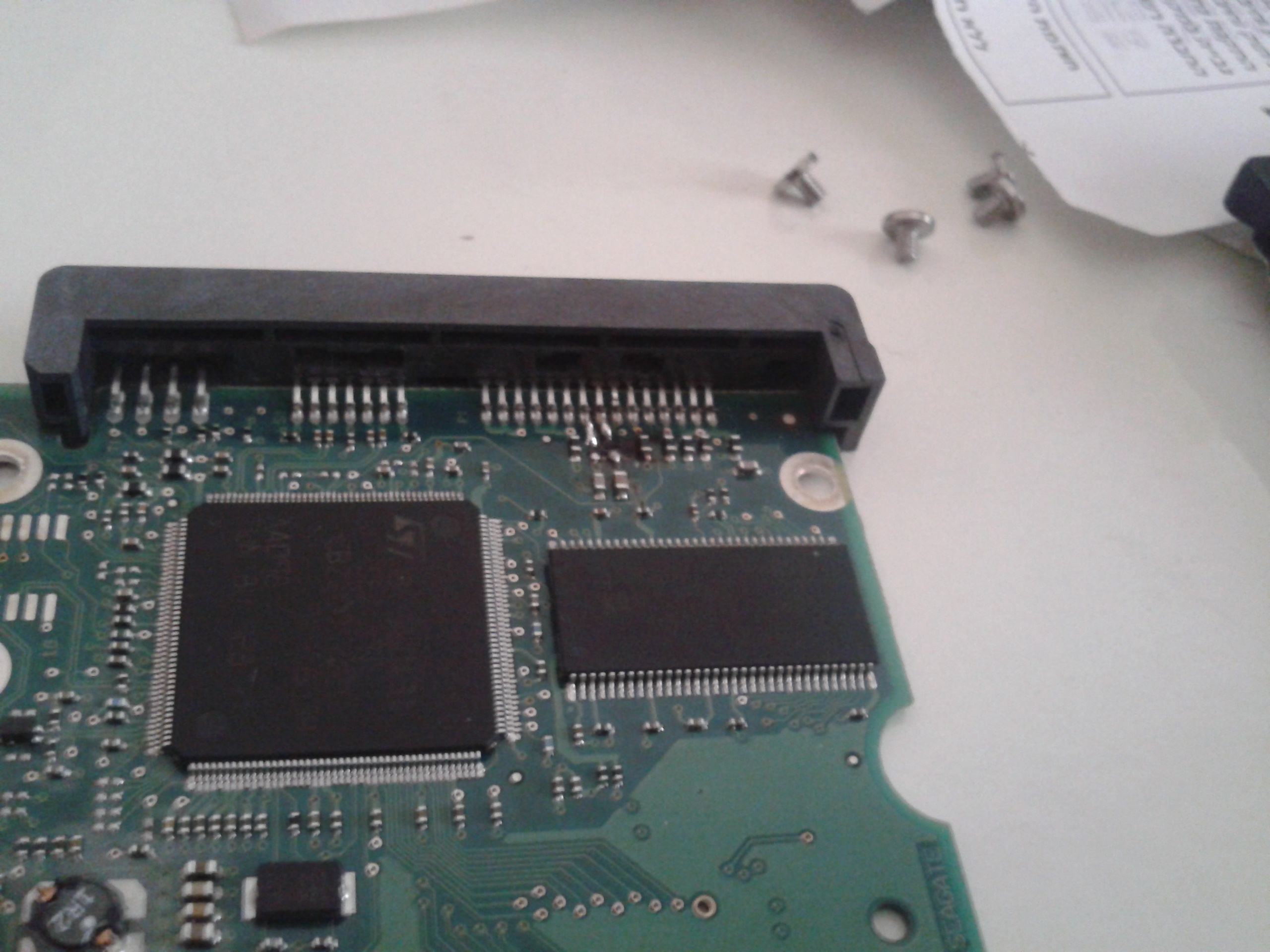

attached pls find a picture of the burnt pcb.
nice that u remember me from last time.
can u help and make your explanation more clear.
tks
ephraim
sorry for the quality of the picture

This is the worst picture i've ever seen
:lol:

pls try to enlarge the picture. you'll see the burnt parts
 Post subject: Re: Seagate Barracuda 7200.12 320GB
PostPosted: August 26th, 2013, 4:08
Posts: 17223

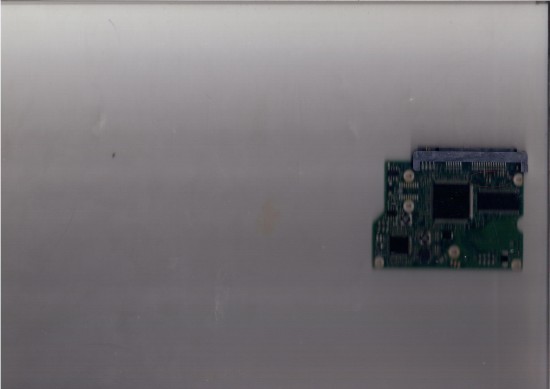

ephraim2, I really do want to help you, but your photo is unusable. :-(
Can you do any better with a flatbed scanner?

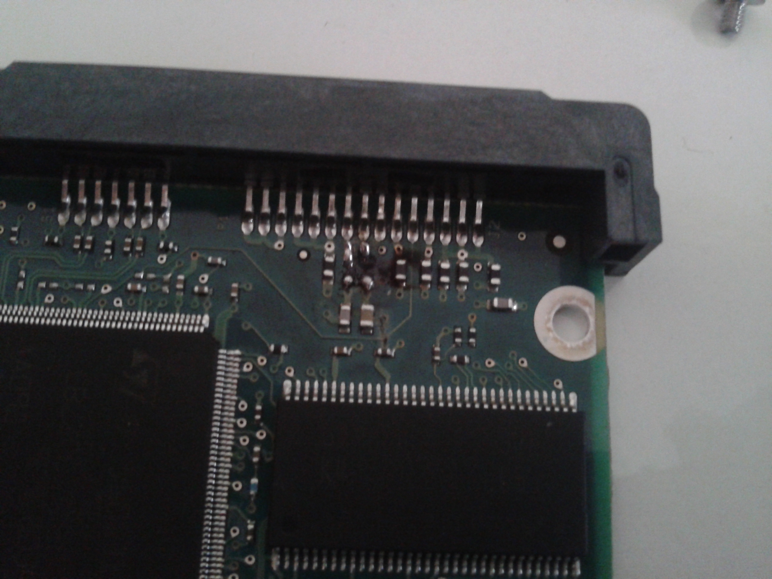

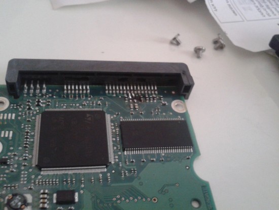

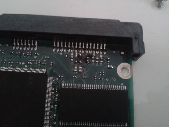

hello friends
attached two new pictures of the a/m hdd.
i am sure u can help
tks and brgds
ephraim

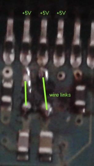

Those are the inductors on the +5V supply. There is a risk that the preamp may be damaged, but you have done hundreds of head swaps, so that shouldn't concern you.
The first thing to do is to remove the shorted 5V TVS diode. I recommend flush cutters for this purpose, or you could use a soldering iron if you prefer.
http://www.users.on.net/~fzabkar/HDD/ST ... 5V_TVS.jpg
My TVS diode FAQ lists suitable replacement diodes and sources.
The next step is to replace the burnt inductors with wire links.
http://www.users.on.net/~fzabkar/HDD/ST ... uctors.jpg
I suggest you use the end of a resistor leg. Bend the leg, tack solder it in place, then trim it to length.
I recommend that you backup the contents of the serial EEPROM before doing anything. I also recommend that you recheck your PCB for short circuits before powering it up again.
That said, if the only problem is the diode and the inductors, then the two wire links should be all you need to do.
Good luck.

fzabkar are u sure those are inductors?
I thought they were fuse!
However he can use the end of a resistor leg or wire wrap as this:
http://www.ebay.it/itm/Unistrand-24AWG- ... 43bcf609fd
I prefer wire wrap because they are thinner and therefore more manageable
Fuses are designed to fuse, not to burn up. In any case you would only need 1 fuse, not 2.
