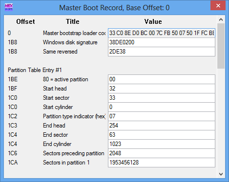

Just for info:
DTI did a tutorial that might be worth you looking at:
http://www.dtidata.com/resourcecenter/2 ... ion-drive/
Here is a winhex MBR template of my My Book Essential 1Tb
MBR - Winhex.png (12.52 KiB) Viewed 17729 times
Here is sector 0 (unzip & then use winhex to view)
Sector 0.zip
(498 Bytes) Downloaded 837 times
Loki
Re: WD My book recovery
November 24th, 2012, 19:05
@BlueMooneke, since you intend to clone your drive, your solution may now be a little easier. My original approach involved manually editing sector 0 so that we could easily undo any changes. That's why I initially objected to your suggestion to "insert the partition (undelete)". Ironically I did so because, like you, I was reticent to allow DMDE to make automatic changes to your data.
Now that you will have a clone, I would suggest that you manually fill sector 0 with zeros, write "55 AA" to the last two bytes, and then allow DMDE to "insert the partition (undelete)". Hopefully this will be all that you will need to do.
As for how one uses the boot sector to reconstruct the partition table, I suggest you read this page:
An Examination of the NTFS Volume Boot Record Of MS Win2K and Windows XP:
http://thestarman.pcministry.com/asm/mbr/NTFSBR.htm
Your boot record has the following information:
File System - NTFS
Sector Size (in bytes) - 0x0200 (= 512)
Sectors per Track - 0x003F (= 63)
Number of Heads - 0x00FF (= 255)
Number of "Hidden Sectors" - 0x00000800 (= 2048)
Total Sectors - 0x745B6FFF
This is telling us that the partition begins at sector 2048 and that it has a size of 0x745B7000 (= 0x745B6FFF + 1).
The partition ID byte for an NTFS volume is 0x07.
List of partition identifiers for PCs:
http://www.win.tue.nl/~aeb/partitions/p ... pes-1.html
The following resource explains the meaning of each byte in the partition table. It also explains how to encode/decode the starting and ending CHS values.
MBR/EBR Partition Tables:
http://thestarman.pcministry.com/asm/mbr/PartTables.htm
