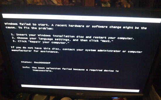

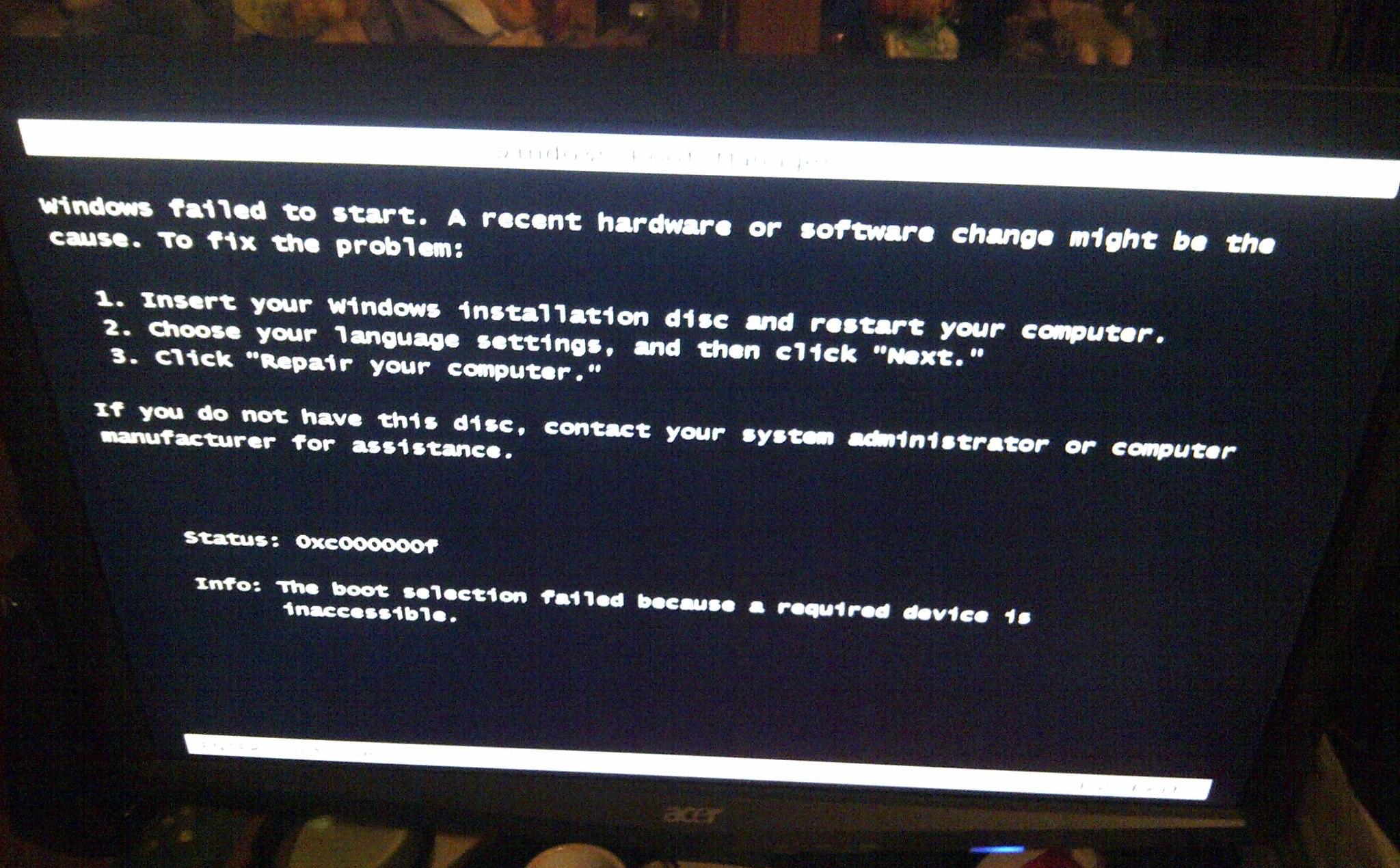

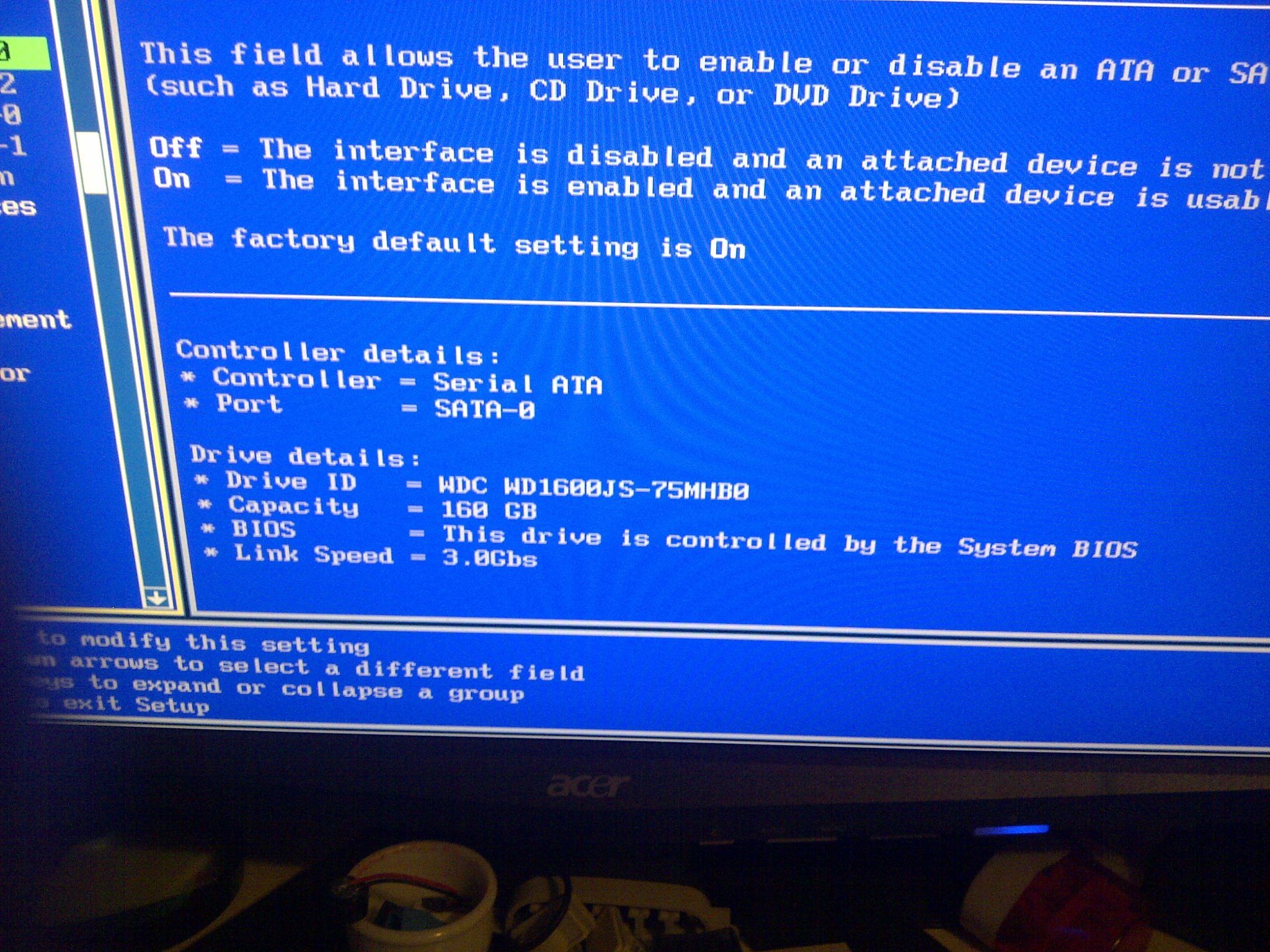

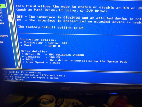

Hello, thanks for all the help i'm slowly making progress,
now after messing around with cleaning the pcb board the bios now recognizes it, however it will not boot up I get a windows boot error message, I also tried seeing if it would be recognized while another hard drive was running
i attached pictures what should I do next
thanks

if your drive is detecting properly in the BIOS as show,your first step will be to make an image/clone of this drive and run a good data recovery tool(r-studio) on the cloned drive to get your data.
Clone the drive immediately, but stop the process if the drive starts making clicking noise while accessing the drive or encounters lots of bad sectors.

agree , also i add:
stop if the cloning become slower and slower.

@x2006nzl It is probably too late now to advise you to start cloning immediately.
This might be the one and only time you get to this point before the drive dies on you!

Do not use the drive to check for files as you mentioned.
Clone the drive, before it dies.
Use
http://hddguru.com/software/HDD-Raw-Copy-Tool/
Clone faulty drive to another working drive of larger capacity.
Then run recovery tools like R-studio on the cloned drive(not the original drive)
good luck
