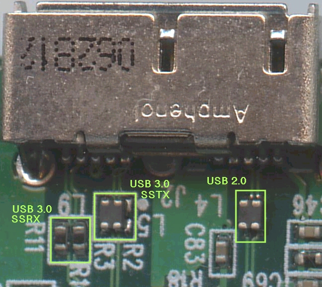

I'm not sure if I understand the situation. Are you saying that when you install the drive in a third party enclosure (not a WD enclosure), your Mac prompts you with "WD Unlock"?
Can you run a tool such as CrystalDiskInfo or HD Sentinel against your drive when installed in the third party enclosure? If this tool can see the drive's SMART data, then this would give us some confidence in the drive's health.
Even better, connect the drive to a SATA port on your Mac's motherboard. This will eliminate the bridge altogether.

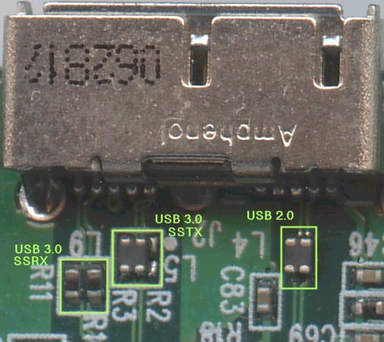

Can you upload detailed photos of the WD bridge board? These boards often have solder problems around the micro-USB connector. If this is the case, then using a USB 2.0 cable rather than USB 3.0 may work. This is because USB 3.0 uses different pins in the connector.
[img width=780 height=430]http://imgur.com/hGjHKUr[/img]
[img width=780 height=430]http://imgur.com/u5fCgEg[/img]
[img width=780 height=430]http://imgur.com/aEYVkk8[/img]
[img width=780 height=430]http://imgur.com/DzMWvAw[/img]

Anyway, ISTM that a replacement bridge board would be worth a try. Yours is based around a Symwave SW6318 bridge IC and has a part number of "4061-705089-001 Rev. AG". That's what I would be looking for, but other Revs might be OK. You'll have to ask the professionals or your PCB supplier. If the PCB is too expensive, then perhaps you could buy a used Essentials drive and ask the owner for the appropriate information.

The actual fault may be a simple one. I would inspect the solder joints at the components in the attached photo (different PCB, similar connector). Otherwise try a USB 2.0 cable.
