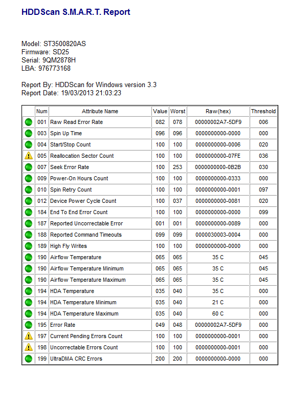

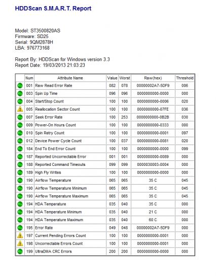

Hi all,
OK, this was a BSY bug. Fixed it and disk is back in the BIOS and Windows/Linux. Didn"t do the G-List
regeneration though (Gradius said it's optional). I also used this: http://www.youtube.com/watch?v=ZBsf-5iiDEE
After booting on Windows, it says it's a FAT32 partition which needs to be fixed. I didn't do it.
Disk is very little used (442 GB free for a total of 465 GB). I copied almost all files. Strange noise, probably
heads clicks. But almost all files are there, but sometimes hangs for the remaining files needed.
Attached is are the smart data which probably confirms that.
As I do not own expensive data backup software and no such big disks, and the disk is so very little used, I there a way
of copying only sectors containing files, according to the FAT (or fixed FAT) because everything else is useless right?
Thanks for your experience.

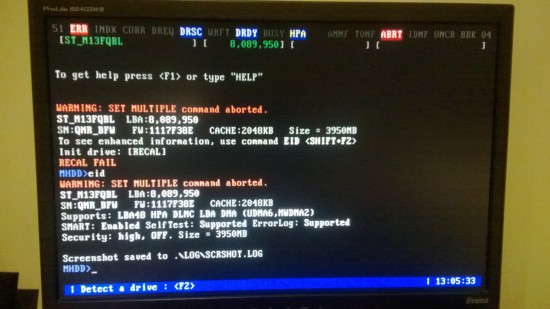

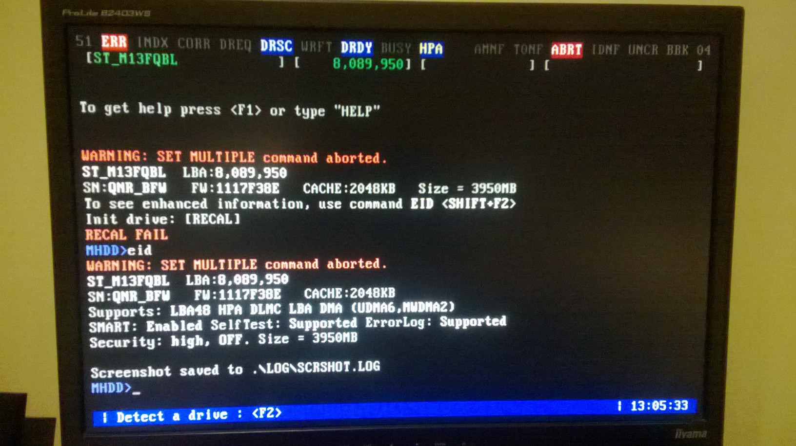

sorry if this is a noob question, but if a disk is clicking on startup, does that rule out the BSY or 0LBA issues? Or is it possible that the BSY is causing the clicking?
I have a 7200.11 Seagate Barracuda from an external Iomega case - disk no longer working. When in the case and powered on, there is a soft clicking. When connected to the mobo via SATA the disk spins up, clicks, then spins down, does not repeat this process (ie just spins up, clicks, and then spins down once), and is not recognised in BIOS. I've booted using SeaTools for DOS and it detects the disk, but it fails all the tests. Is it possible that this is BSY?

MHDD does not look good :(

I'm a noob so if anyone can opine on what that MHDD output suggests I would be most grateful. Thanks
 Post subject: Re: Seagate Barracuda 7200.11 fix procedure
PostPosted: March 24th, 2013, 9:14
Not "BSY bug"
99% certainly gonna be bad heads :-(
