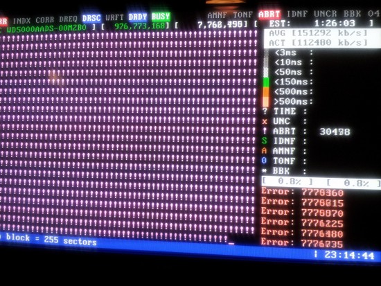

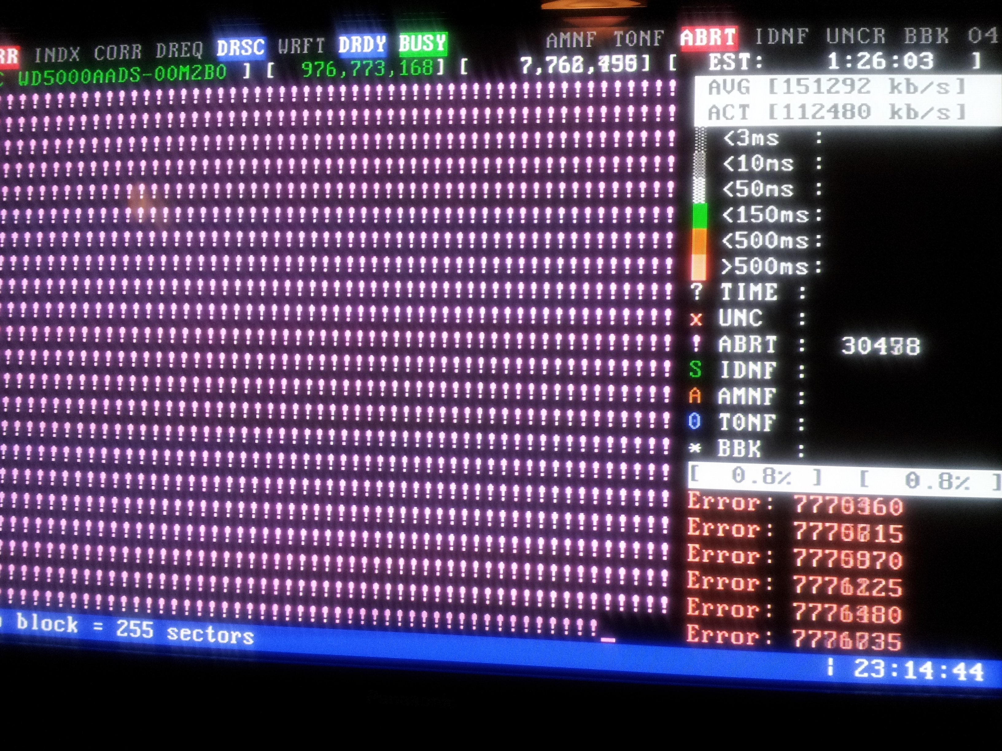

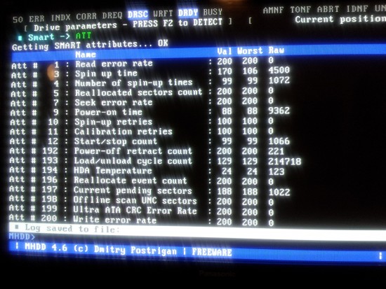

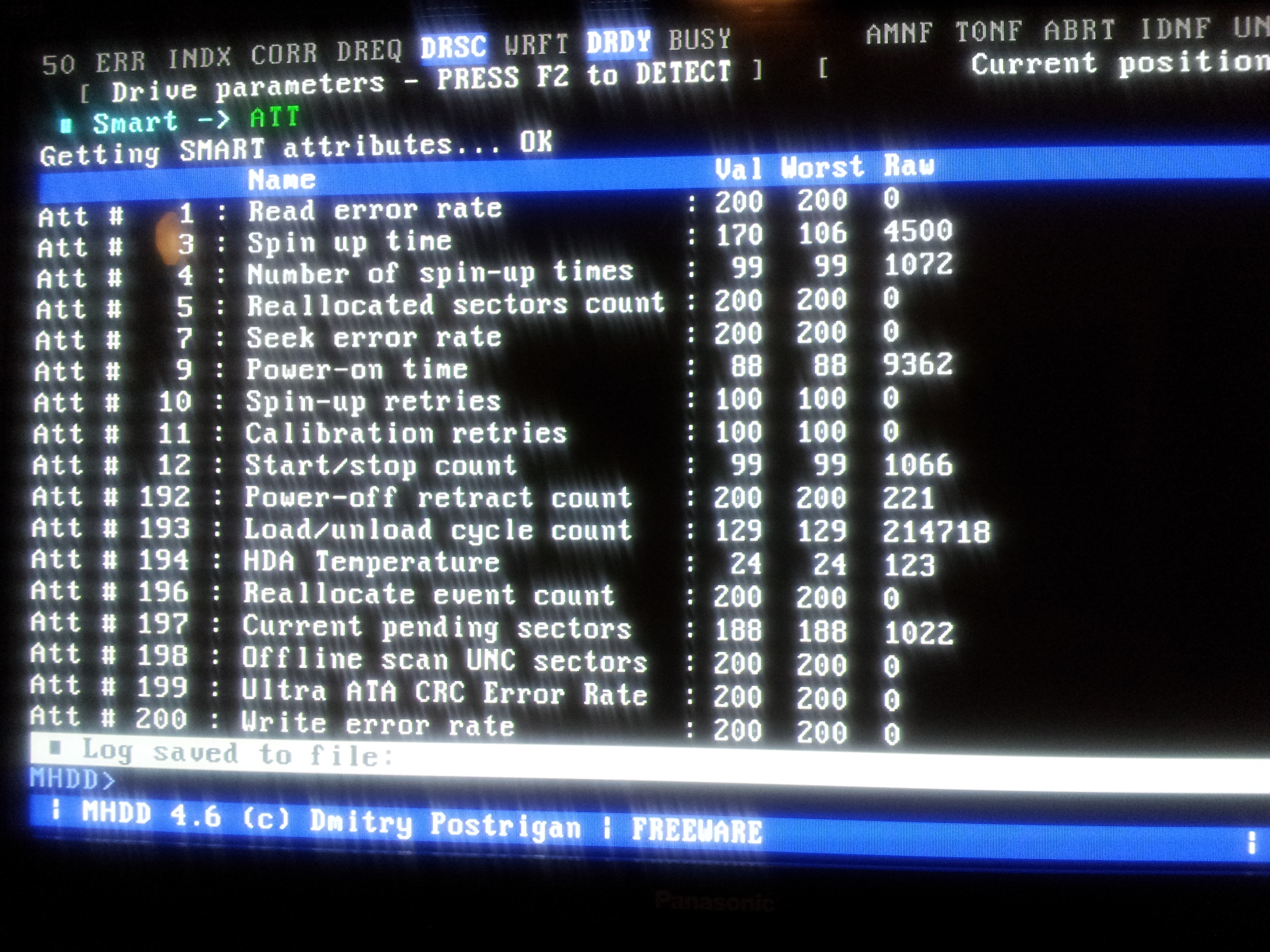

We tried to scan the drive with MHDD, I'm attaching a couple of screenshot.
From what I see, it doesn't look very promising...
The first is a SMART report, the second is an attempt to scan...
What do you think?

 Post subject: Re: WD5000AADS failed
PostPosted: April 3rd, 2013, 8:08
Posts: 811
Location: World
I am not in true but in my experience, I think heads problems too (as we can see now probably PCB problems and FW problems too)
Heads may be degraded
please contact with a local pro.
