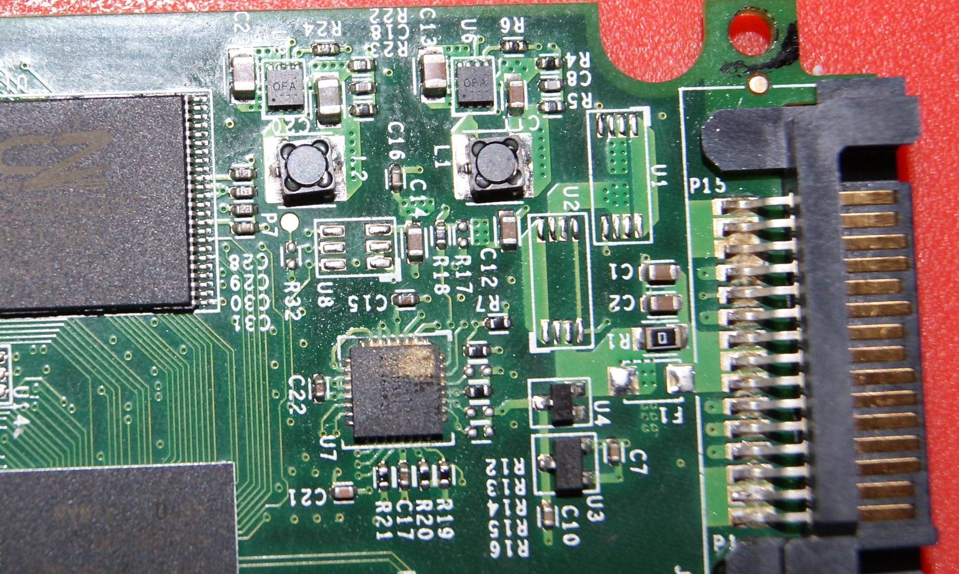

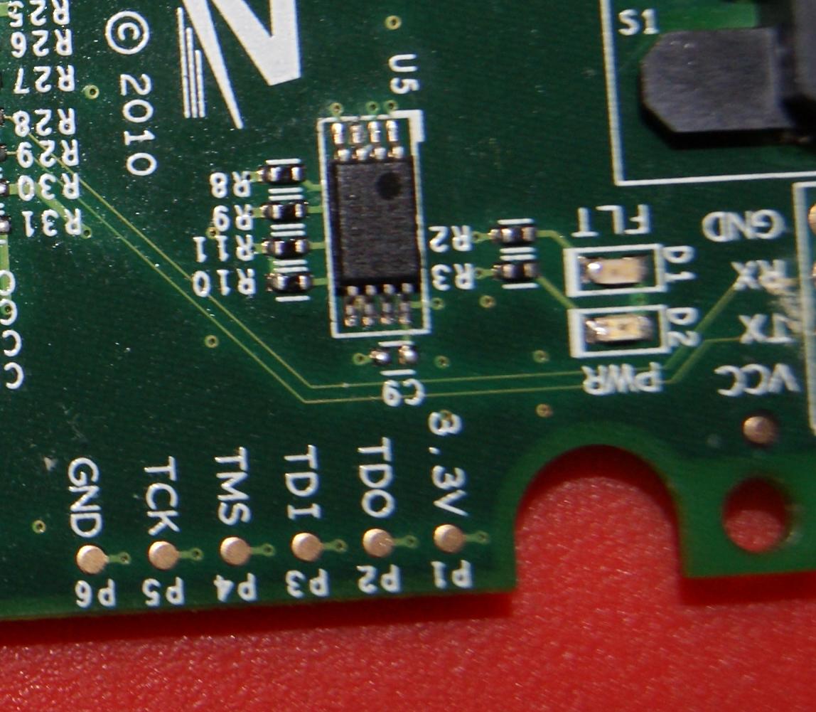

i still testing SSD.
now i can not get output by tx/RX port.
any idea?
thanks

Posts: 17330
If you know how to use a multimeter, I can show you the voltage test points.

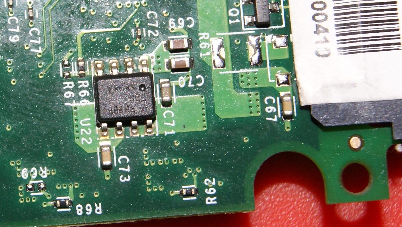

There should be +5V at the F1 solder pad near the SATA power connector.
Check the +3.3V pin at the JTAG connector.
Check the outputs of the coils L1 and L2. The associated circuits look like buck regulators. I believe they will be providing +3.3V and Vcore (1V - 2V).
There is also an IC on the other side (U22) that I can't recognise. It would help a lot if you could zoom up on the affected areas, and provide me with the chip markings.

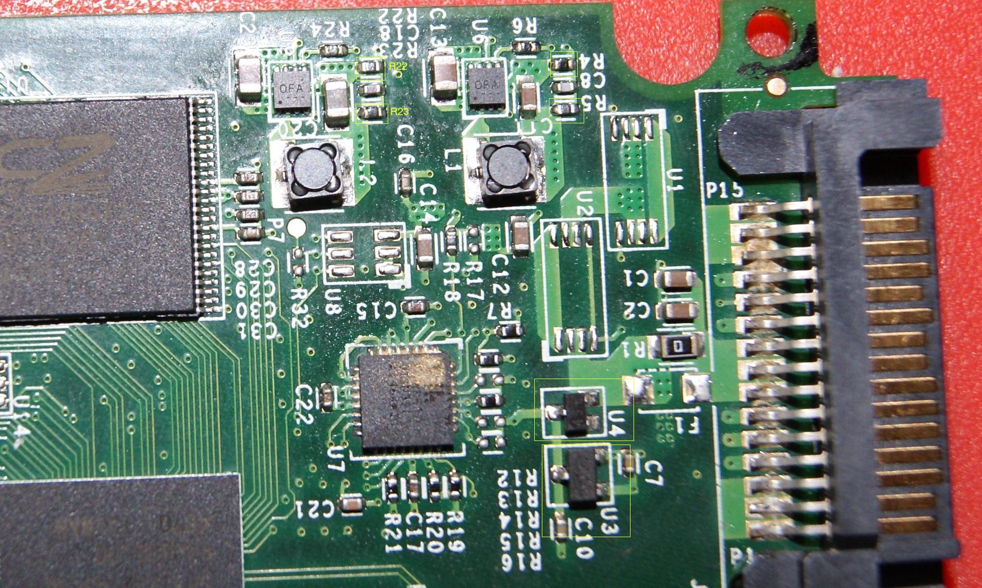

Hi fzabkar
I atach better pics

hi fzabkar,
I suppose that F1 solder pad is the site of a fuse
But this not here
You think must be a fuse?
But this not here
The location for F1 (yes, it is a fuse) has been left vacant because the design allows for R1 or F1 but not both. The only reason I asked you to measure the voltage at that point was that it is more accessible than R1.
Coils L1 and L2, plus their associated "OFA" ICs, constitute two switchmode regulators. The voltages at the coils will be the outputs of the regulators.
TPS62065, Texas Instruments, marking OFA, 3-MHz 2A step down converter:
http://www.ti.com/lit/ds/symlink/tps62065.pdf
I can't make out the markings on the IC at U7, but it appears to be a POWR607. Its function is to monitor and sequence the onboard power supplies and to provide a watchdog timer to reset the controller in the event that the firmware gets stuck in a loop or the controller hangs.
ispPAC-POWR607, Lattice Semiconductor, Programmable Power Supply Supervisor, Reset Generator and Watchdog Timer:
http://www.latticesemi.com/dynamic/view ... t_id=21806
I'm a bit concerned about the "stuff" in the top right corner of the IC. It could be a manufacturing mark (the IC is in-circuit programmable), but I'm not sure.
The IC monitors 6 voltages (at pins 1,2,4,5,6,7), but the circuit is suggesting that there are actually 4 voltages being monitored. I would measure the voltages identified in the attachment.
I can't make out the markings on U22, but the logo looks like it belongs to Fairchild, so it appears to be a power IC of some kind. Could you tell me its markings?

The IC monitors 6 voltages (at pins 1,2,4,5,6,7) ...
Sorry, that pinout is for a different package. The actual voltage monitor pins (VMON) are 2,3,5,6,7 and 10.

Posts: 811
Location: World
But this not here
Thanks fzabkar for your clever advices
I am not in work and i can not see PCB but ill take a characters and report here .
L1=0,97V
L1=2,79V
about other voltages
Fuse pins to ground = 4,9V
JTAG P1 to ground = 3,22V
about the "stuff" i'll verify it but looks like a factory mark (any cain metalik ink) or maybe "tin waste". but not sure i have not the ssd here now tomoorow i'll verify it
correct: The actual voltage monitor pins (VMON) are 2,3,5,6,7 and 10.
i'll test from points to ground

hhddrec wrote:
L1=0,97V
L1=2,79V
I presume the two L1 readings actually refer to L1 and L2. If so, then the 2.79V reading must be the supply for the NAND flash array, and 0.97V must be the Vcore supply for the SandForce controller.
If so, then the JTAG supply must be coming from some other IC, possibly U3 near the SATA power input (or U22).
In any case, 2.79V is too low for the NAND array. My searching suggests that the OCZ M2502128T048AX22 NAND flash parts are rebadged Micron MT29F128G08CFAAAWP chips. These are 3.3V, 128Gb, 16G x 8 parts.
If this measurement is correct, and if my analysis is correct, then the POWR607 chip is probably holding the SF-1222TA3-SBH controller in a reset state.
Can you tell me the markings on U3 and U4?
Could you also measure the resistances of R4, R5, R22, and R23? These will allow us to calculate the correct supply voltages for the "OFA" regulators.
 Post subject: Re: OCZ Vertex 2 240GB SSD for recovery
PostPosted: April 7th, 2013, 17:50
Posts: 17330
If the 2.8V reading is correct, then check each of the NAND flash chips for heating. One or more of them may be pulling the 3.3V supply down. Otherwise there could be a problem in the Vio section of the controller.
PostPosted: April 8th, 2013, 1:09
The problem is in any case elsewhere.
But be real : if one of the flash is broken, if the controller is broken/malfunctioning, and if the circuit is malfunctioning without knowing how it works (and expensive tools) no amount of tinkering will get a a byte out of it. Also, there's encryption to deal with. Good luck.
